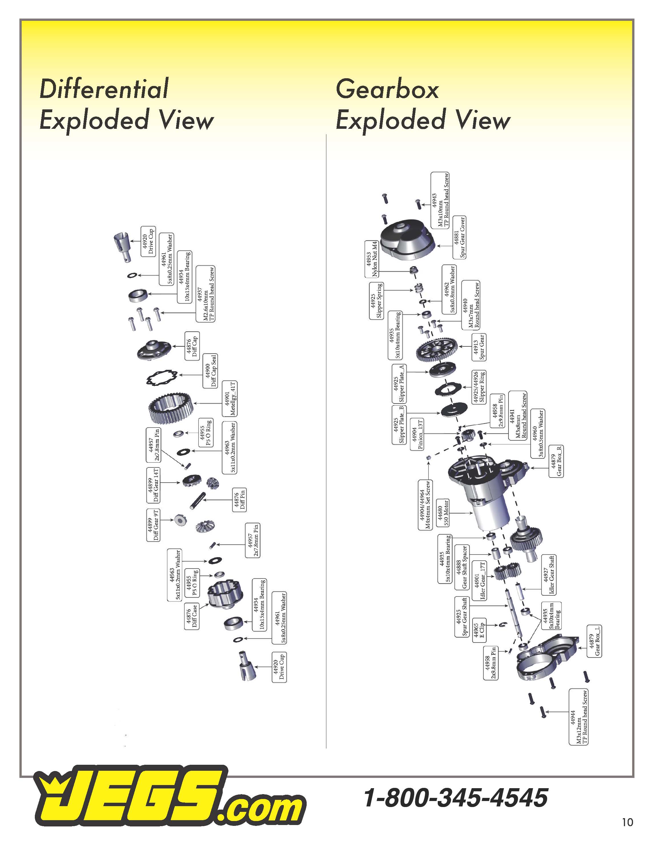

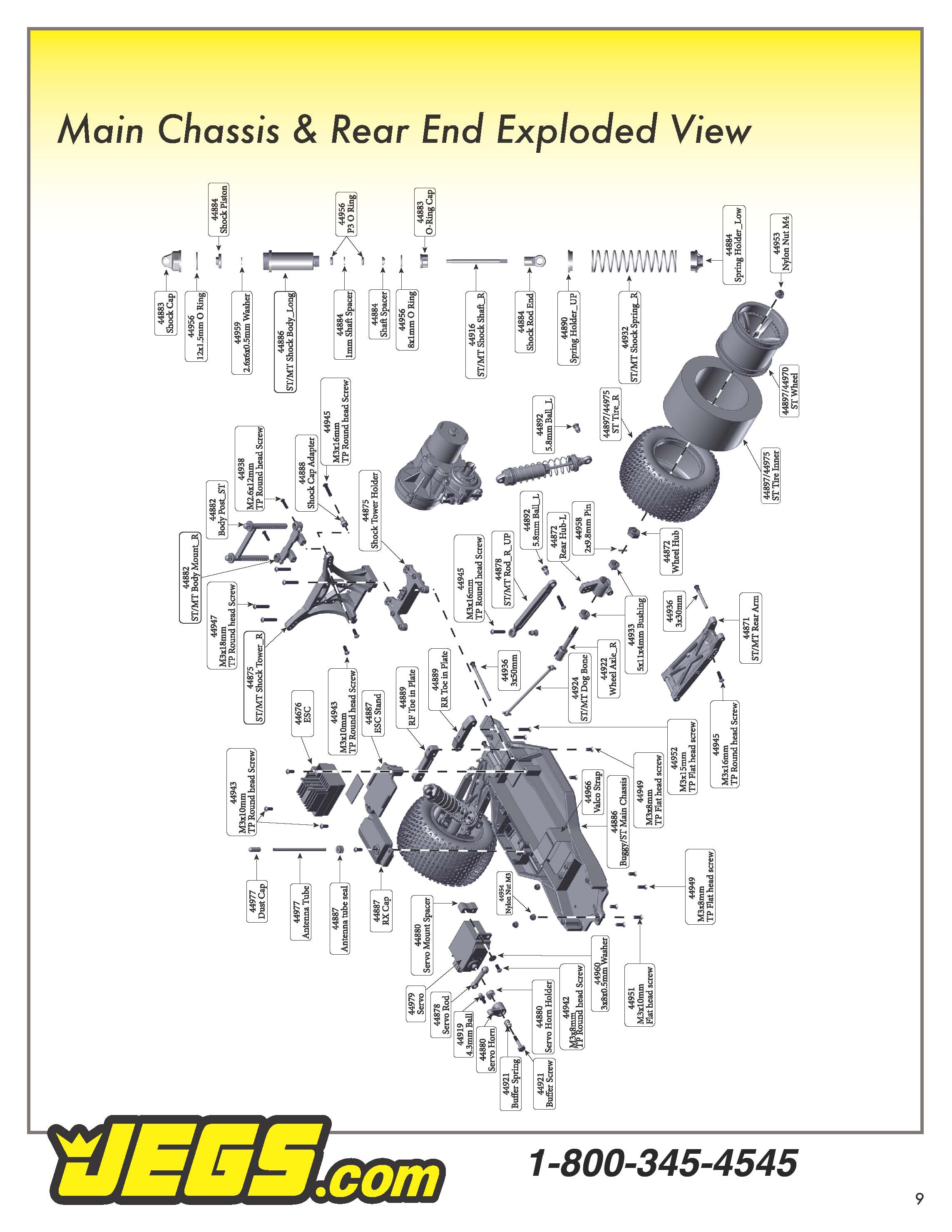

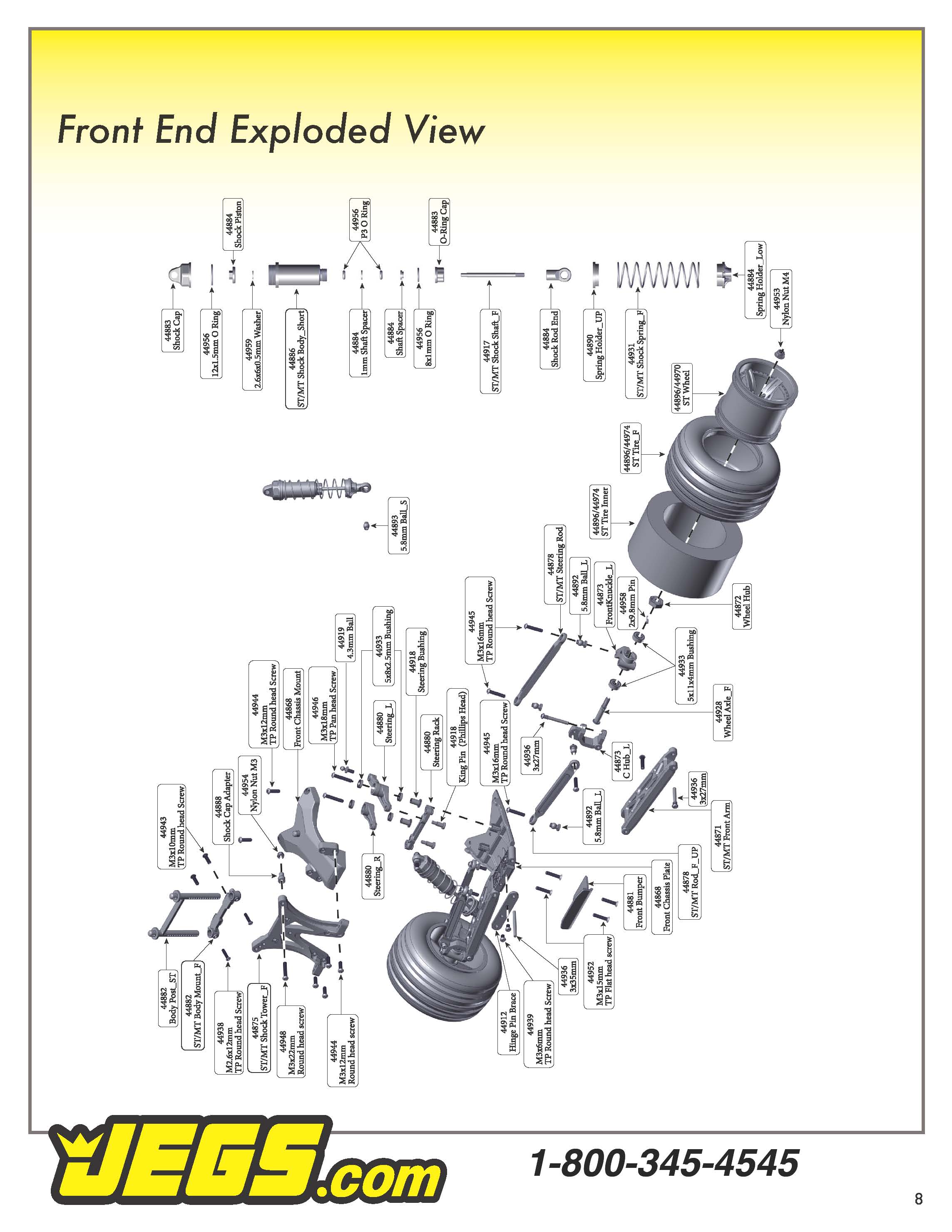

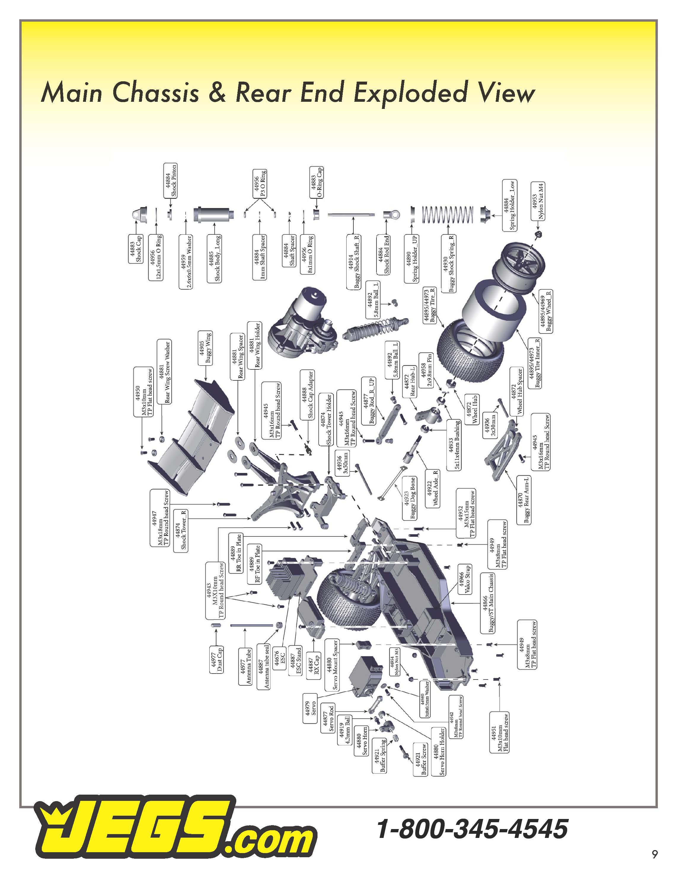

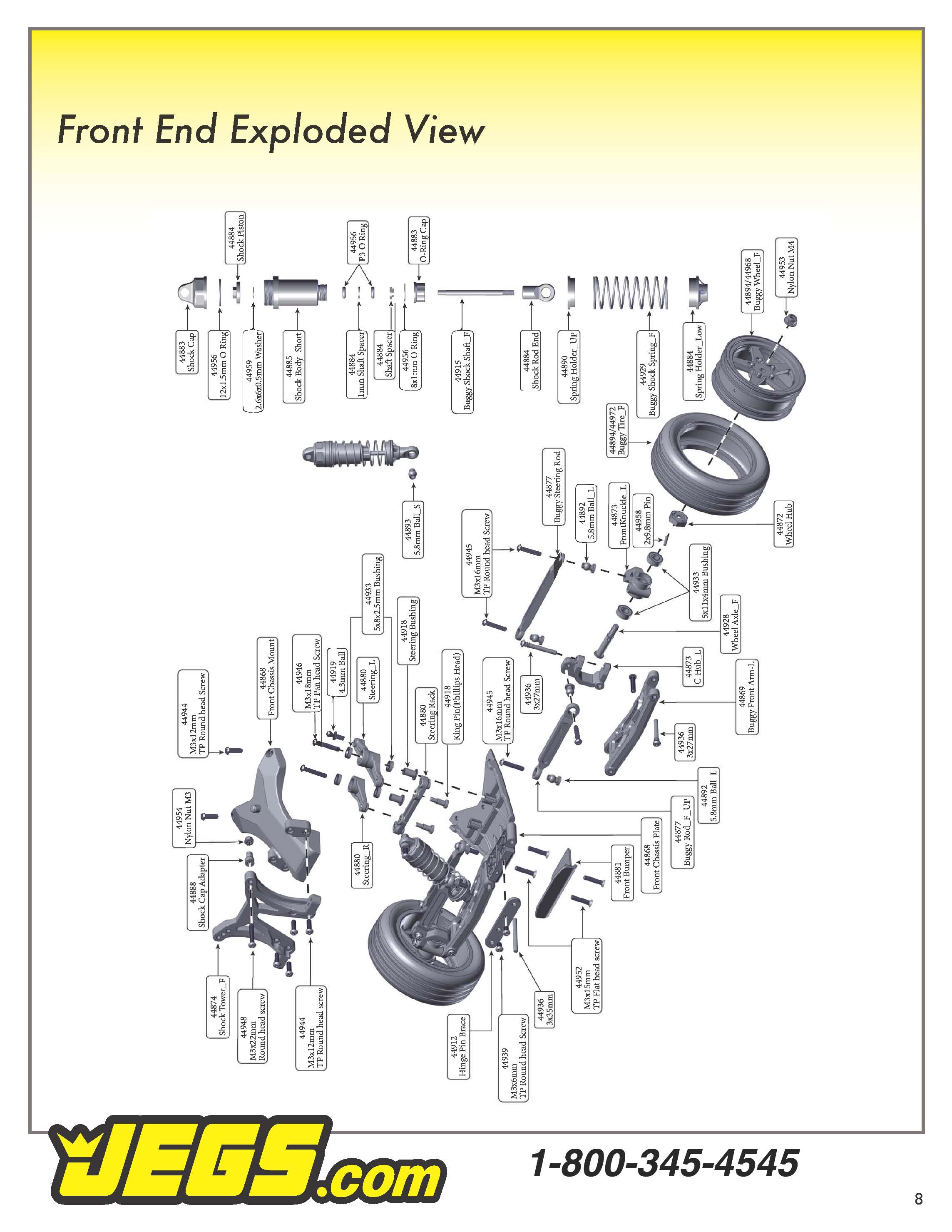

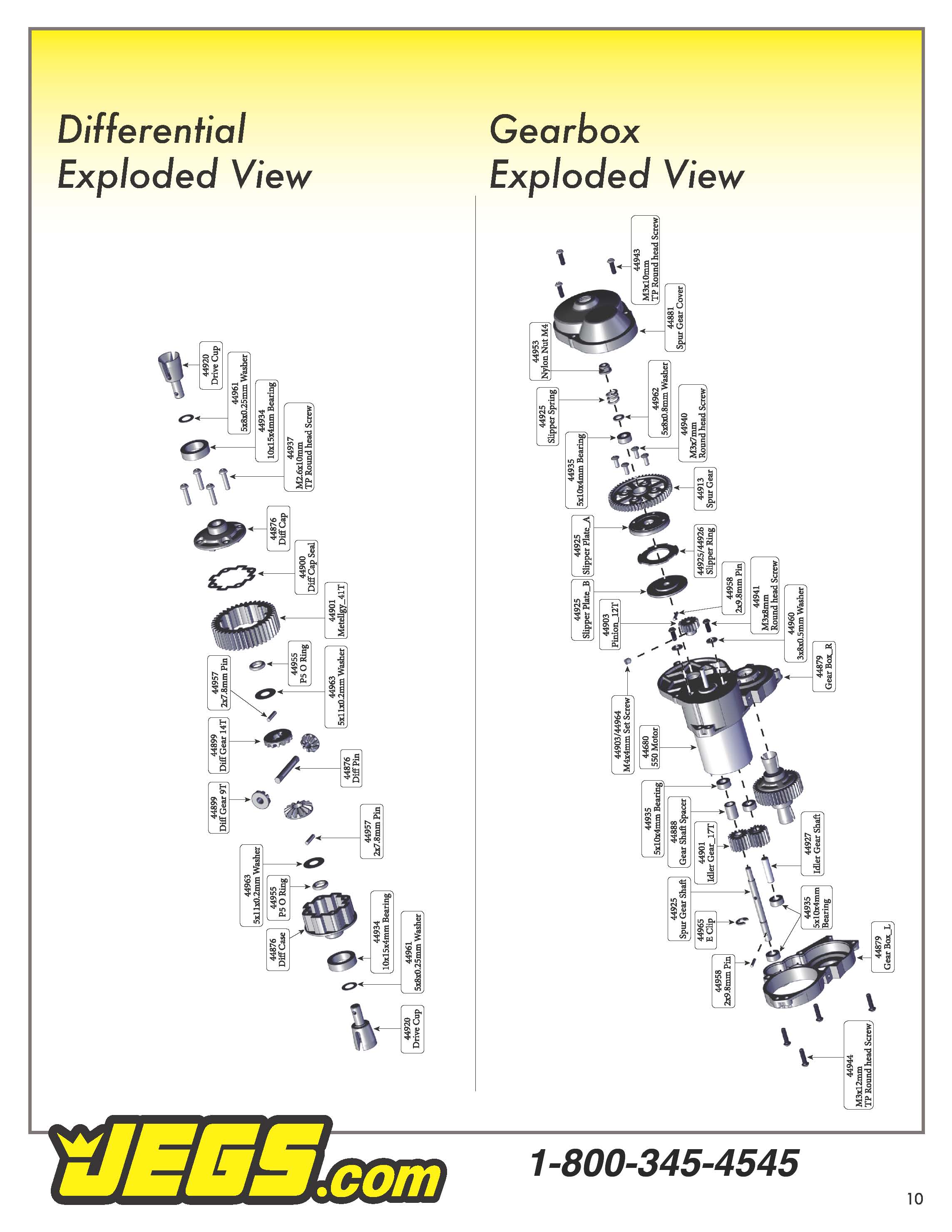

for future reference sake, and since Jegs is removing the pages with these documents, here are the exploded views:
Holeshot:
Stinger:

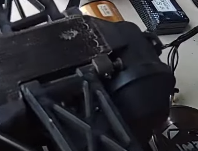

loose hinge pin problem..
Post by will5879 »
Ran across this, maybe something to watch out for.

The rear hinge pin came loose just like in the other post. It dropped a dogbone when it happened.
