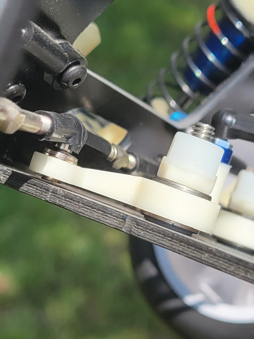

For those having issues with the bellcranks. It can be done without raising the bellcranks, reducing the already limited clearance at the ball cups.
This is a pic of my Composite Craft car with re-re Words bellcranks, with no extra spacers.
The ballstuds are from Schumacher, with very short threads.
You can clearly see the included nylon spacer at the bottom of the bellcranks and that the threads of the ballstuds clear the chassis. You can also see the extra 8-32 nylon nut on top.

juicedcoupe wrote: Sat Aug 10, 2024 3:02 pm For those having issues with the bellcranks. It can be done without raising the bellcranks, reducing the already limited clearance at the ball cups.
I'd rather have more thread engagement. To be honest you could probably just shave the bottom of the belcranks down a little bit for clearance as the OE ballstuds don't go all the way through them and there's a bit there you could trim without changing hardware. Looks like you shaved them completely off on your car or they just didn't have the extra bosses on the bottom?
Also the deflection in this assembly is kinda jank. I might just switch it over to the Factory Works setup TBH.

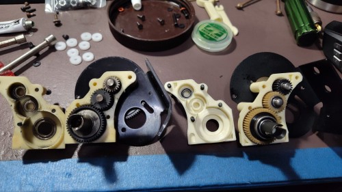

Back on the Transmission topic, if anyone didn't know the difference between the original Stealth and the Fan RC one here's a side by side. Idler gear on the Fan RC has the bearings in the gear rather than in the case.
One on the left is out of my OG RC10T and on the right is the Fan RC one.

RogueIV wrote: Sun Aug 11, 2024 4:30 pm
Those slightly protrude from the bottom. Unless you put a backing nut on, that's all the thread engagement available.
When they are in stock, I like the JConcepts ones. They are aluminum versions of the Worlds bellcranks.

juicedcoupe wrote: Sun Aug 11, 2024 7:30 pm
The Fan RC belcranks have material added to the ballstud areas meaning they have more thread engagement than your setup. The pic I posted earlier shows what I'm talking about. This is also what I was saying would need to be shaved down.
I got curious so I looked at the Schumacher ones and they are slightly longer than the Fan RC ballstuds (by 0.4mm), This means you could just shave the bellcranks and be good, hopefully.

RogueIV wrote: Sun Aug 11, 2024 10:35 pm The Fan RC belcranks have material added to the ballstud areas meaning they have more thread engagement than your setup. The pic I posted earlier shows what I'm talking about. This is also what I was saying would need to be shaved down.
For some reason, the picture of the Fan Rc bellcranks didn't show up when I looked earlier. But I see the problem now.

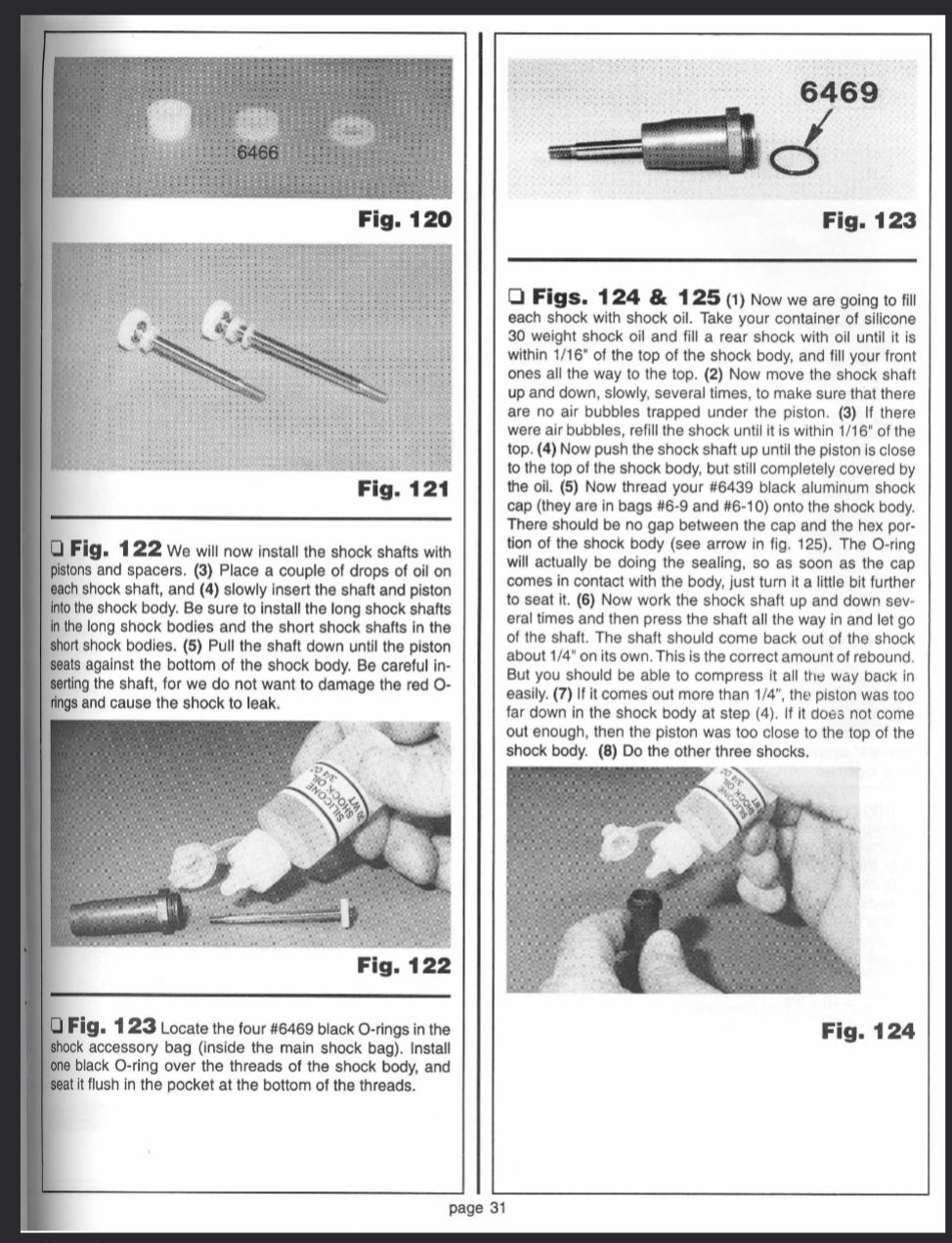

Can I bring this back to the shock shafts for a moment? So there's an issue with the front shocks only right? It sounds like the spacer included in the kit is for shorter shafts than the ones included in the kit? So there's two options... one get the shorter shafts or two get different spacers? 3/8" worth?
Posts: 12214
Has thanked: 1084 times
Been thanked: 3762 times
Re: Fan RC FR-01
Rear shocks, not front.
The rear shocks included are the 1.32 with 1.32 shafts. Same as all the rc10 buggies used except the world's car. Here is the page from the rc10 manuals. See the amount of spacer used?
This page is from the world's car which had the same 1.32 bodies but 1.02 shafts, note the much thinner spacers needed.
I suspect somewhere AE forgot what to do, similarly to many, many other little things they have got wrong on their rereleases- some as simple as forgetting to include holes. FanRC copied AE, which means he copied their failures too- like the rere world's trans and shock shafts
