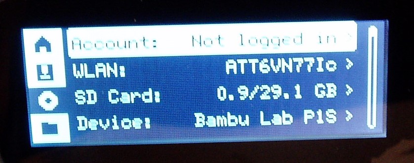

So, here is current status; printer screens:
Settings:
Account:
WLAN:
Firmware:

@XLR8 , did you download Bambu Studio already, and created an account already?
on the account screen you have the device name. Try to add this device name in Bambu Studio on Device page by click add
If this doesn't work :
On WLAN menu, what happen if you select access code? Is it possible to select access code?

I've been away for my computer for a few hours - sorry for late reply. Let me attempt to catchup.
First, yes I have Studio version 1.09.07.52 and I believe it pulled my account info from Bambu Lab website (from when I ordered the printer a few weeks ago). Anyway, it shows I'm logged in but I don't recall ever setting up a new account after installing the software.
On WLAN, I'm unable to select Access Code - using down arrow key, it skips passed this.
