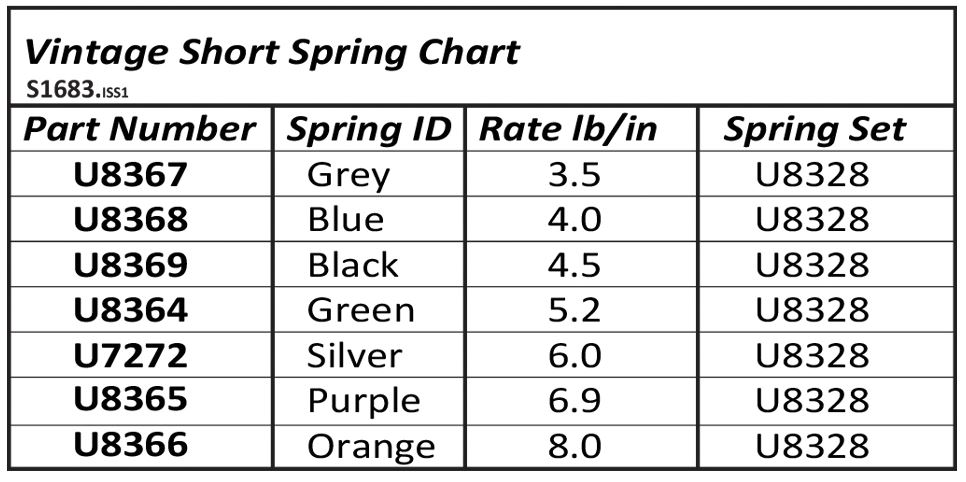

Sorry for the late reply, but as I mentioned in another thread the Schumacher small bore springs would work very well. In your case probably with a 3-4 mm tube under the cup.
Of course this depends on your wheels (in case you are racing with 2.2) and your desired final ride height. Here is the front spring chart.
