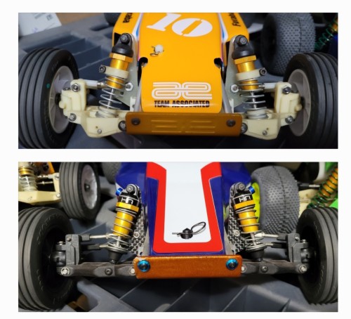

There is also the option of using different spring cups.
B4's had various spring cups that seated the spring at different heights, all higher than the early cups that Fan RC copied.

Here is a comparison Pic. Both car have the same length shocks, same springs, and same tires. The short arms and Andy's arms mount the shock relatively the same.
The difference in spring seat height and preload is pretty evident.

I did look at the cups , they are really deep , I did consider just making a 2 or 3 mm spacer to go over them so I might start there

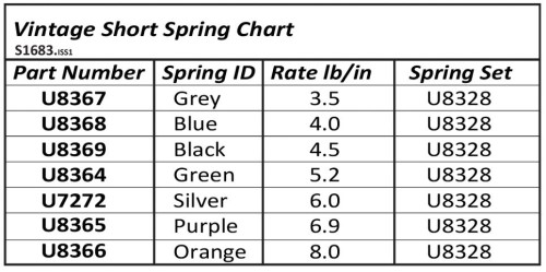

Sorry for the late reply, but as I mentioned in another thread the Schumacher small bore springs would work very well. In your case probably with a 3-4 mm tube under the cup.
Of course this depends on your wheels (in case you are racing with 2.2) and your desired final ride height. Here is the front spring chart.
