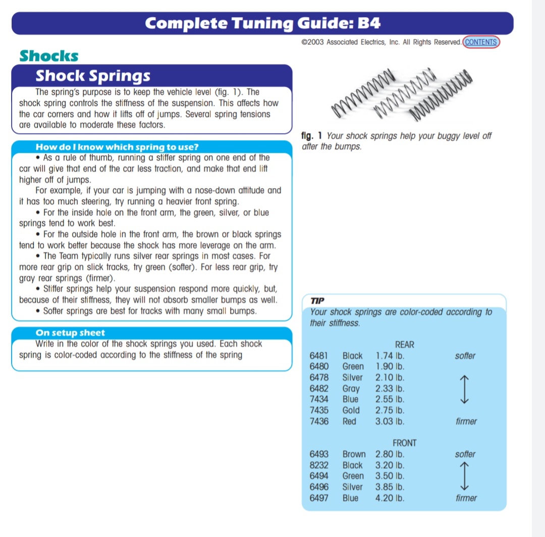

Of course this depends on your wheels (in case you are racing with 2.2) and your desired final ride height. Here is the front spring chart.
