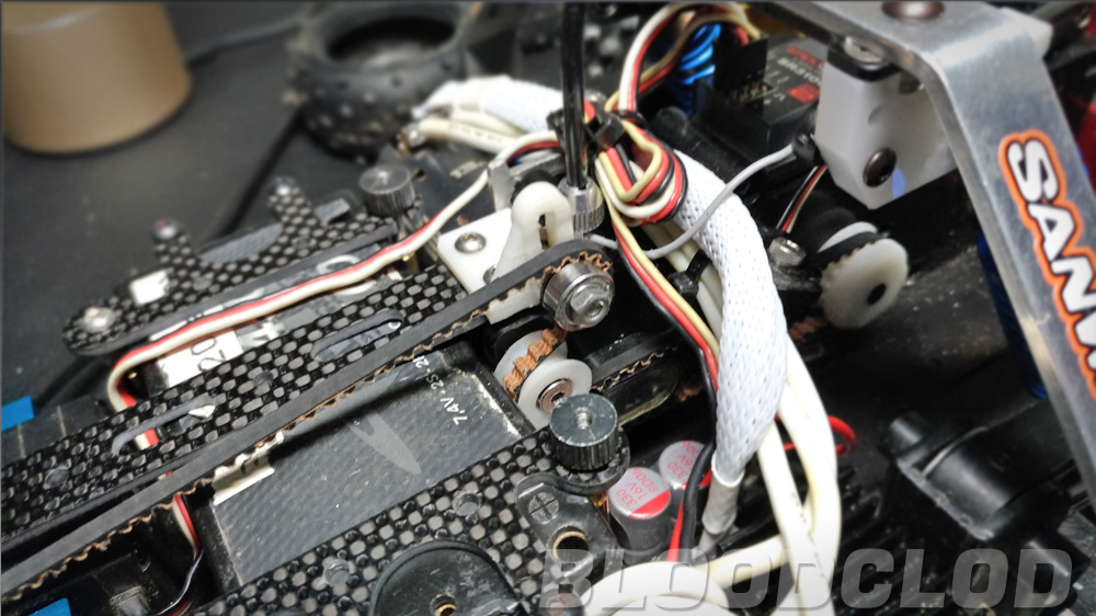

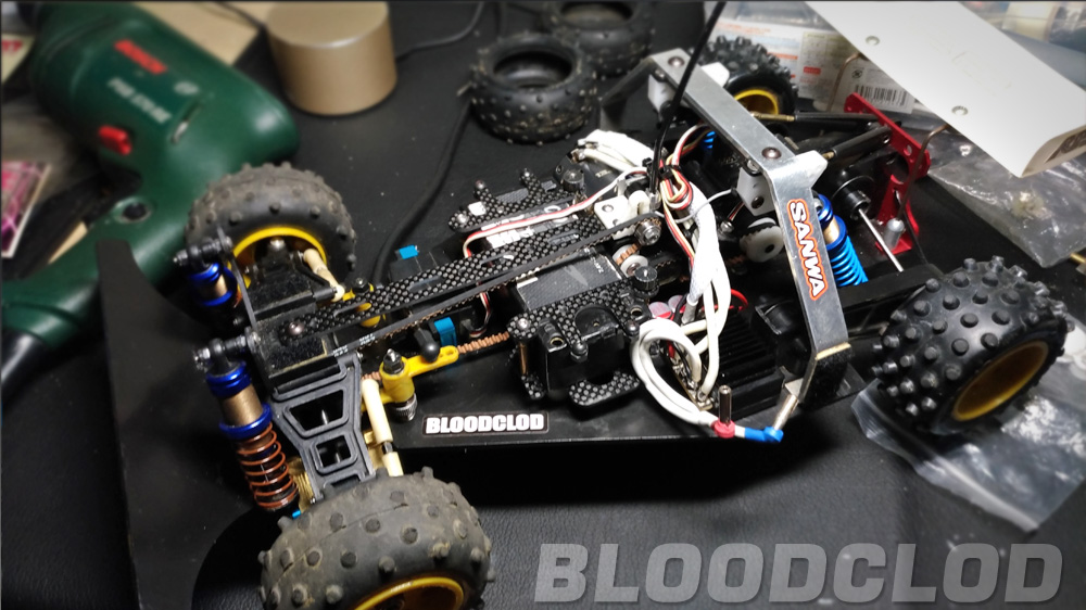

Some progress over the last couple of days...

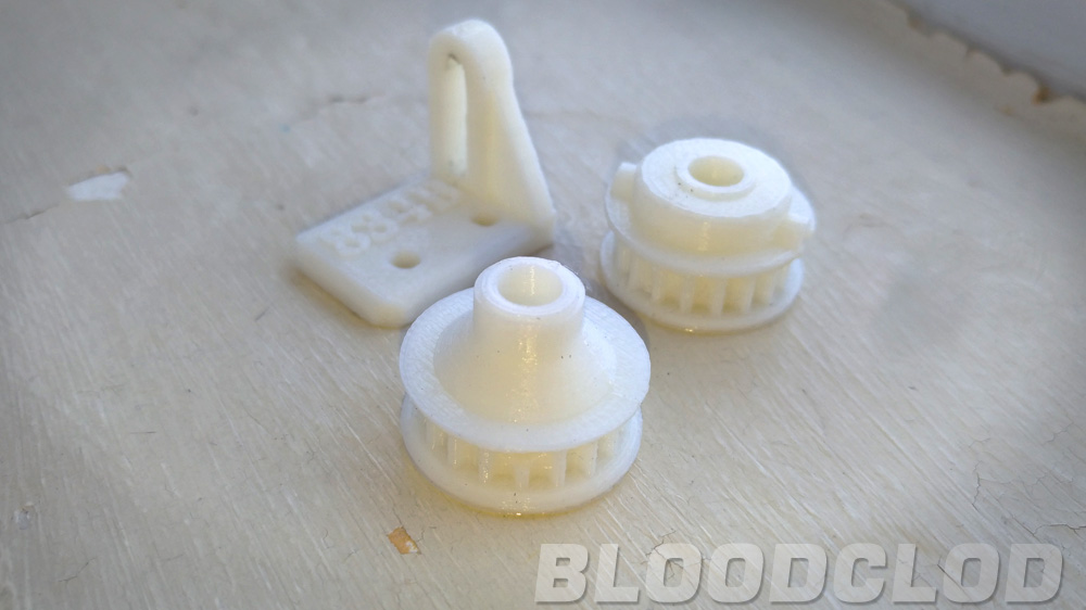

First I printed up a new set of pulleys and a new belt tensioner with some revised dimensions and they came out looking pretty good.
The main difference in this version of the pulleys is that I was playing with the idea that since the front pulley was closer to the centerline than the rear pulley (making the belt "bend" around the center tensioner), it might be possible to move the rear pulley even further away from the centerline so that the front pulley, belt tensioner and rear pulley are all aligned but slightly canted.
But after installation my theory didn't pan out in reality... due to the way the belts wrapped around the pulleys they just didn't run well in such a configuration.
So it was on to version 3 of the pulleys. This time the idea was to offset the front another millimeter outwards and the rear pulley closer inline to try to line everything up. I also designed a guide pulley in the center to ensure the belt stays where it's supposed to be as it routes around the tensioner. Everything fit great and things were looking good.
A quick test on the road and everything worked great! The car ran smooth and the belt never skipped a beat. It'll have to hit the track for a more thorough testing but I'm so glad so far the conversion was working better than I had ever expected. lol!

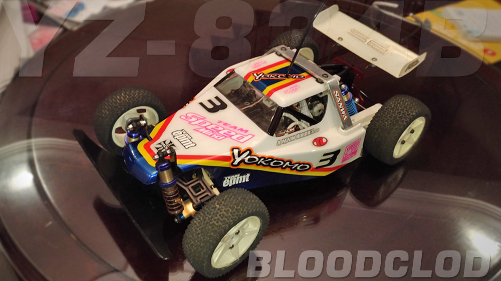

The car was looking very different from what I had started with. Here's how she stands now. :)

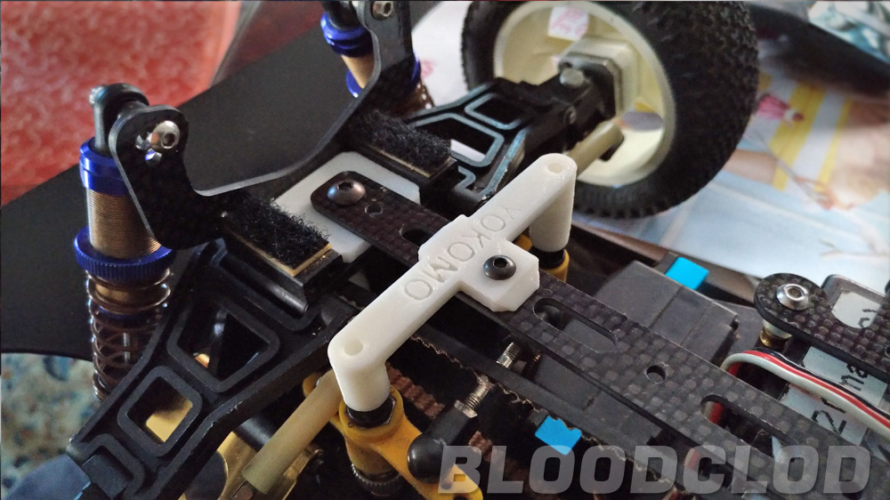

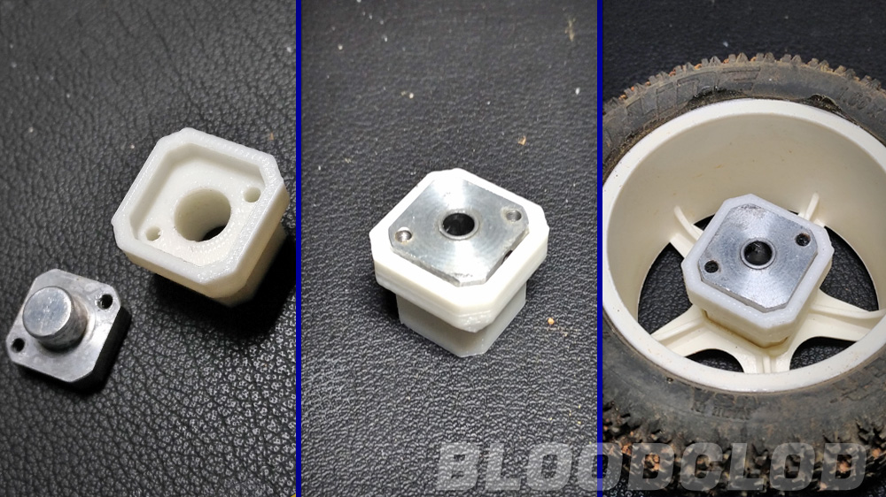

Earlier in the day, while I was driving I had an idea for a design for an easy way to mount 2.2" JCRACING wheels on my 834B while getting the right width I wanted... I booted up the CAD software and shortly after a pair of these were done! Introducing my version of the Yokomo vintage wheel widener!
I had previously used carbon plates cut to the shape of the "square" to widen the wheel and they had worked fine but there were some limitations - namely I was limited to the width of the carbon plates and secondly when they extended past a few millimeters the wheel was no longer engaged to the original metal hub so the only thing driving the wheels would be the 2 screws holding the assembly together. I doubt that was an issue, but this design actually keys over the drive hub and into the wheel to better transfer the power.
Had a big smile when everything fit snugly together with no slop and when I powered it up everything ran true.
Now I can easily adjust my width by printing them up according to what I want to achieve. Getting the car to fit easily available 2.2" wheels nicely has always been something I could not easily fix but if this holds up then I would've solved another concern that stood in the way of regular running of this car.

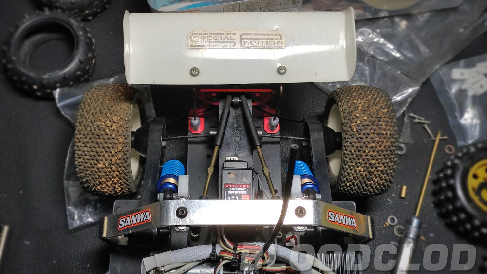

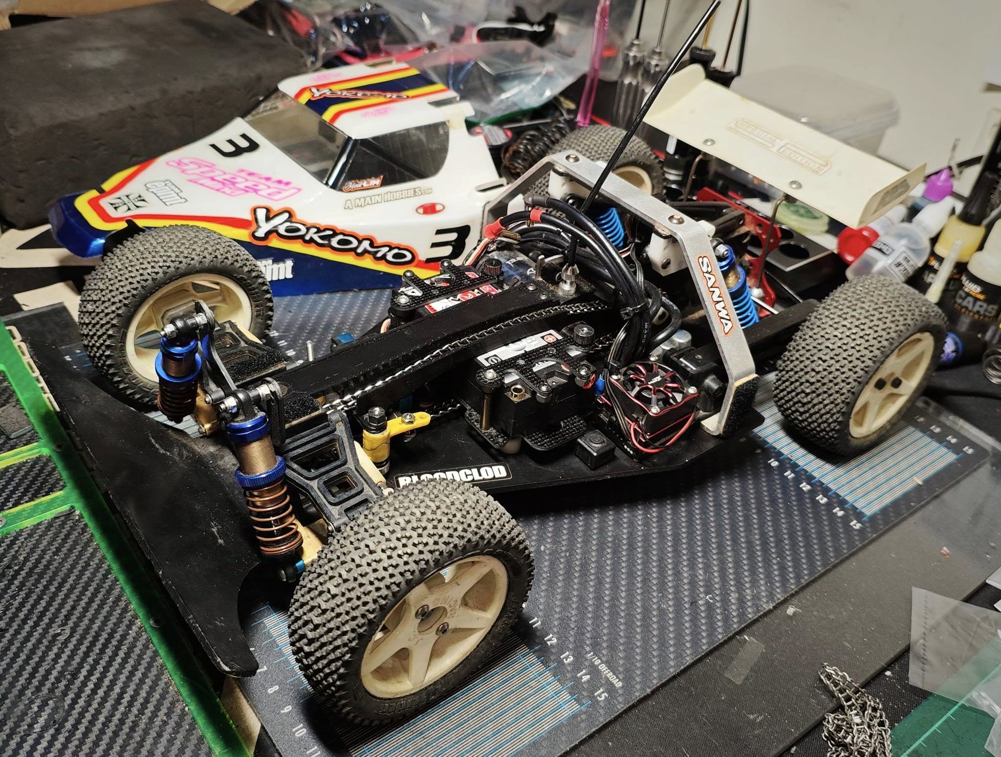

Just a quick update to show you how the car looks now with the widened stance and modern 2.2" tires.
Aside from that, I did something else quite significant... can you spot what it is from the picture? :)

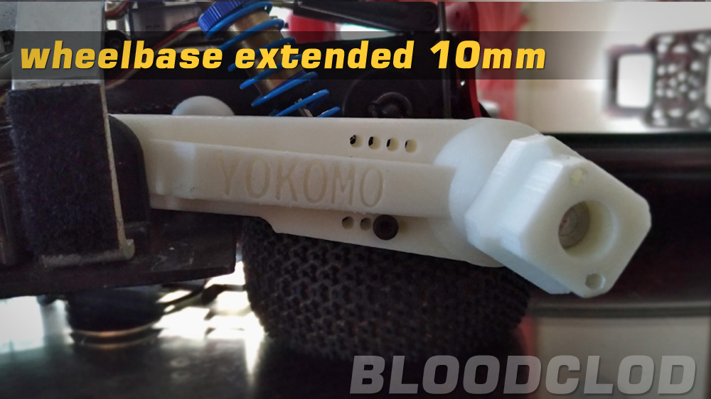

You made new rear arms.

rraeford wrote: Tue Jul 25, 2017 9:21 pm You made new rear arms.
Yes! Since I had widened the car I thought I could attempt lengthening the car as well and I decided to try to make some new arms and lengthen them to achieve a longer wheelbase.
This 834B I'm working on is also one of the earlier versions so the original arms are quite flexible - these new ones are also designed to be stiffer with a slightly thicker profile (for better fitment into the pivot blocks) as well as with the additional support running down the center of the arm.
It took a little adjustment but the bearings seat snugly and now the car has a wheelbase similar to the Kyosho Optima... not quite modern day standards but the additional length should help the car handle today's tracks a bit better.
On the front end there are also some updates to try to improve the steering. First, under the top deck you can see a new spacer which is there to let the top deck run parallel to the chassis. With the original top deck gone, the steering seemed really sloppy because the two long screws were holding the bellcranks would flex when the servo was turning the wheels. I made a simple brace to connect both the screws together on top and then to the chassis so the servo motion is better translated through the bellcranks to the wheels.
With the added width and these adjustments, the car is steering a lot better than stock. Though I might want to work on some stronger bellcranks as the stock ones are a bit flexible.
I think I'm almost done with the car. Initial testing seems really positive and I'm looking forward to a test on the local offroad track. :)

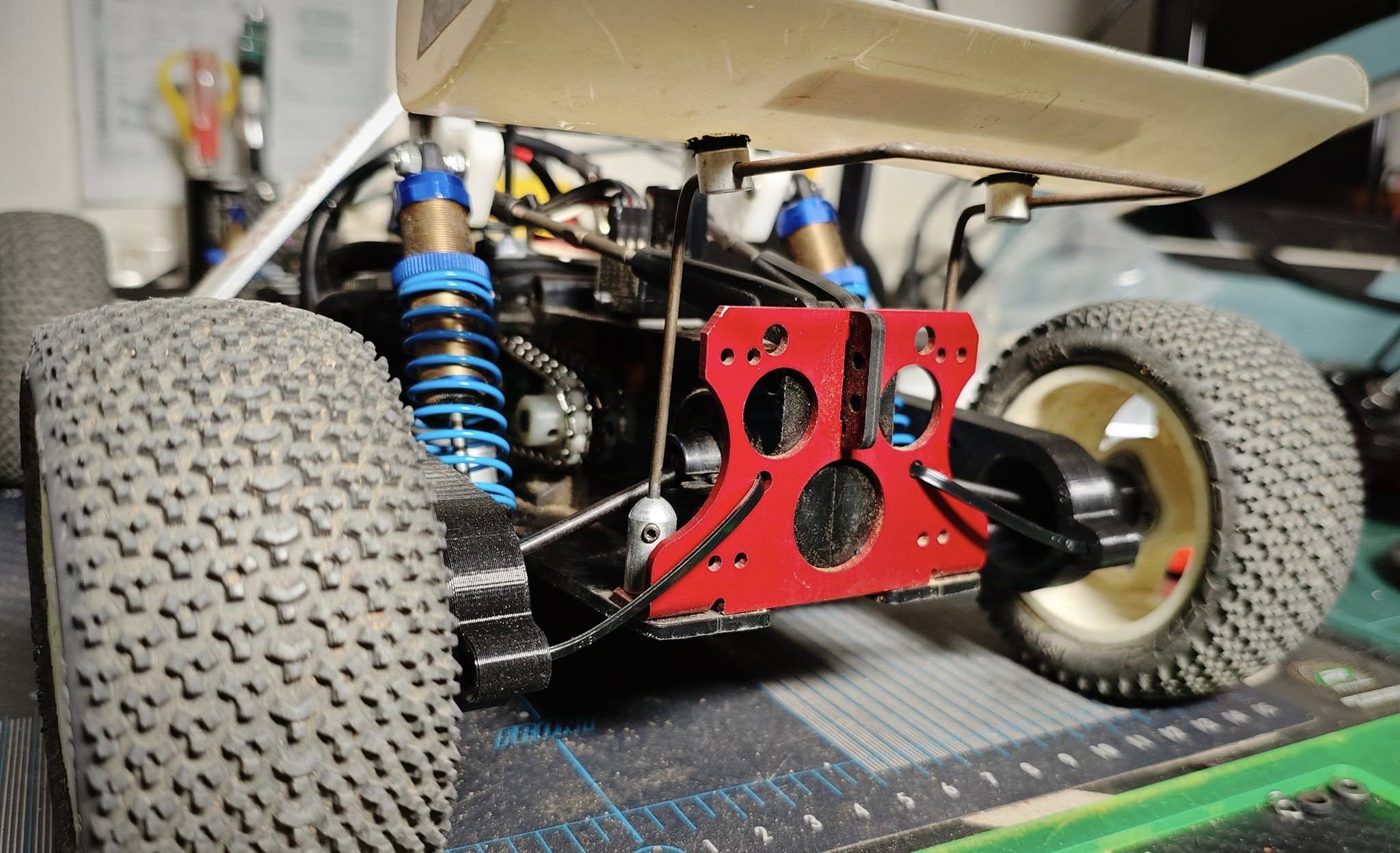

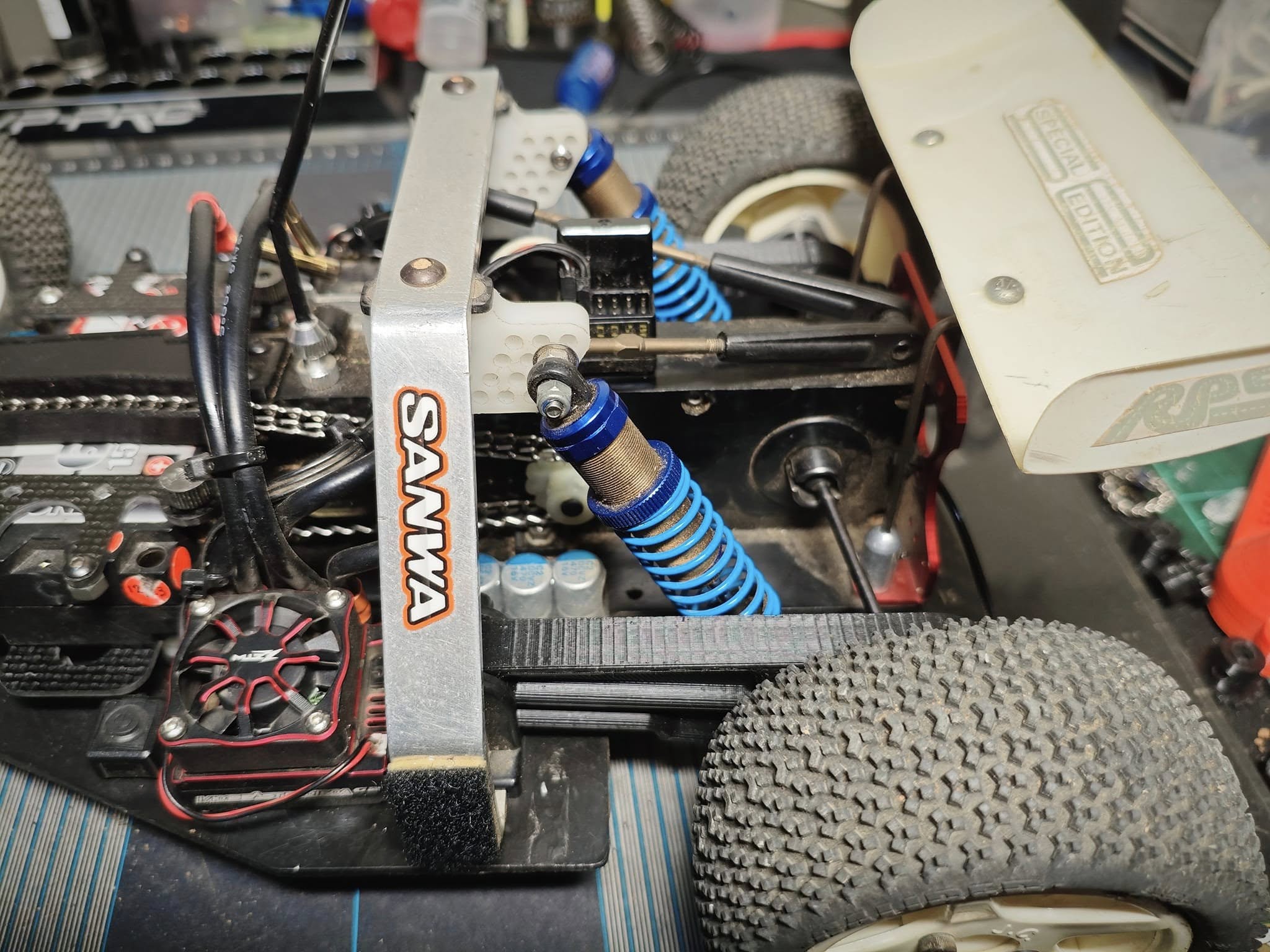

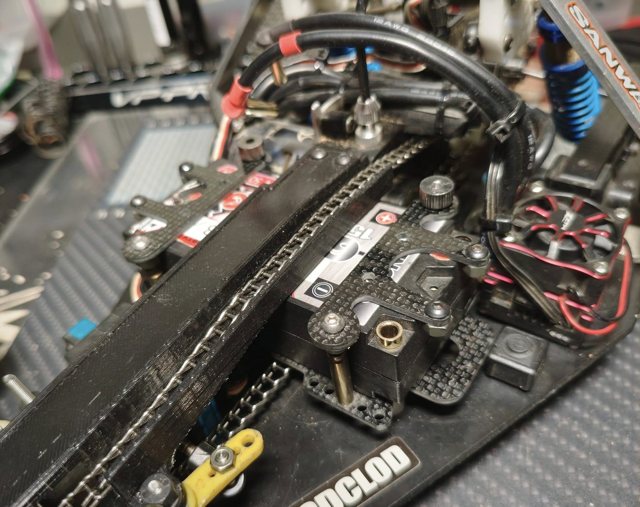

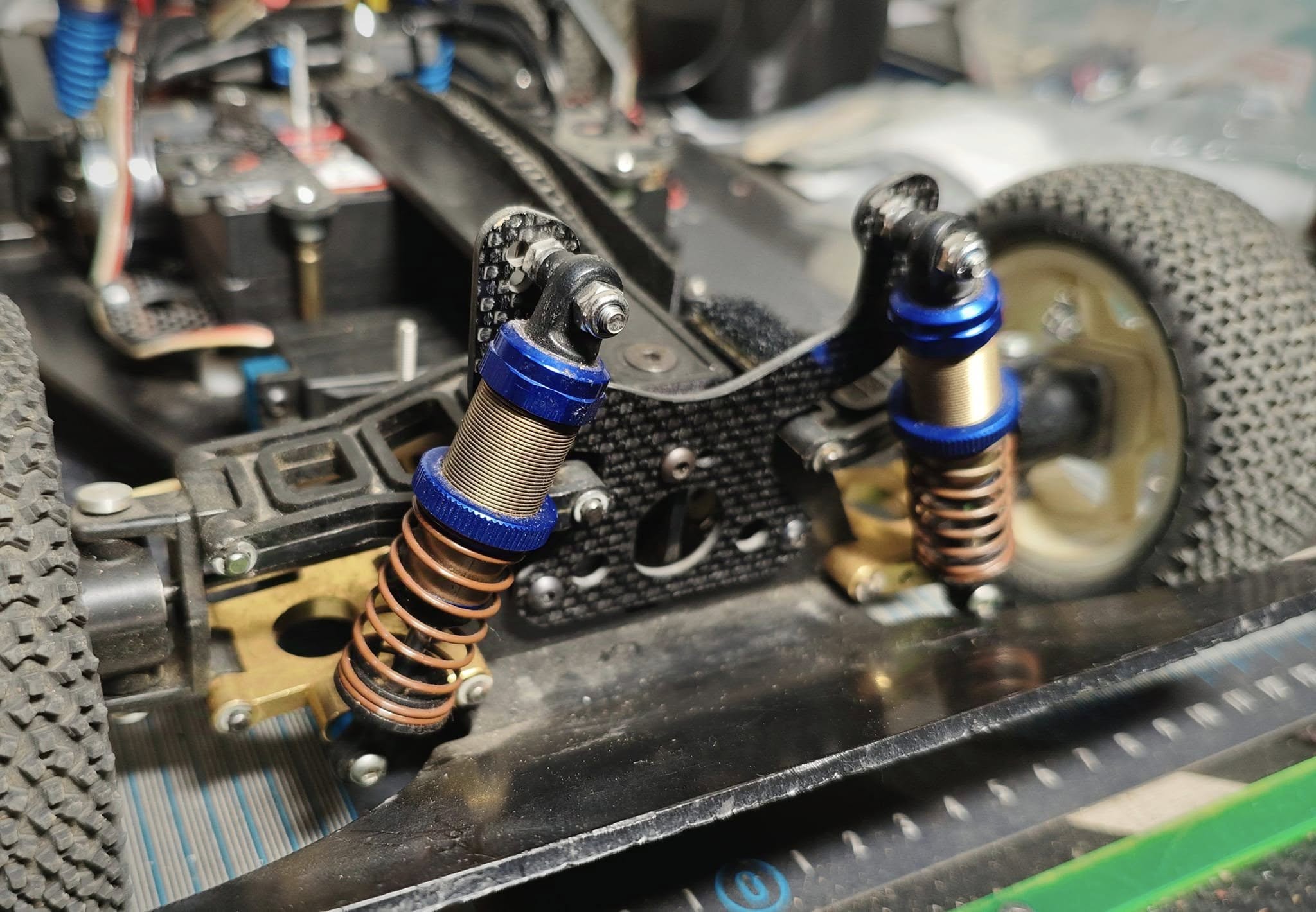

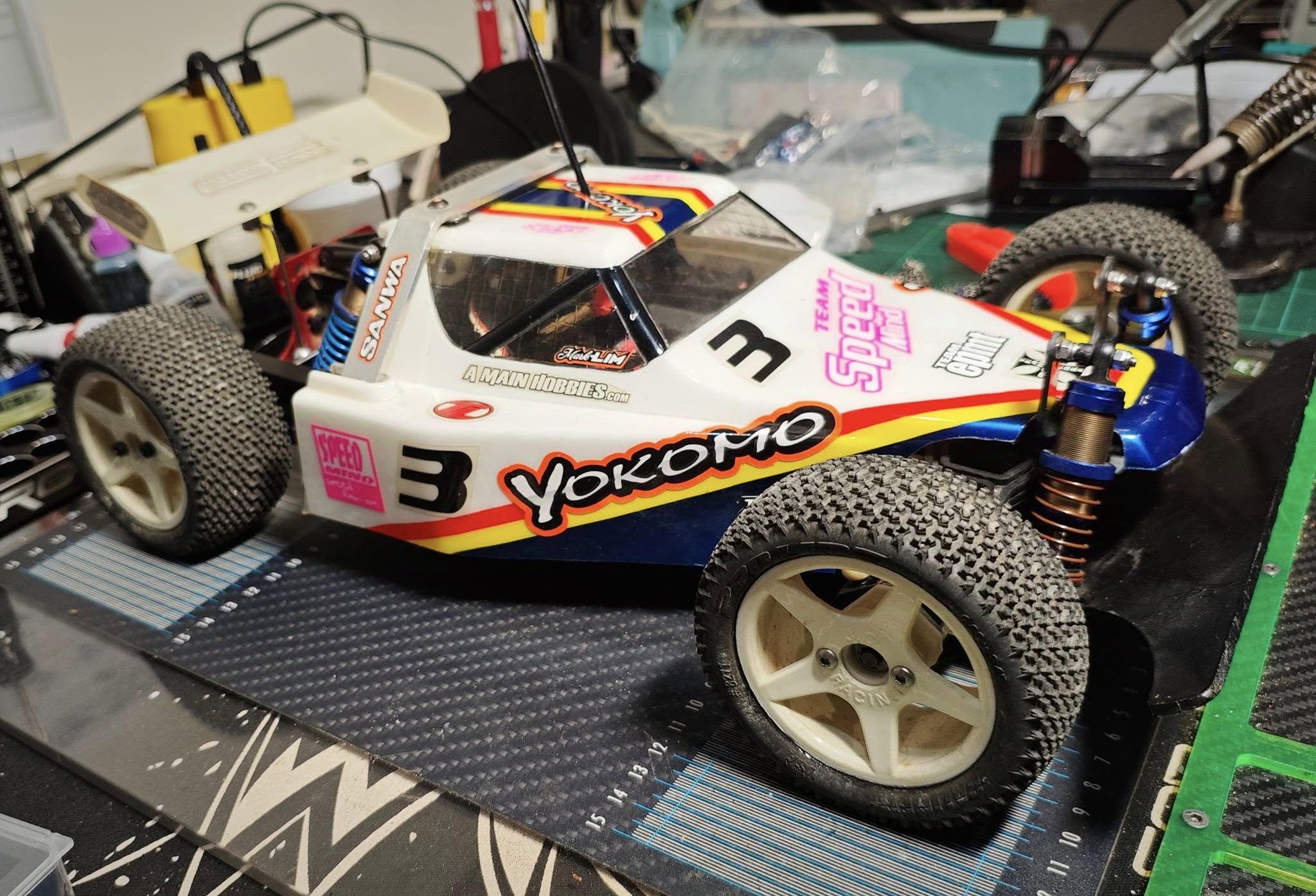

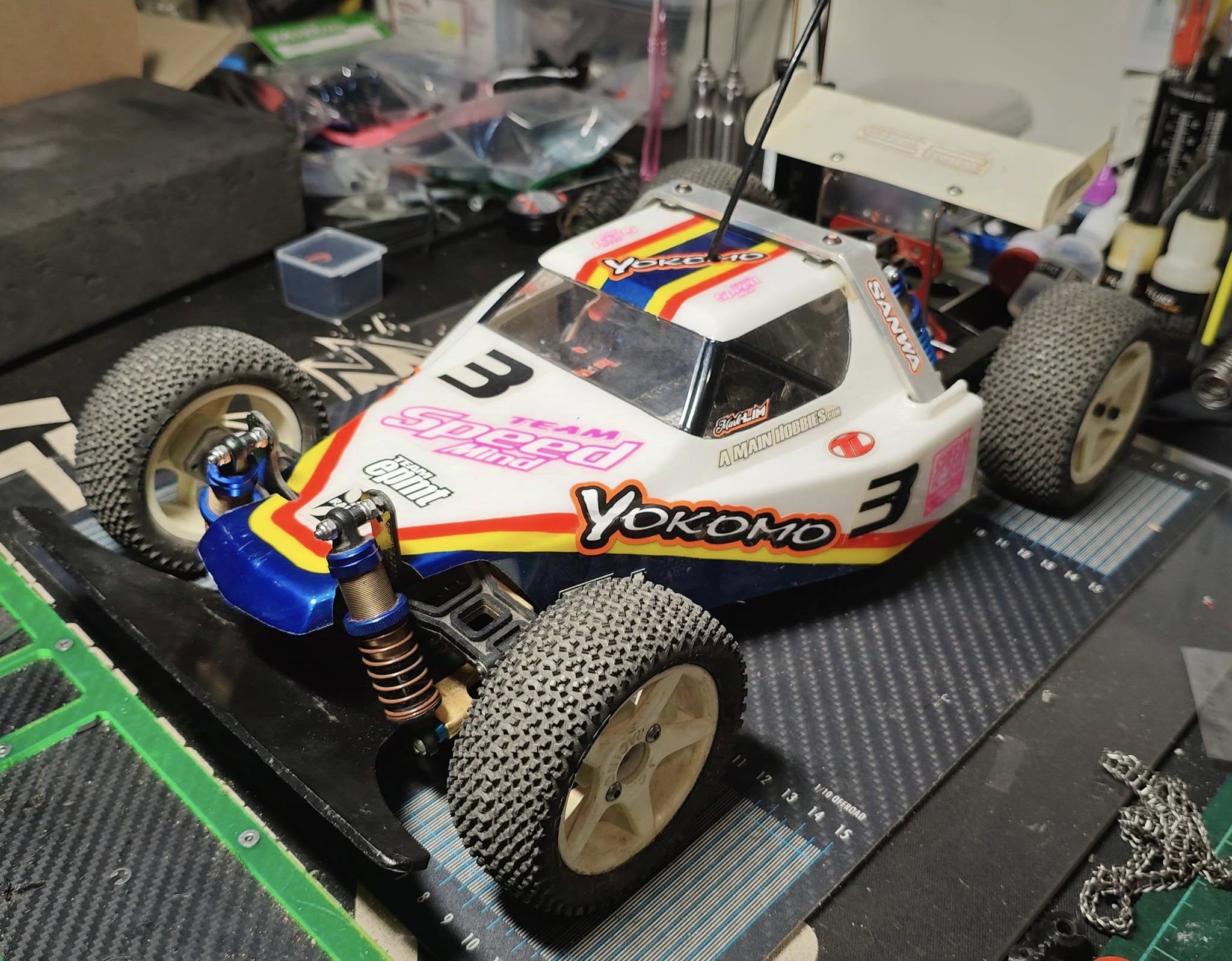

How time flies... it's been 7 years since I last posted on this project and since then Yokomo has even rereleased the 834B! lol.
This project was put into storage as I never got the belt drive to work as well as I had hoped. The main issue was that the drive belt I was using came from a touring car and it was just the wrong width and pitch to work properly on this car. The intent was to look to some industrial belts but I just never got round to it.
I thought that with the rerelease my 834B would be able to hit the track again with a new supply of sprockets (YAY!), but as with the 870C rerelease, Yokomo decided to redesign most of the parts just sufficiently so that compatibility would not be so straight forward. I purchased new sprockets and a chain an it took quite a bit of effort to retrofit it into the original car... the sprockets needed new holes for the retaining pins to go into as the stock holes are spaced differently, and the thickness of the chain needed a new chain guide for it to fit - so I 3D printed one that.
Tested the car out today and it works great! I am going to take my 834B for more runs in the next few weekends.
Here are some pictures of the car with the mods done 7 years ago and the retrofit belt and sprocket system from the rerelease car. :)
