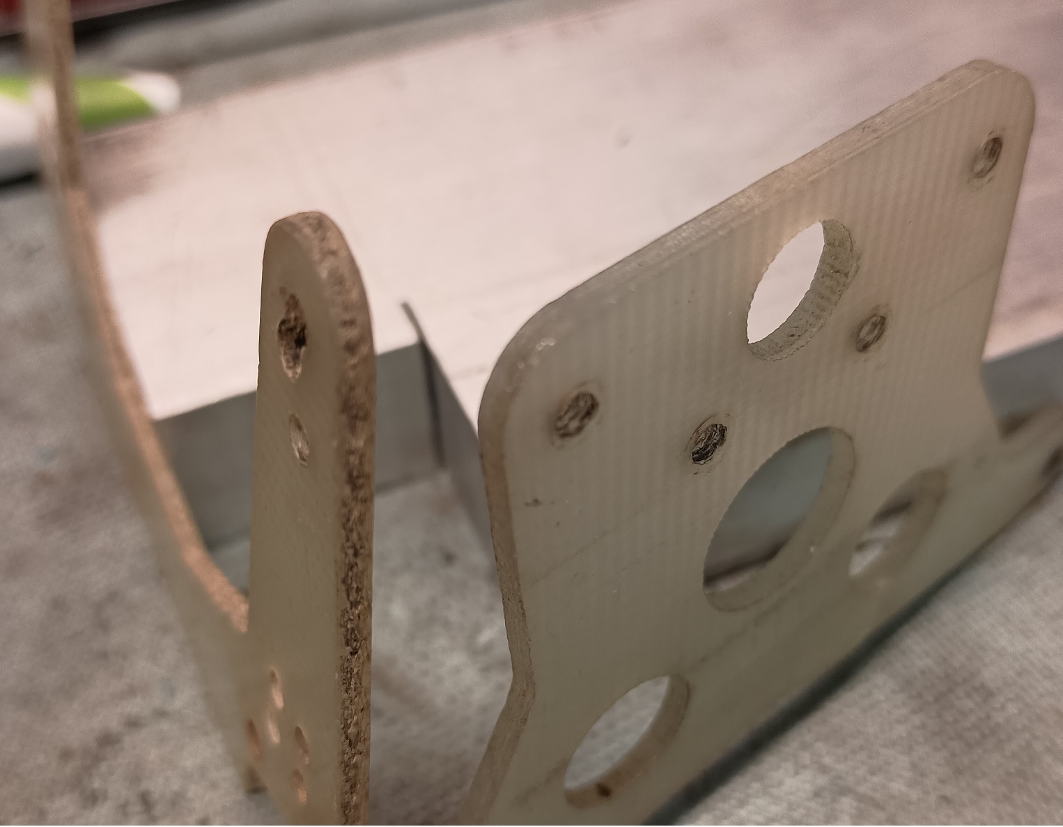

Re: EXamples of stamped vs Milled shock towers
they are punched in a die set, and the edges will be somewhat rounded. they will seem kinda......furry. the color will be lighter, whitish.
the machined edge will be nice and crisp and the edges will be pretty much same color as the base material. In the image below of two very dirty towers, the left is punched, the right is machined. you can see the machine marks in the right part.

Re: Examples of stamped vs Milled shock towers
Those 2 images back to back help. I'm hoping to make sure that I have the right towers.
