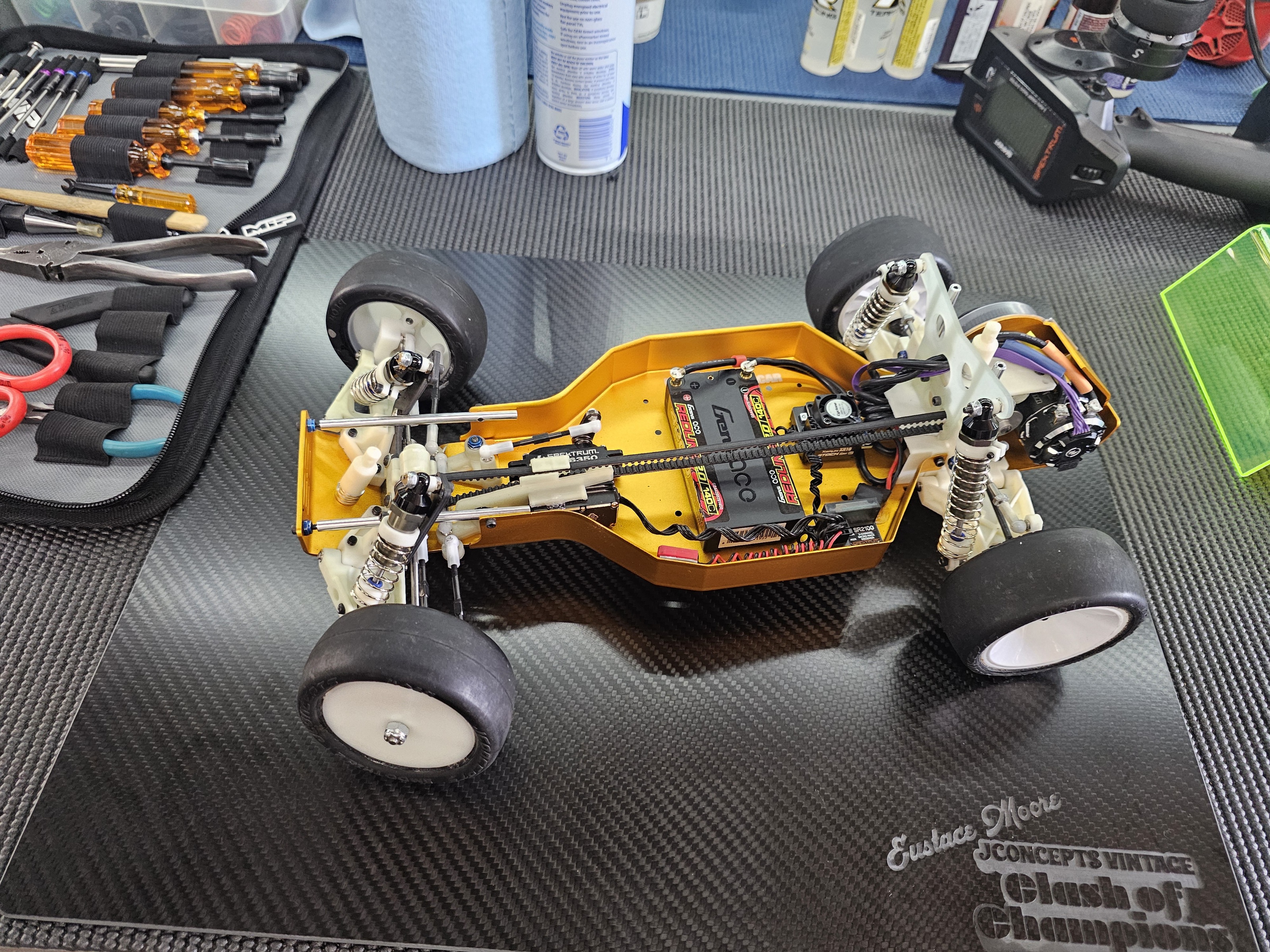

Eustace will be running the prototype for the continuation of the Legend this weekend. I'll update when I can.
Notable differences- the front end is updated with a stronger carrier and hub design. Same front transmission but the slipper is now more like a single pad rulon style slipper and mounted to the front trans instead of the rear. Most of the conversion is original to the last version they used (not the last version commercially available)

Oooooo!!!!
....and I like the tool kit next to it too.
That guy isn't old enough to be Eustace Moore!

is he running front tires on the rear as well?

Yes, same issue we face the front needs to be overdriven or we need the same diameter tires, so he went simple and used wide fronts on the rear

beginning to wonder if you should run a smaller pulley up front to fix that issue without changing tire sizes, or is 1 tooth down too much of a change? I know my XXX-4 has this option.

How does he have that battery secured in the chassis?

He has the pack taped for testing. Look like cups will fit fine.

Looks like chrome CV joints - I hope he sticks with that. Interesting new belt tension design. Looking forward to seeing the release. He has excellent design skills and making in USA is admirable.
