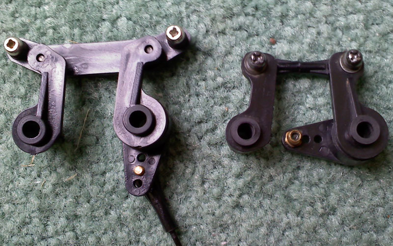

I don't know what exact Kyosho they came off of, but can you use either of these? If so they're yours...though I'll need to harvest the ballstuds for my Bullet.

I may take you up on those, they aren't correct but they may work in a pinch. The right is optima and the left maybe outrage?

Its funny how the different models can share parts. Im discovering this by building cars with no instructions! They go together and work just fine. Pretty sure these pics of steering cranks has helped me to solve the same issue. Ill just see if the ones in hand will fit the posts...

You could also consider going with an alloy, ball-raced bellcrank like Tamiya #54235, it's functionally identical to that plastic unit shown above, on the right. All you need to add are 4.8mm ball studs on one side and 4.8mm threaded balls on the opposite side, and a servo saver on the servo. Just an idea if you're looking to upgrade or bulletproof your steering. I also think Option House or some other 3rd party company made a very rare gold alloy bellcrank for the Optima Mid or Ultima (not sure which), I have one of those units too...it's again functionally identical to #54235 and the plastic unit shown above on the right.

¯\(°_o)/¯gomachv wrote:...the left maybe outrage?
I can't identify too many Kyosho parts that aren't off a Circuit 1000 car.

I have a parts tree that's either Outrage or Ultima II, has solid upper links and the steering bellcranks and servo mounts on it. If it will help, it's yours.

The left is also used on the Lazer AlphaPhin wrote:I don't know what exact Kyosho they came off of, but can you use either of these? If so they're yours...though I'll need to harvest the ballstuds for my Bullet.

They look identical with the exception of the center-link.EvolutionRevolution wrote:The left is also used on the Lazer AlphaPhin wrote:I don't know what exact Kyosho they came off of, but can you use either of these? If so they're yours...though I'll need to harvest the ballstuds for my Bullet.

If the left one is made from the Lazer Alpha plastic, it will break before the servo saver gets a chance to actCoelacanth wrote:They look identical with the exception of the center-link.EvolutionRevolution wrote:The left is also used on the Lazer AlphaPhin wrote:I don't know what exact Kyosho they came off of, but can you use either of these? If so they're yours...though I'll need to harvest the ballstuds for my Bullet.
