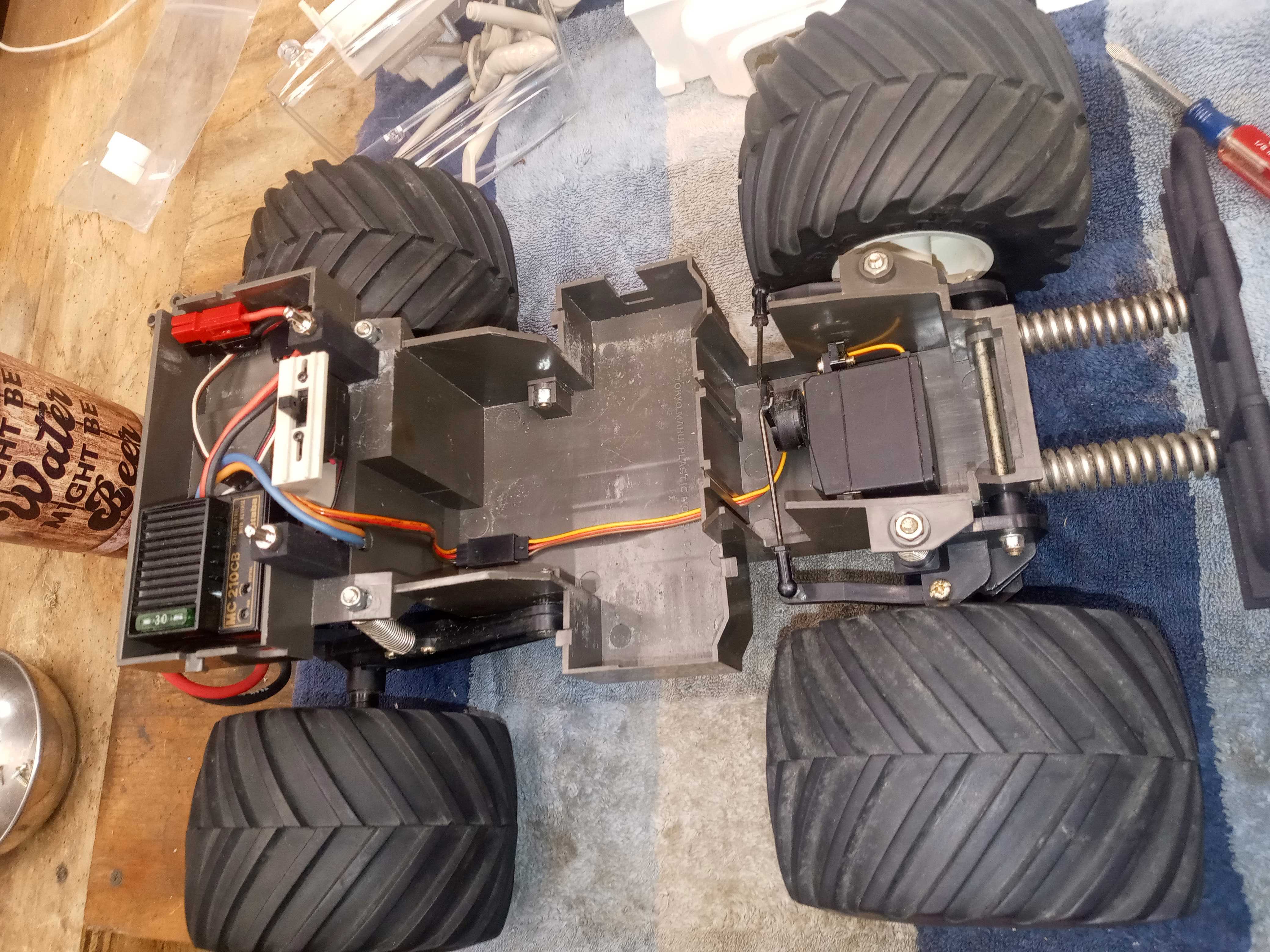

Got the rear repair body posts printed and used Tamiya Frog body posts. Had to cut the thread off the Frog mounts and then cut 8-32 threads on the upper of the shaft and everything screwed together just nice, without doing any drilling on the printed repair parts. I can get more pics if anyone is interested.

It's been a minute but finally found time to sit down and finish painting the body. So, I'm gonna ask for some opinions. I don't know if I want to put on the decals (got a set or repros from MCI). Thoughts?
Other than that, it's done. Stock motor with a Futaba MC210 ESC from back in the day and a random servo I had laying around, can't remember what it is but it turns the tires so good enough for me.
Spray paints came from Tamiya. TS-50 metallic blue and TS-29 black. The rest is from a set of Testors acrylics. Not to pat myself on the back or anything but I'm not gonna be running this, it's fully functional but I'm not messing up the body, maybe an occasional topless run however. Now on to my Blackfoot. My very first R/C that I got as a kid and my brother has been hoarding for me for years. Got it back from him a month or so ago and it's time to get it back into running condition. More on that to come...
