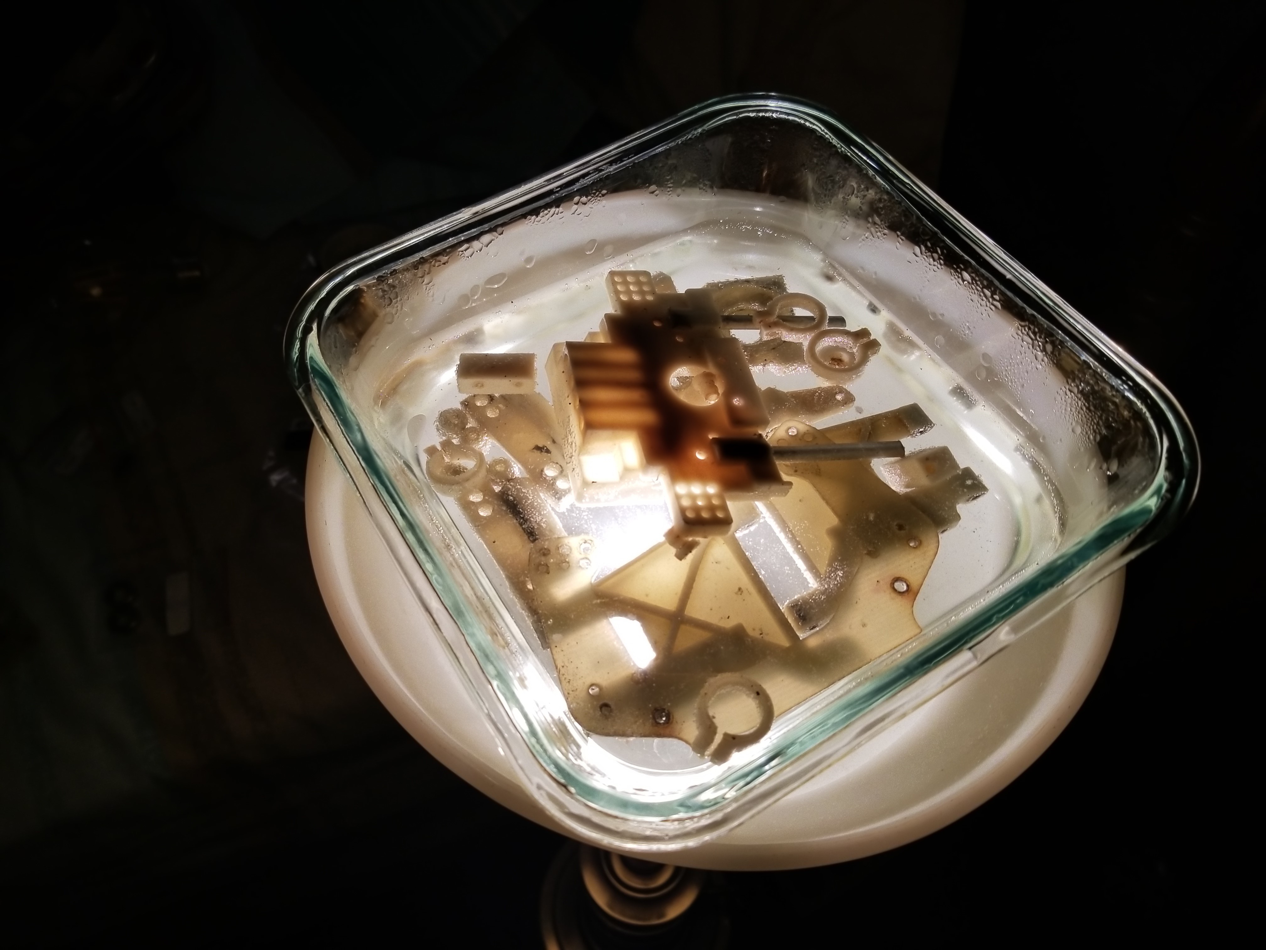

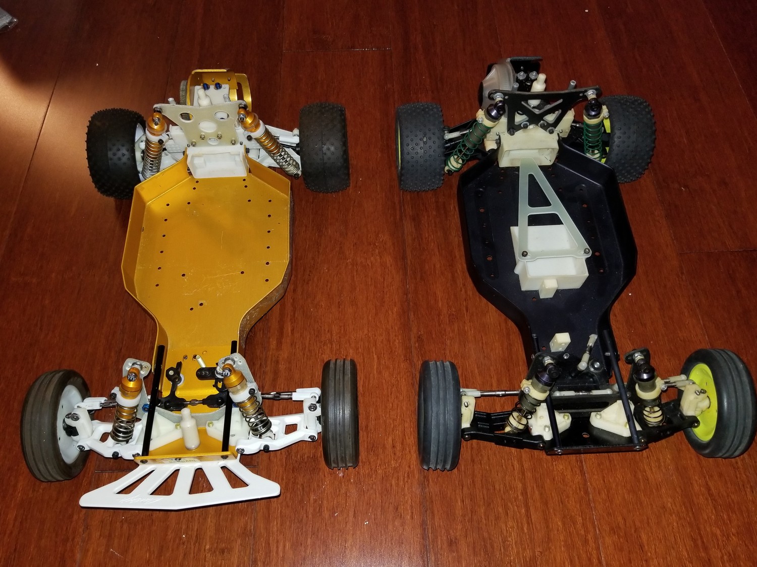

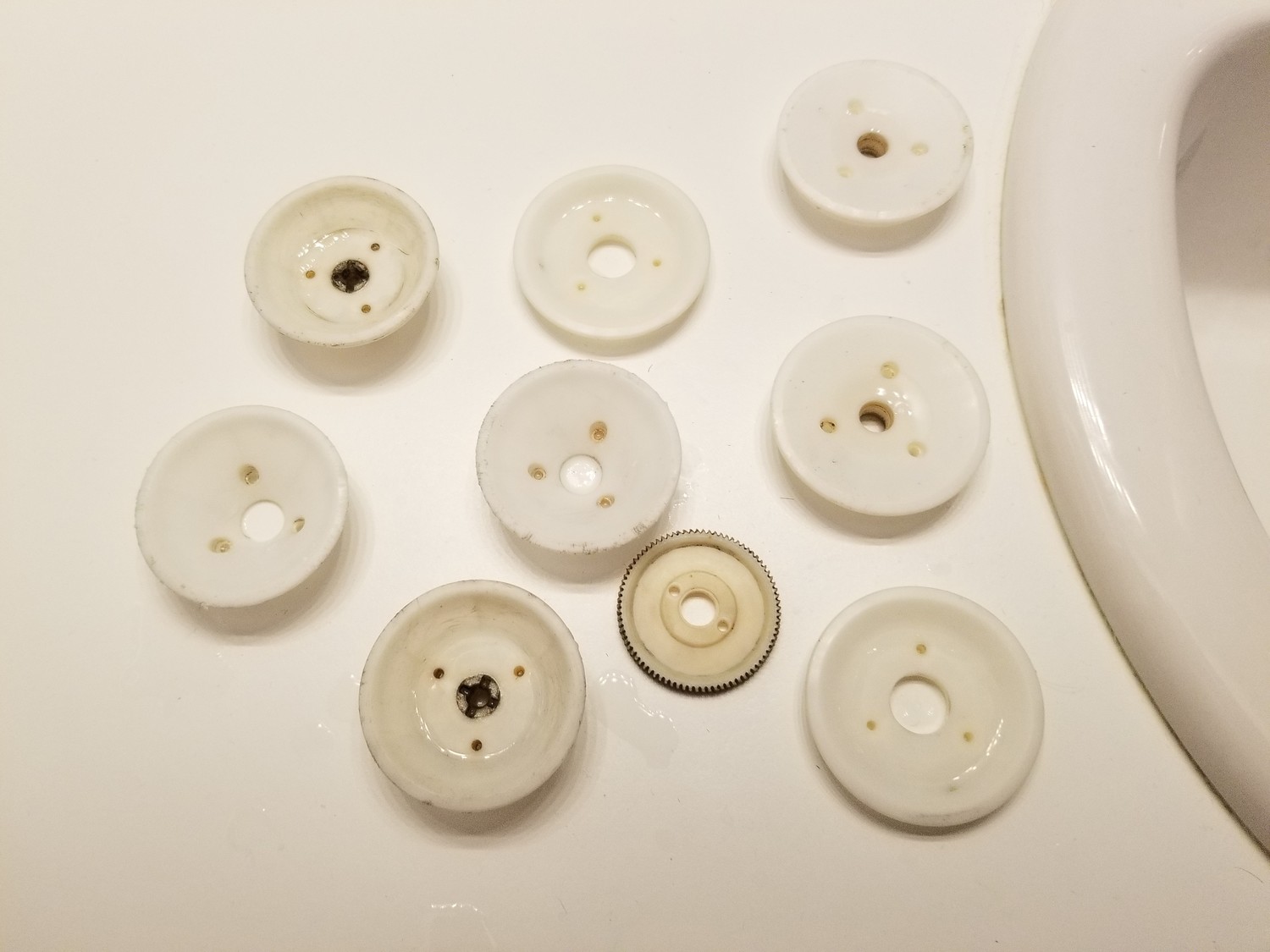

I tried this with my AE parts. Used a UVA light, incandescent. This is after ~16 hours. The gear is for comparison. I'm pretty pleased. They don't seem brittle or have their strength affected in any way.
I put them in a heat resistant glass over the light, and put a loosely fitted lid on. The peroxide got hot, but not boiling.
Ignore the Worlds Car, its untouched. The Andy's and RPM pieces are new, but all of the AE stuff other than the front suspension mounts is vintage and had this done to it.
