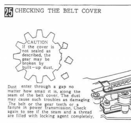

Based upon the directions in the manuals, the belt covers were so well servo-taped and their seams glue-sealed that they probably would break apart during a tear-down and often were not replaced. Or at least the thought of needing to buy new covers might discourage any future disassembly and cleaning. Perhaps this why two of the cheaper but well-used cars I've seen on ebay don't include any of their covers. I would expect the gear sets in those cars are probably shot; sorta like running a nitro car without an air filter.
I found this in the Mid Custom Special instruction manual. As I understand the timeline for these models, the Custom Special was the final Optima Mid version (experts please correct me here). Maybe by this time, owners had learned the hard way how important it is to keep debris from entering though the belts and their complaints prompted Kyosho to include this note.
- Attachments
- OMCS.jpg (52.59 KiB) Viewed 1159 times
- Coelacanth
- Posts: 7421
- Location: Alberta, Canada
- Been thanked: 325 times
Re: Finally---I Score an Optima Mid
That image almost reads like a disclaimer..."no matter how small a hole you have, this can cause the gears to break down...it's not OUR fault!"
When I did my mid-motor RWD conversion of the Turbo Optima Mid SE with my OptiMutt build, I totally sealed the rear gearbox. That's obviously not what I'm suggesting, but be sure to seal the Lexan belt guide covers, not just along the bottom edges, but all around where the covers surround the gearbox belt openings. I used silicone because it's more fool-proof; servo tape will dry out and pull up over time, and can't easily be applied around the belt openings. (This is for a runner; for a shelfer, none of this matters.)
