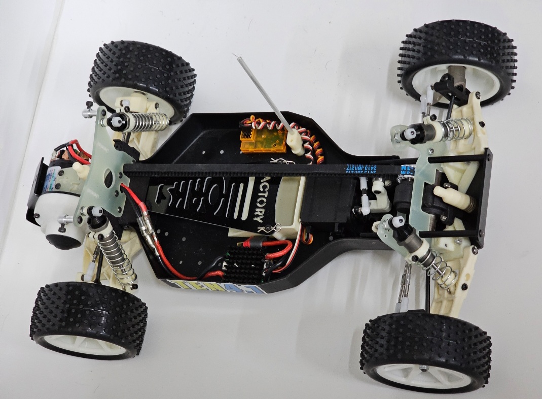

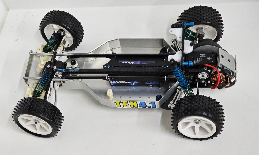

Made some updates to my original Ten4 project. Jeff helped with the conversion to use original tires. Added Factory works motor and using the cc chassis parts and screws. I installed Dhawk 3 piece wheels. Mostly silver and black with some gold. I haven’t finished tweaking the colors.

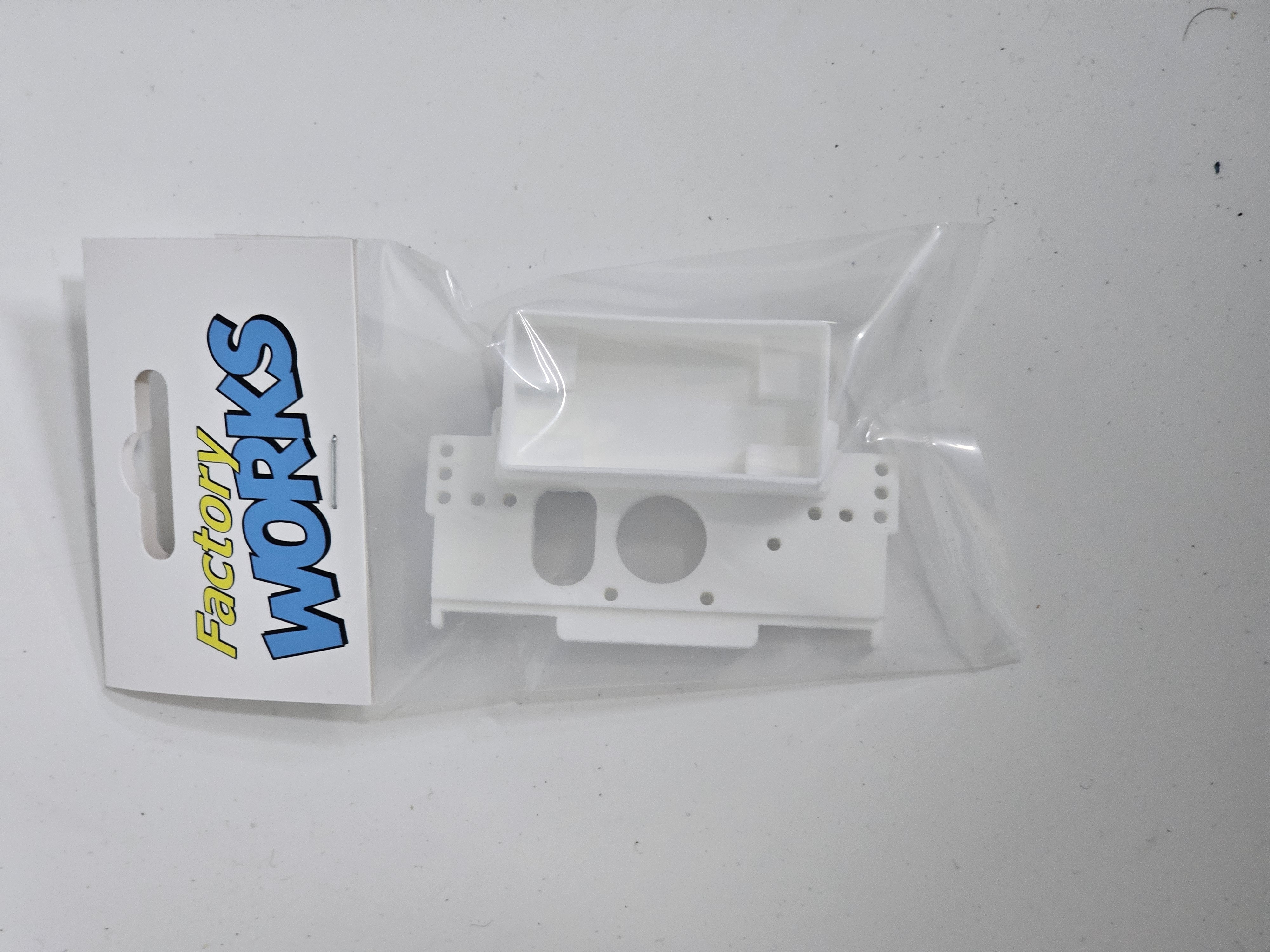

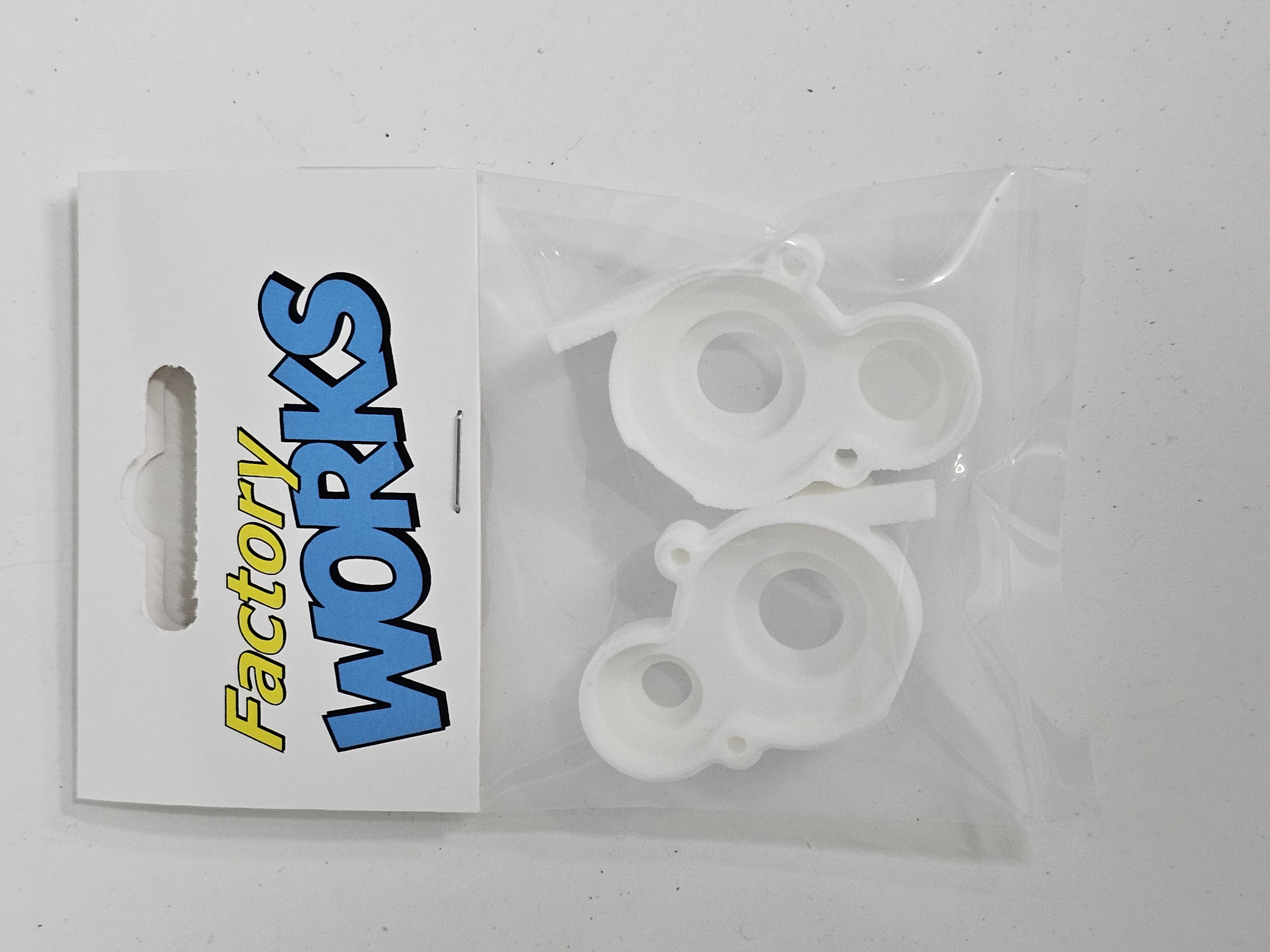

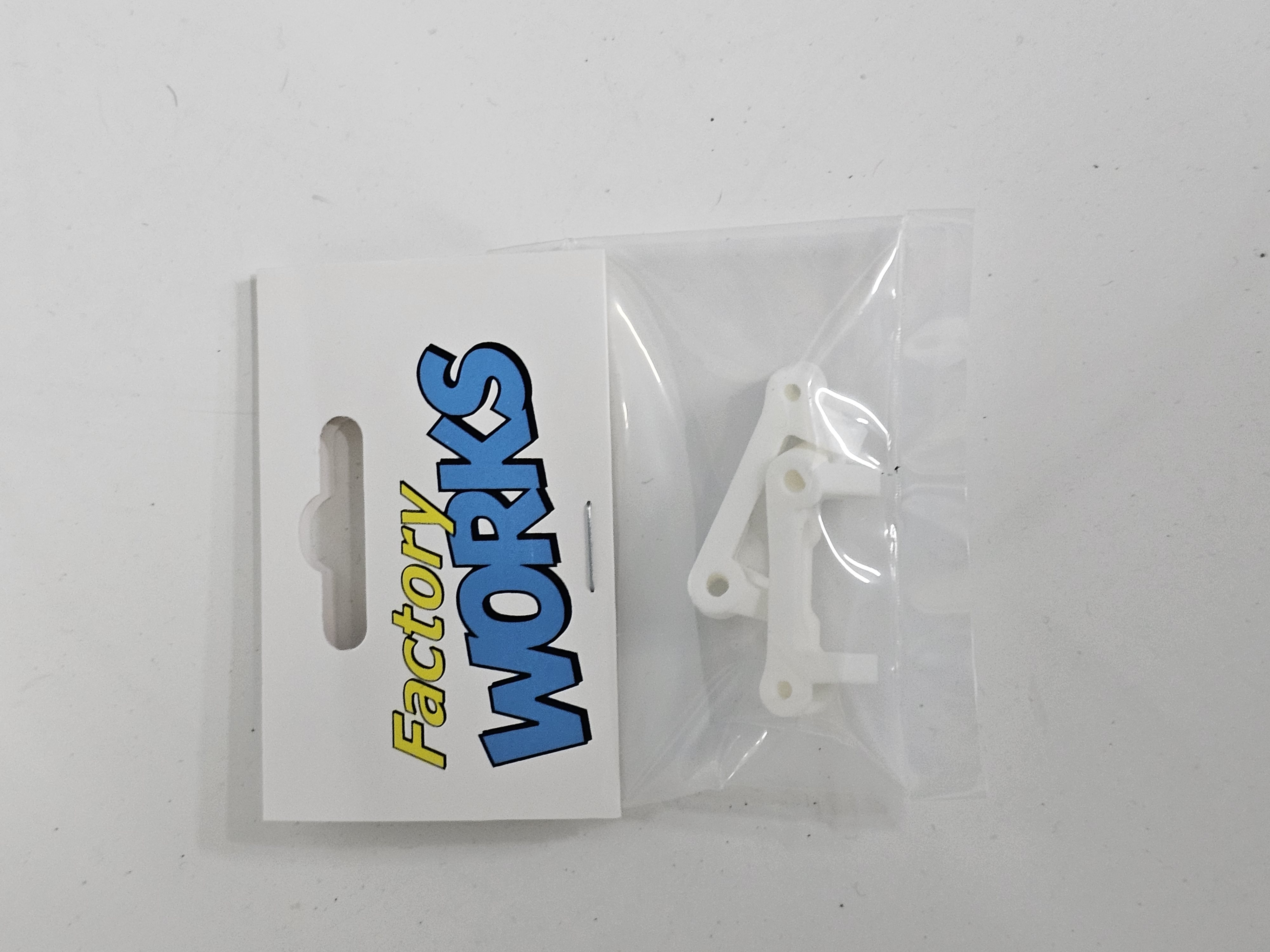

Several have asked about white parts. They are not as strong as the new pa12 black pieces, but it seems several are building cars for the shelf so I ordered in some white sla parts. I also added the front CVDs for short arm builds however they haven't arrived yet. The new platform won't require anything but the CVDs to use narrow arms now.
Still trying to get a checklist and instructions written up, but not getting far as I keep getting crazy orders that are consuming my time. Hopefully by next week we will have some documentation.

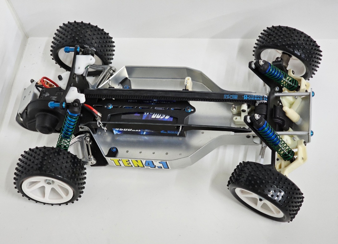

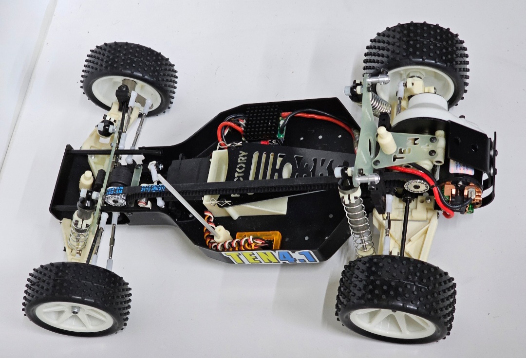

And some newer pics of the short and long arm cars with the new 18t pulleys

How much wider is the wide arm front end compared to the rear? Is the short arm setup more aligned with the rear width?
Posts: 12335
Been thanked: 3917 times
Re: Factory Works Ten4.1 project
I should clarify, when I say long arm I mean production long arms- the CE/Team/world's arms. Not RPM Worlds arms.
Using the same generic 4wd wheels here are my measurements
Short arm car
Front 240mm
Rear 250mm
Long arm car
Front 255mm
Rear 250mm
