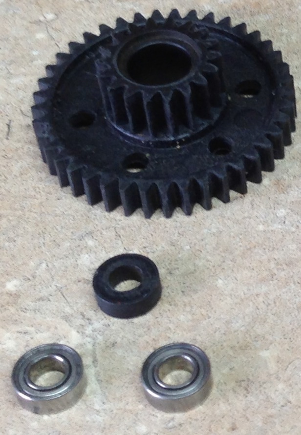

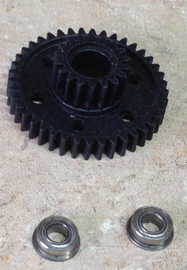

Have a question which may be of help to the thread starter, though apologies if its a hijack
The idler gear on the outside of the gearbox is meant to have two bearings and a spacer between the bearings
Is there any thing in particular that makes a good substitute for the spacer?
Posts: 12336
Been thanked: 3919 times
Re: Ultima project started: with no particular direction in
The original called for that spacer, one of my trannies had it- see pic. I remembered them being a white color but this one was black. The aftermarket bearing sets use a 4x8fl bearing on each side and loose the washer that goes on the inside.
The spacer is exactly the same dimension as a 4x8 bearing, so I personally would substitute it with another bearing

The spacer probably wouldn't be needed if you used flanged bearings, I'm guessing...?
