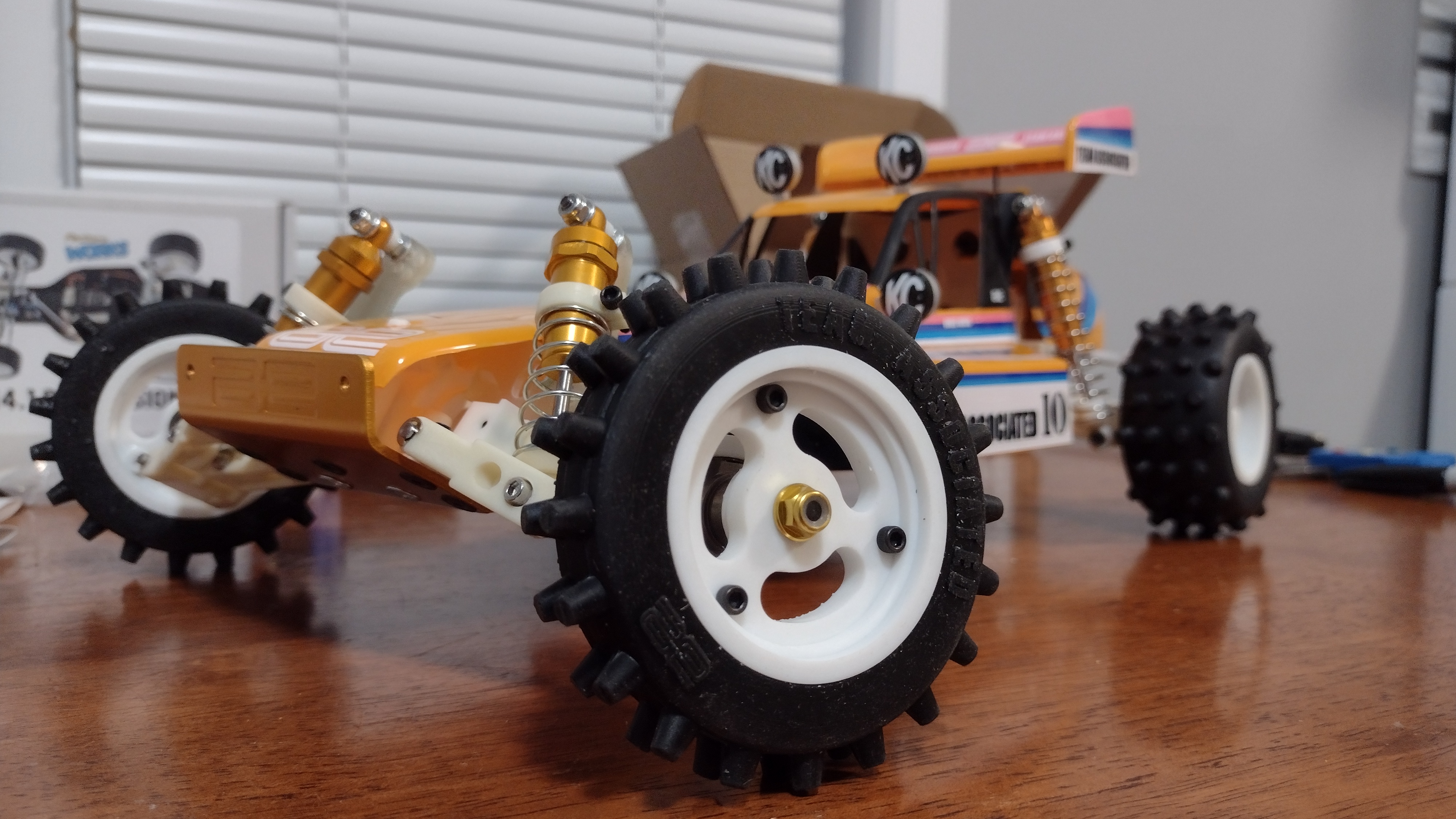

What are those awesome front tires?
mark
Posts: 140
Joined: Sat Oct 17, 2009 10:53 pm
Location: NB, Canada
Has thanked: 14 times
Been thanked: 90 times
Re: Factory Works Ten4.1 project
Post by mark »
Frankentruck wrote: Sat Sep 07, 2024 5:17 pm What are those awesome front tires?

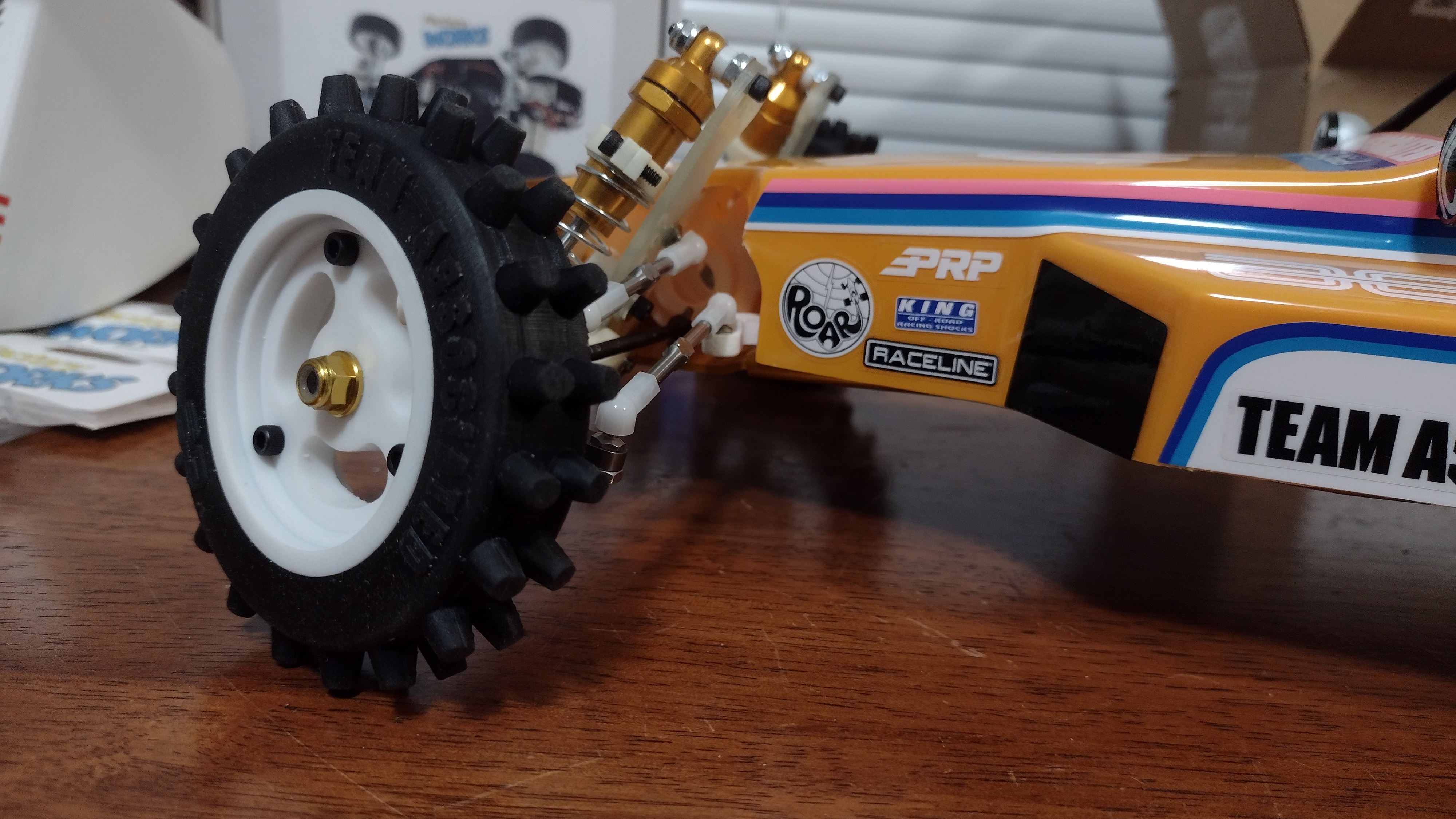

They are pretty cool aren't they? I really wanted to keep narrow fronts and original style wheels for a stock looking appearance while doing the 4wd conversion.
They are printed tires from mciracing.ca and they are awesome. They're my first time handling or seeing 3D printed tires and to my surprise the rubber compound is nice and soft. The outside facing sidewall of the tire is nice and smooth, the inside wall does have some dimples from the printing process but it's really not that bad and could be sanded out.
mciracing also modified his original styled front wheels with a 12mm hex and printed those as well, they look great and have a nice finish.

Thanks Jeff. The Ten4.1 kit is really awesome, the fitment of everything you would think it come from AE like that.
Yes I think you should offer some OG style fronts with the 12mm hex. MCIracing.ca designed and printed these ones for me and they are excellent, they are one piece. He also prints the tires.
