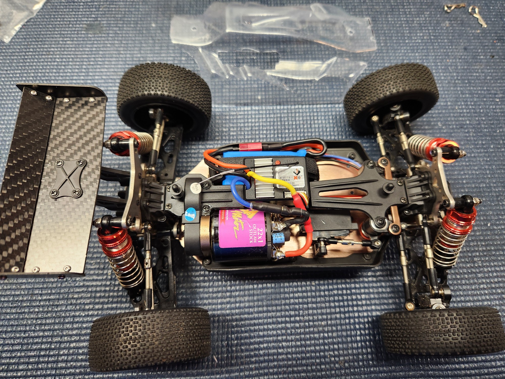

Re: WLToys 144001 at Walmart for $37! (back on sale!)
Was scrolling thru the boxes of motors. I'm wondering how perfect of a torque curve a 240ST or 22x1 Outlaw stock Mega motor will have.
Prolly real decent....I would be curious how that 240st will run in it
- R6cowboy
- Posts: 1484
- Location: Mendota, IL
- Has thanked: 872 times
- Been thanked: 904 times
If it's overkill, then I know I'm going in the right direction.
