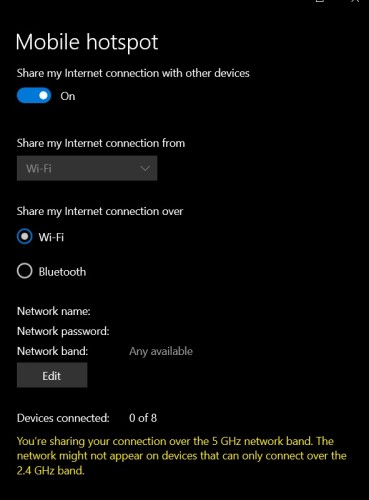

Anyway, I've enabled hotspot on my laptop but this is only for 5Ghz and I think printer is 2.4 - see note at the bottom of this screen shot...
Nothing happens; the display on the P1S hasn't changed. I've tried switching to lan only mode and restarted the printer but it does nothing. I still cannot update firmware or receive a pin code.

Thanks for your help. The info provided in your link mentions bluetooth so I have switched mobile hotspot from wifi to bluetooth but this has had no affect.
I've confirmed that printer is connected to my router - QR's are no longer displayed.

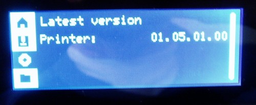

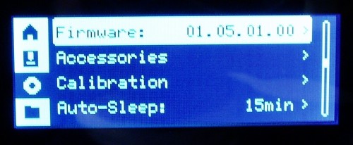

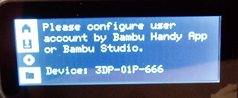

I have been sending Bambu support my printer screens so they will know which version is my firmware. So far, they have ignored my invitation to speak directly via a phone call and they don't seem interested in simply including with their email reply the firmware update file or a link so I can retrieve it from my laptop and update the printer via SD card. Without a file or link, I'm stuck with establishing an internet connection with the printer - which so far isn't working. I'm beginning to think the printer is defective.

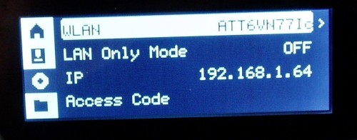

So, here is current status; printer screens:
Settings:
Account:
WLAN:
Firmware:

@XLR8 , did you download Bambu Studio already, and created an account already?
on the account screen you have the device name. Try to add this device name in Bambu Studio on Device page by click add
If this doesn't work :
On WLAN menu, what happen if you select access code? Is it possible to select access code?

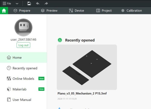

First, yes I have Studio version 1.09.07.52 and I believe it pulled my account info from Bambu Lab website (from when I ordered the printer a few weeks ago). Anyway, it shows I'm logged in but I don't recall ever setting up a new account after installing the software.
On WLAN, I'm unable to select Access Code - using down arrow key, it skips passed this.

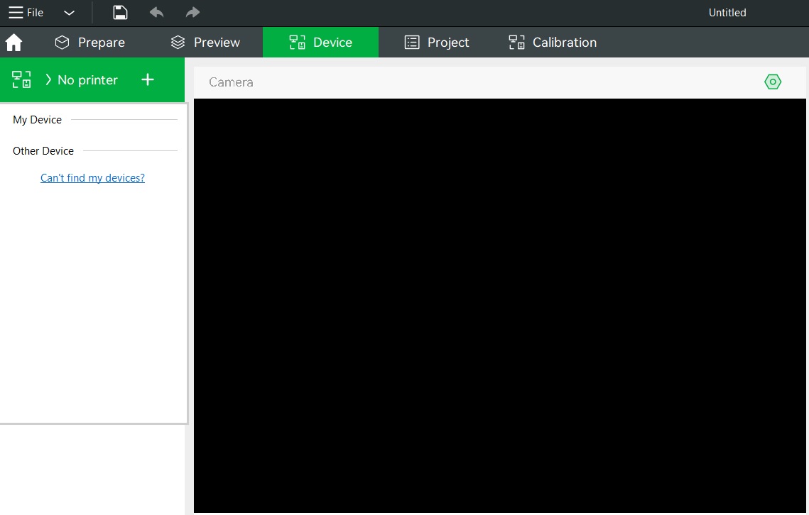

I have uninstalled Studio version 09, rebooted the computer and, using the link you have provided (thanks for that), I have installed version 08. The software has logged me in automatically after installation. On Device tab, My Device name is unselectable.
Rather than spending more time on this, I think we should wait for Bambu to reply tomorrow to my latest email. If this is successful, I will certainly post an update.

Did you try to click on the + next to no printer?
