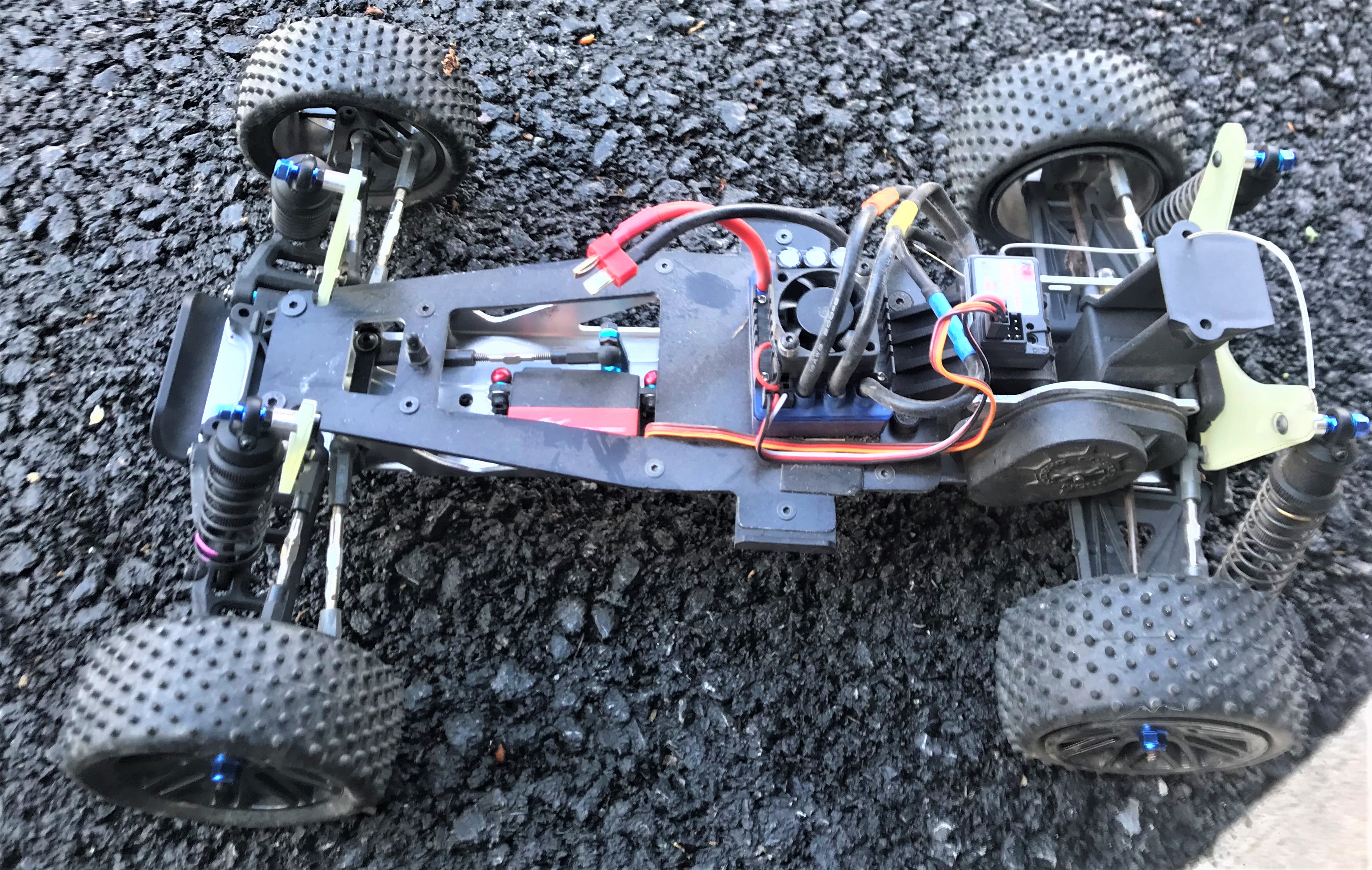

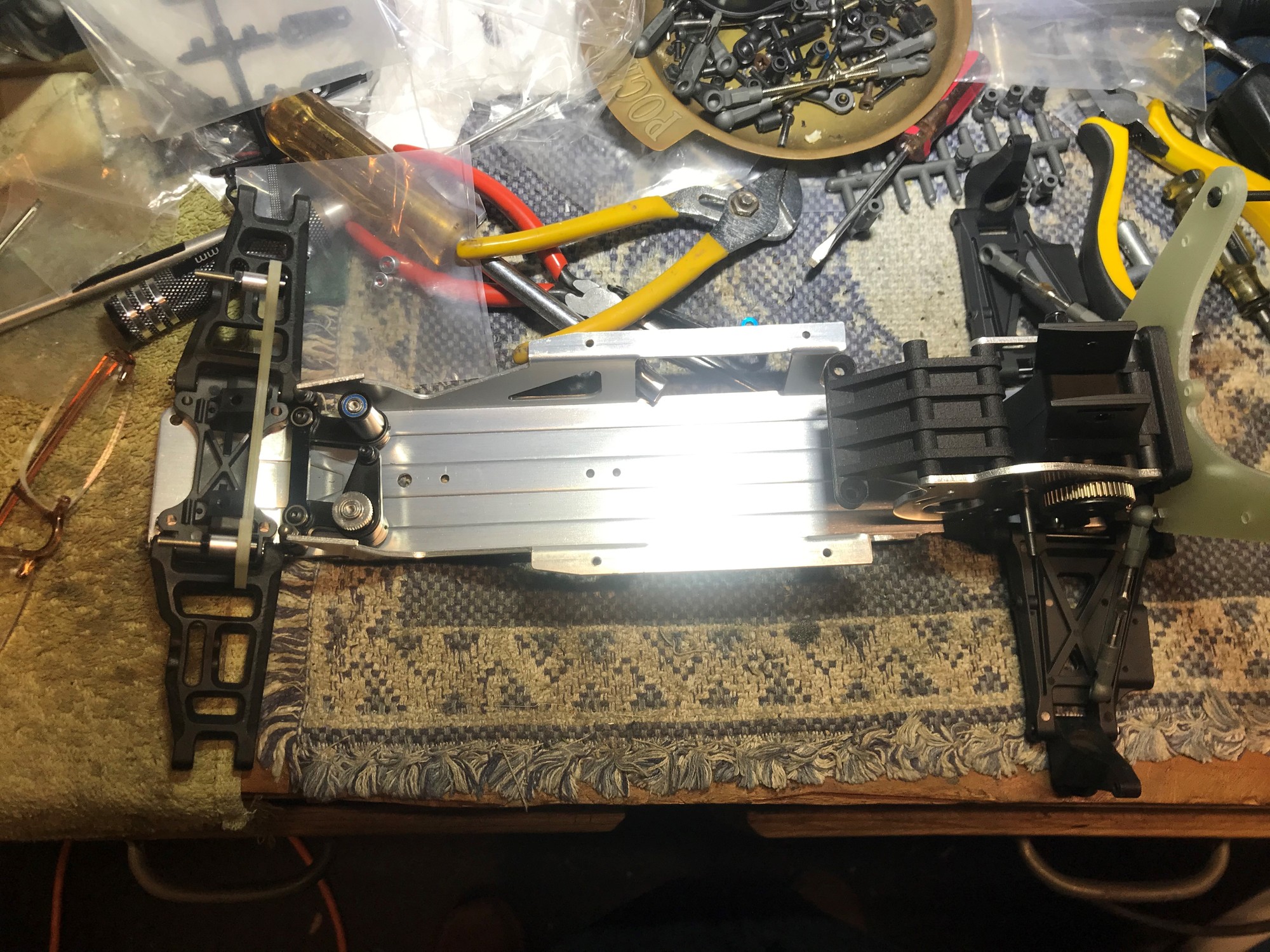

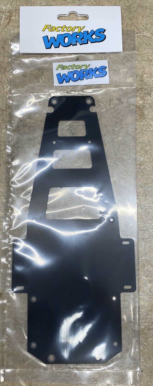

I recieved the new deck from Factory Works today . Looks like it will fit like a glove !
Sparbolt
Posts: 25
Joined: Sun Mar 14, 2021 2:29 pm
Location: Near Mt Pocono , PA
Been thanked: 11 times
Re: Kyosho Turbo Ultima MID MOTOR
Post by Sparbolt »
Here she is as a roller .....

Nice work! I'm interested to hear how it handles. You've turned a Turbo Ultima into a Mid RWD, while I turned a Turbo Optima Mid SE into a Mid RWD...different paths with the same destination. :mrgreen:
