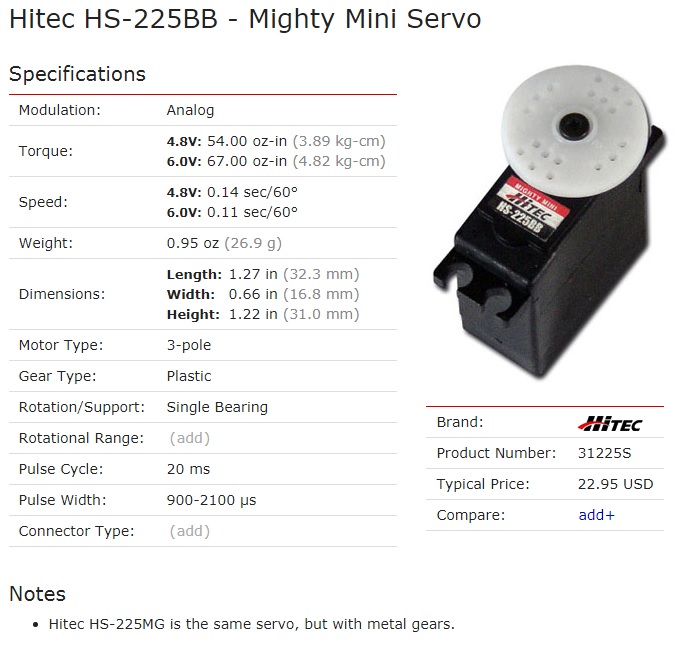

Having done more research, I think I will give this Hitec servo a try. For the price, it's small, light, fast, and strong. For comparison, my beloved S132H is 1.1 oz, 0.13 sec (@ 4.8v), and 25 oz-in. This plastic geared version is available from ebay for less than $20 shipped or Amain has the metal gear one for about $26. The plastic one is a little lighter and I'm pretty sure it can be retrofitted with metal gears should it become a problem. Plus, it's from a reputable manufacturer and it's analog so it will work with every radio system I have. What do ya'll think?

What kind of car will you be using this in? This looks appropriate for a pan car or similar, but might not last very long in an offroad car. If you do plan to use it offroad, I'd at least go for the metal gears now, or even a full size metal gear servo.XLR8 wrote: ↑Thu Jan 04, 2018 5:32 pm Having done more research, I think I will give this Hitec servo a try. For the price, it's small, light, fast, and strong. For comparison, my beloved S132H is 1.1 oz, 0.13 sec (@ 4.8v), and 25 oz-in. This plastic geared version is available from ebay for less than $20 shipped or Amain has the metal gear one for about $26. The plastic one is a little lighter and I'm pretty sure it can be retrofitted with metal gears should it become a problem. Plus, it's from a reputable manufacturer and it's analog so it will work with every radio system I have. What do ya'll think?

That's an excellent point Tim. It is a light-duty servo. I'm thinking of using it in 1/10th scale off-road buggies (that's what I'm into at the moment). I have metal gear servos in my heavier 4WD vehicles. I actually have never stripped a plastic geared servo in an off-road buggy (or any RC for that matter) but it makes sense to go with metal gears for every RC as insurance against a failure on the track during a race. One nice feature with this servo is you can order it either way or you can upgrade it from plastic to metal later if you wish. I feel pretty confident that I won't have a problem with the plastic gears but it's something to consider for anyone who might purchase this servo.
