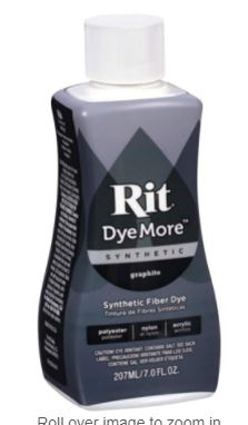

Dying with Rit Dye is the easiest method. You can always dye darker than what you have now. $2 Dye and about 30 minutes on the stovetop.

I believe Rit Dye More has been the dye of choice for most jobs.

Rit dye is only for nylon, correct? Well, maybe fiberglass too.

Definately fabric. Nylon and everything else is a bonus use.Frankentruck wrote: ↑Fri Aug 06, 2021 10:34 pm Rit dye is only for nylon, correct? Well, maybe fiberglass too.
EDIT:
Ah, I see your concern now, Frankentruck. Yes, if the parts are not nylon, the dye won't penetrate. I guess folks have also had success dying fiberglass parts although the procedures are a little different. Fiberglass takes a long time to accept the dye.

I do my dying in the two smaller pots of the four piece HFT SS stock pot set that I think is like $25 or $30. The largest one is actually a pretty good size for low country boils. I dye on the kitchen stovetop, and haven't had any issue. I bring the liquid to boil, lower the heat and add parts, simmer for 15-30 minutes until confident in the color. Rinse in SS colander under faucet.
I know there are plastics that don't accept dye well, but I haven't run into them yet. I just did my sprint car wheels last week without issue, and they are modern unknown plastic. Side note on that, RIT Graphite Grey is pretty darn much black.
