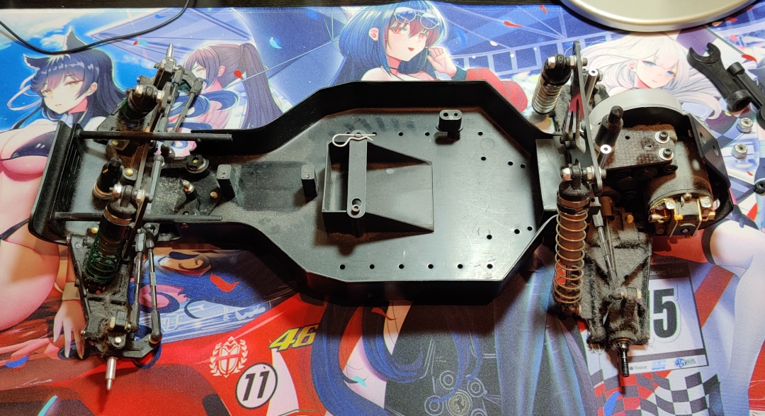

Hey guys! I moved into a new house earlier this year. Yay! RC stuff is almost done being unboxed. Lots of organizing going on now. Anyway, some of my cars and most of my projects have been boxed up for 2-3 years and are now seeing the light. One of my "finds" is this very dusty RC10 Team Car. When I last worked on it, I replaced all the fiberglass with carbon fiber bits and installed an RPM front bumper.
Anyways, what are we doing for wheels/tires now for these? Right now, there's some 1/4 cvds installed in the rear. I think I may have some 3/16 laying around someplace from previous builds. But is that still the shiz? It seems like everything is hex now. Would hex be better front/rear?

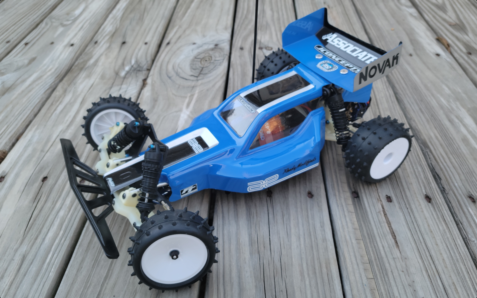

If you have the 3/16 stuff, you can use the JConcepts 2.2 wheels.
If you can't find them, you can use Factory Works rear hexes with Traxxas E-Revo wheels and the JConcepts in the front.
This is the Traxxas/JConcepts wheels.
If you want to do hex fronts, the B4.1 parts are getting harder to find. The Custom Works kit is about the most readily available thing.
