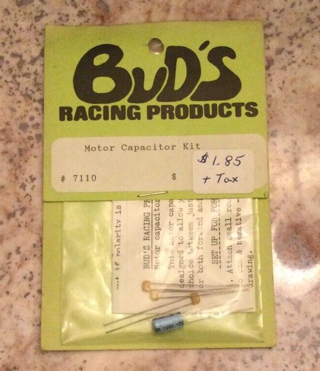

School me on the need and “how to” for a diode? Cap? Not sure what it’s called that was added to a brushed motor back in the day. I think it was to reduce radio interference? Still needed today?

Caps were used either in a pair or trio for motor noise. Not needed on modern radios. Shottkey diode was only used with forward only speed controls to assist with braking.

Not all motors required a Schottky unless it was mentioned in your esc manual. The caps (not diodes) were typically .1 uF ceramic disc and you used two. Some esc's wanted you to use 3. Some kits had an electrolytic or tantalum cap.
