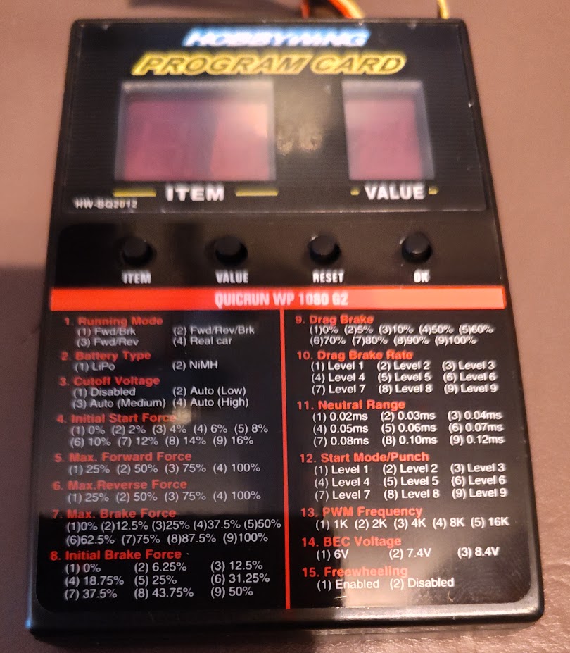

I've been trying out a Hobbywing Quicrun 1080 G2 and it's been pretty good so far. It's setup for crawling out of the box but there's a bunch of settings there that make it pretty good for racing too. Pic of my program card sticker to show the settings. It's definitely better than the cheaper 1060 units.

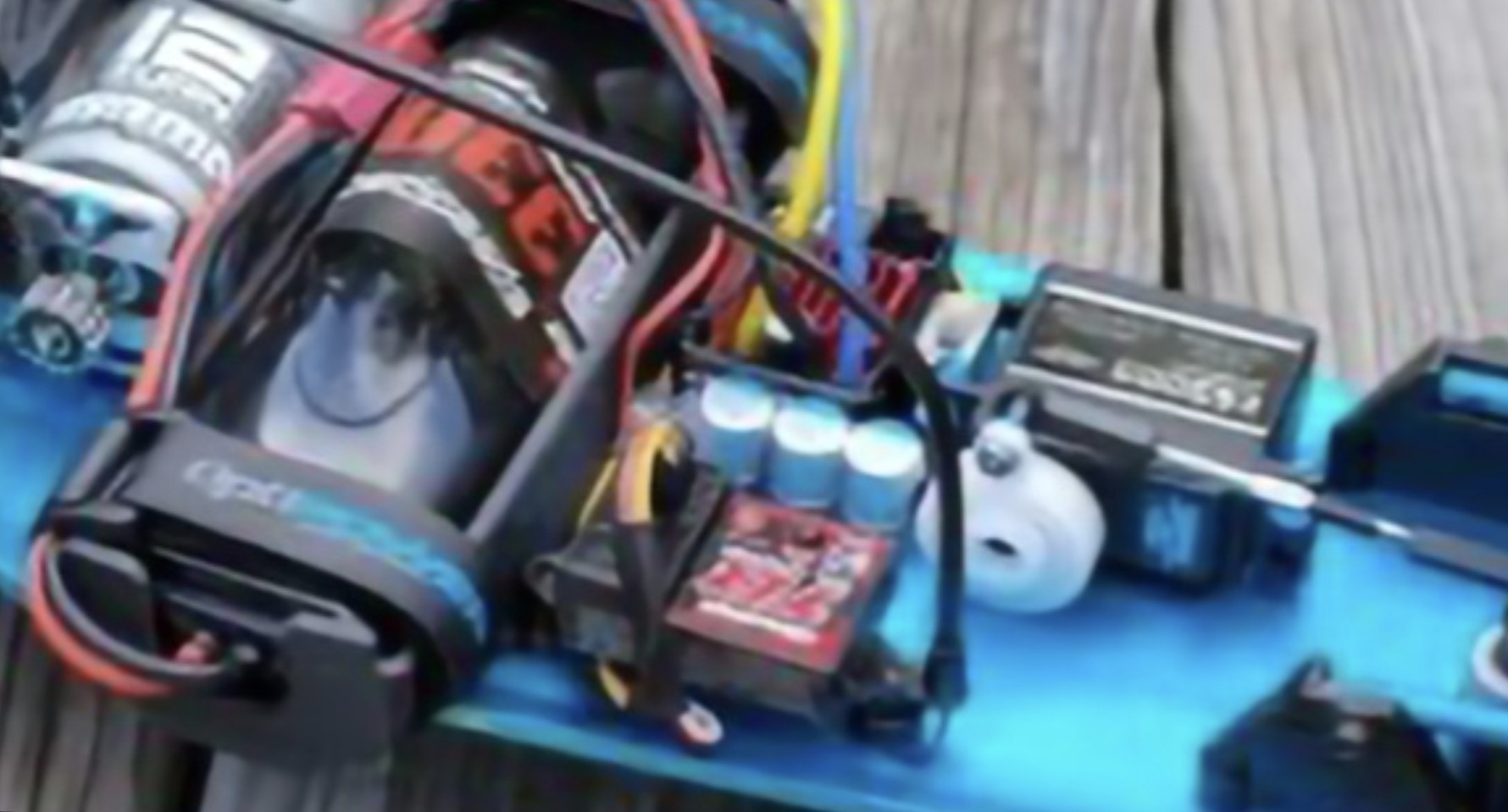

This is the 1060 in my E-GT conversion, with a three cap bank on the battery side. With a 12T 550 motor ( Arrma in the pic, open endbell Spektrum now), it has never had any problems.
I considered a single larger cap like Novak and Tekin used but that one was cheap enough and narrower.
