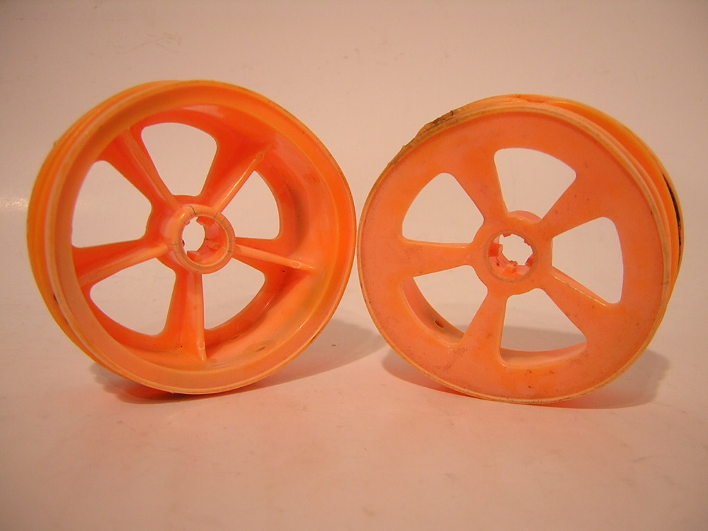

OH NO! Don't boil yokomo bulkhead caps!

I learned that one on a set of early JRX2 wheels :x

Oh you don't need to boil the peroxyde to rewhite the parts,
Only put in a closed bottle under the sun, 1 or 2 days according to the color you need...

prp wrote:Oh you don't need to boil the peroxyde to rewhite the parts,
After treatment you need to let the peroxide clear from the parts, i do this by boiling them afterwards to speed up the process. if you don't and you put them near anodized parts the peroxide vapors will remove the anodized finish.
It's a known issue.

Flush under the tap for about 10 minutes. That should be enough (at least, it was enough to remove the peroxyde from biological tissues at the lab some year ago when I did that :lol: ).

kink wrote:I once tried to dye some wheels black. I used a recommended product yet it turned out terrible. The white wheels ened up patchy dark blue / black. I decided there and then I would never trust any sort of dye again. I am only glad the wheels in question were not rare or expensive! No way I'll be boiling any plastic parts either! Way too dangerous for me.
Plastic parts shouldn't be boiled. Nylon is good to go, though. ;)

err.....well.....nylon is a plastic.
so you are OK to boil nylon, pure nylon, not a blend, as it has a higher melting point, and in fact can absorb water, helping to make it flexible. Other plastic blends and pure plastic types (such as ABS) have a lower melting point, which is the other popular injection molded toy/hobby plastic. These blends do not absorb water and will start deforming as evidenced above around 200 degrees (F).
