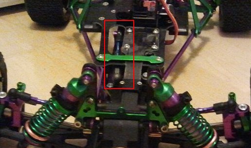

I bought some of those, they're actually a lot chunkier than the pics lead you to believe. Plastic/nylon open-ended ball-ends are significantly smaller and lower profile than those alloy ones. I have some Integy units similar to those; they have 3mm threaded holes on the ends but they're probably 6mm diameter on the outside. At least, if those are similar to the ones I bought, which were blue.turbo scorpion wrote:low profile rod ends like this with really low profile screw? along with metal or plastic substituted or fabricated part.
the one end has the ball pressed into a metal end... could allow you to use your existing tierods/solve clearance issues.
You need to have a very low-profile ball & socket setup for the Optima's steering servo and steering links, and the lowest profile solution I could come up with, that was also as strong as possible, was open-end Delrin ball-ends pressed onto 4.8mm hex-balls with most of the bases cut off. You need just enough of the ball and threaded part to be able to screw it in securely from underneath. Kyosho also makes low-profile 4.8mm ball studs, those are good too.
This image shows that you don't exactly have a lot of room with the Optima for upgraded linkage, either...this shows the Kyosho low-profile ball studs on bottom and the ball cups on top are popped onto cut-down hex-balls. You could slim it down even more by using open-end ball-ends but I wanted full cups for the Ackerman linkage to limit dirt getting into the sockets.
Here's another picture of upgraded Optima steering servo linkage, it's not the best pic but you can see how you really need low profile in this location. The stock setup just has a weak steel servo rod bent into a hole in the servo horn. I upgraded it with a 3mm titanium turnbuckle, open-end Delrin ball-end and cut-down 4.8mm hex ball, screwed on from the outside (left side) with a stainless steel hex-head screw that has a very flat head. Note that even though I'm using an aftermarket alloy servo horn that's at least twice as thick as a plain plastic one, it still has a very low profile.

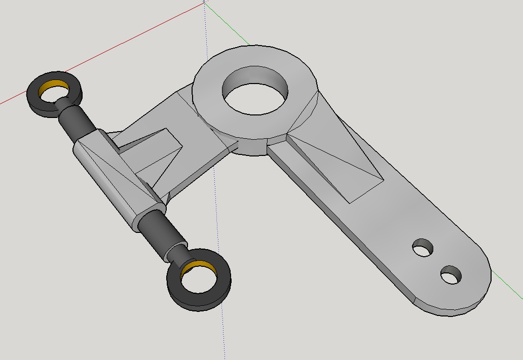

Dear All, this thread is old, I apologize to bring it up... but actually, having been looking around the web, it is the best subject on the matter ! So I would think it is good to continue with it and add more information or idea.
About me, just posted:
http://www.rc10talk.com/viewtopic.php?p=459627#p459627
Now, on the bellcrank case... since I have three Rocky at home, I am very much concerned about the weakness of this keypart. And the fact that replacement is simply impossible to find.
I clearly would like to investigate and find a simple and cost effective solution to all people having the same situation. My criteria are: not genuine is not a problem, but I would avoid altering any part of the original car (bodywork, parts around it...) to make a retro fit always possible if, one day, a new release of the original part would be made possible or if 3D printing will become so popular and easy in a few years, that my kids will just scan the broken part and print a serie of 50 in a laugh !
I will post once I find some, if I find some.
I was already considering what was suggested above: using a RC10 (funny that the reference is similar to the forum's same, just by coincidence) steering bell crank. Aluminium or not... at least first trying with the cheapest I can find and see how this part can be used.
Then, using this strong base, you can work "flat in line" to add anchor-balls on each side of this part and that should work.
Another option, obviously mentioned above, would simply be to go the pragmatic approach and decide to "print" a batch of 50 pieces and sell then "at cost" on Ebay. Pressing a button to get 50 more... I have no idea what the cost would be to have a 3D file printed professionnaly by a company using hi-grade and fine-quality parts... I will try that slowly.
Will keep this post updated.

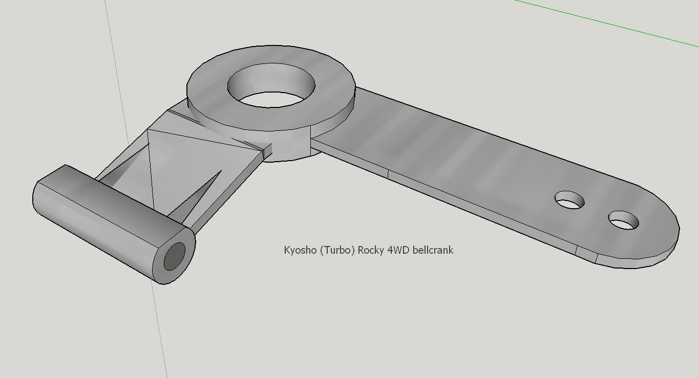

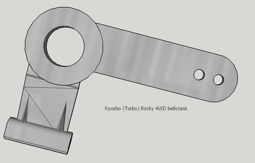

Rocky 4WD Kyosho (x3)
Re: Kyosho Rocky 4wd..... I think?
here is the more refined idea... the point is to create a solid bellcrank into which can be screwed basic / easy to find / cheap components.
With this version we get exactly the same rotating ability of the parts, rigidity increase without compromising the chassis.
I will try to refine this idea and send it to production.
