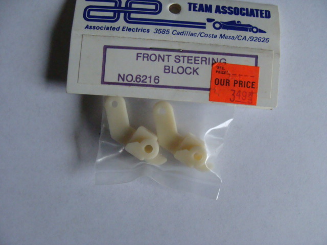

yeah like was said earlier the parts are ultra white, not what i remember putting together 20+ years ago, one of the most memorable "models" i built.. was looking though my race box and found front steering blocks NIP and not seen the light of day for at least that long.
But it sure makes me want to tear it down for a refresh
