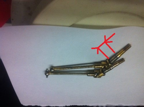

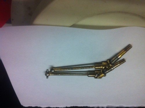

Sorry to bring up an old thread, but after reading, I realised I had a used set of these gold UJ's (see pic)
Could anyone tell me which Kyosho cars these were fitted to please? Apologies if answer is on one of the other pages.
Cheers
Cheers

I think the Rocky used those. Maybe they fit other cars too but I remember there was something different in the axle specs so they weren't an exact fit for a lot of other cars.

Going back to page 4 & 5 of this thread, it looks like the W5062 gold universals were mainly for the Turbo Rocky (the stock Rocky had dogbones & axles separately), and the Rocky has thicker wheels than the Optima series...so the axles are ~4mm longer. They'd work on an Optima but would require spacers, probably.

The axle lenght where the two 5*10mm bearing are (see picture below) is just a bit longer in gold universals (for *Rockey) than in black universals (for *Optima*). I had those gold universals installed in my some Optima based car BITD but I also installed some shim washers to take the play away.
Jirka
Jirka
