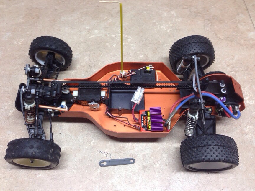

Posts: 12336
Been thanked: 3919 times
Re: Gomachv's 4wd RC10 project- IT RUNS (but still unnamed)
It runs :mrgreen:
Ne belt tensioner, I have only heard it skip a couple times but I'm only running a midnight stock motor and 6 cell pack, all old school. Feels ok, needs a lot of suspension work (not my strong point) but as a proof of concept.....it works!
Note: I swapped out the rear hubs and tires as the 2.2 were so tall it was under driving the front end. This is fairly square now.
This will most likely end up on eBay very soon. I have ideas to implement on a newer and more purple chassis

myfordcnc
Posts: 365
Joined: Wed Feb 20, 2013 5:10 am
Location: Stockton, CA.
Post by myfordcnc »
Sweet!! What are your plans/thoughts for the tensioner?
Posts: 12336
The belt needs to tension the top, and that creates a problem unless it's minimal. I'm going to play with it a bit first- but this is one thing I hope to overcome with a couple little tweaks on the next one
