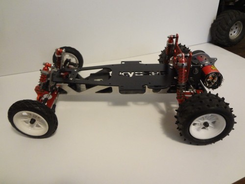

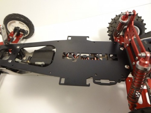

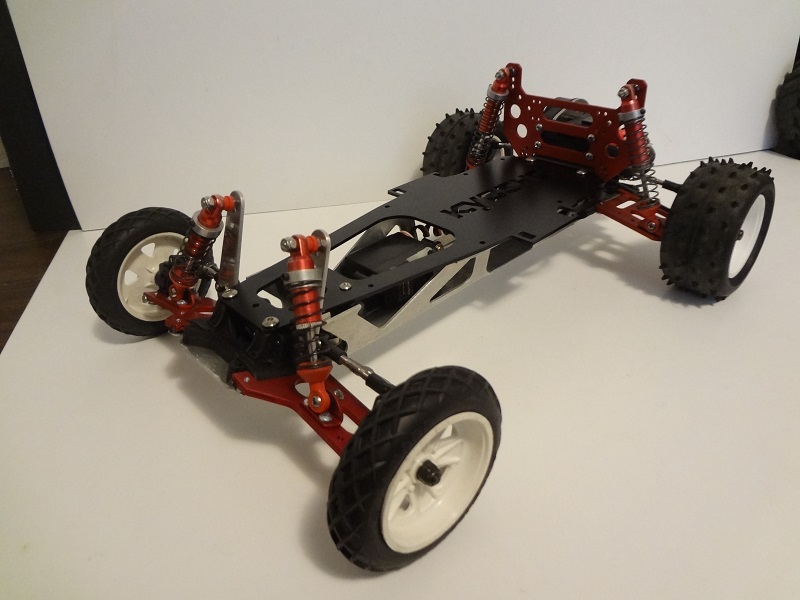

Ha - cool! Red and alum, love it
I'm digging the cosmo wheels too... on a cosmo
I think the offset looks a bit on the too-large side, maybe? Not too sure about the rear tires w/ block pattern to be honest... I guess we shall see when it's completed
Can't wait to see how this turns out

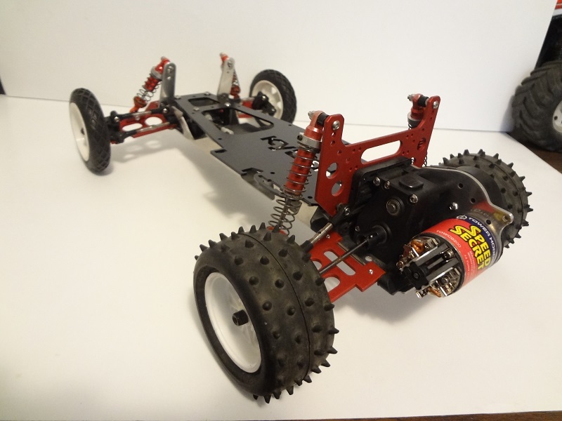

Update on the ultima project. Got a few more parts in the mail including the machined aluminum upper deck. Did some cleaning on it and put a tower hobbies "speed secret" motor. I don't think this is a high end brushed motor, but I had a brand new one laying around and I'm curious what kind of power a 14 turn quad motor has. I have a new body on the way from TBG and a new rollcage to top it off. Still have to decide what to do for the paint.

Beginning to look like a car, now!
Paint job? Red, white, black and silver, of course
14quad with lipo zips a vintage 2wd around pretty well. This is like a 11 or a 12 on nimh... I'd watch out for that transmission. It wasn't designed to be that sollicitated in 1987...
