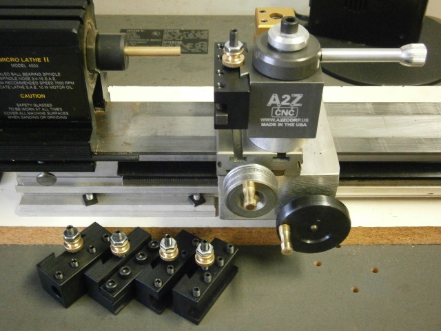

XLR8
Posts: 3318
Has thanked: 1684 times
Been thanked: 1180 times
Re: B1M RC10 Mid Motor Conversion
Post by XLR8 »
Well, my hat's off to you. I have one of the Micro Lathe II's; got it in the late '80's and it's manual as well. However, I've never achieved the results you have with yours. You obviously have some skill... and patience!
this is just a web photo; mine has a slightly different motor - and it's not nearly this clean.

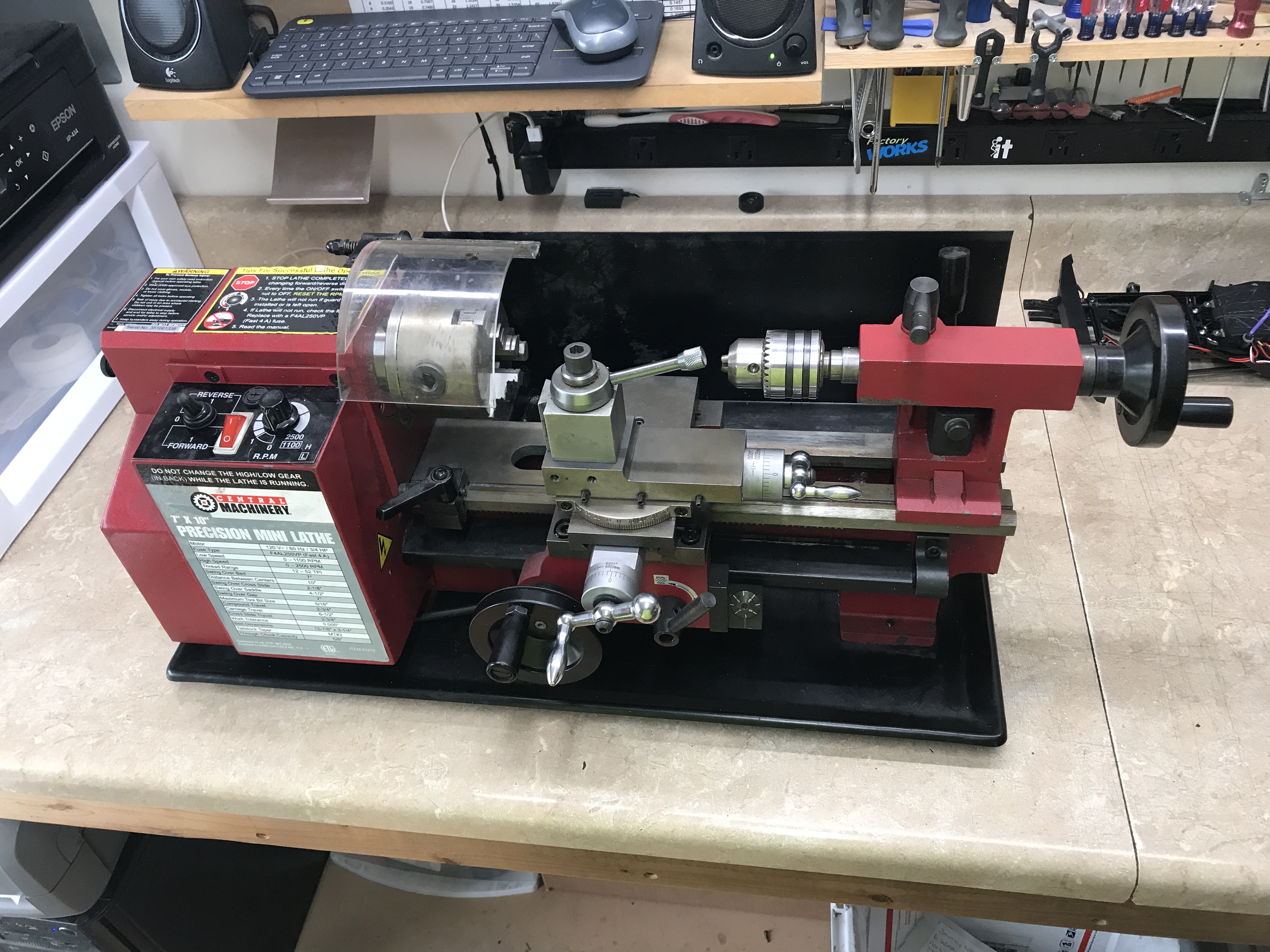

Posts: 12335
Been thanked: 3917 times
Harbor Freight baby :lol:
It’s a lot more precise than I am :mrgreen:
