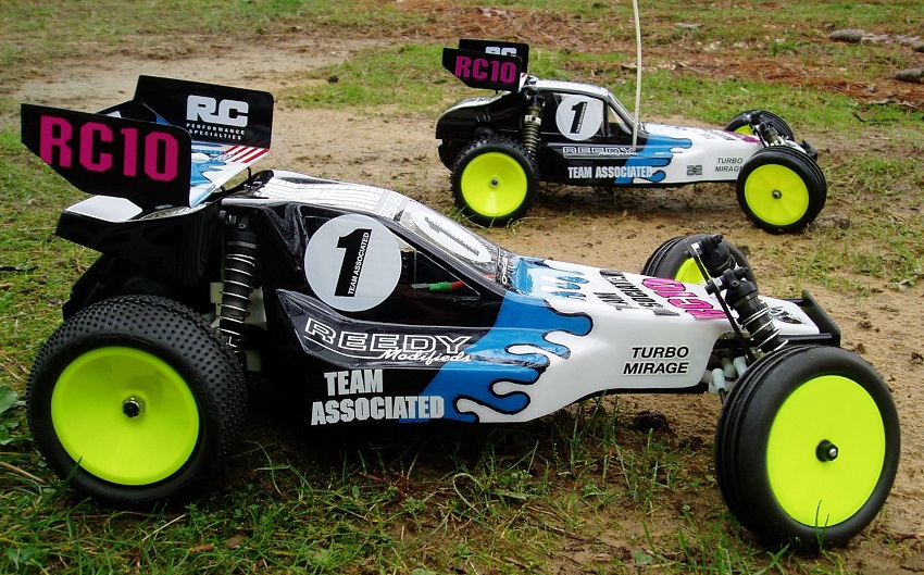

Pic showing the wheels. My old point and shoot camera has been acting a bit strange, fuzz pics. I'll try a new card or retire it.
I have an AE Protech body, will see if that will suit me...

Yip, looks great! I really like the wheels. Is it just the photo or is that wing really BIG? Should provide lots of down-force.
Anyway, everything looks fantastic.

XLR8 - Thanks for posting the body pics. I'll get a Mirage before I get to cutting any Lexan. Yes, it's a big wing

Just an observation, the JC Racing wheels are designed for the original front axles, not the re-re worlds extended axles. It appears the front may be a bit wide. They may 'swing' front front wheels/tires instead of rotating them.

I was going to say that something looked wrong with those axles. Anyway, stunning car! Initially I wasn't sold on the red transmission case but you made it work, it looks really good.

Is there a fix for that? Really want to be able to use these wheels.

Yeah just the old school axles- 6220’s
If you can’t find those, 6220b is the blue version

Wow, Jeff... I was just coming back here to ask if those would work!

Gee Nomad, it's too bad you don't know someone who has a lathe and some titanium rod. Ti front axles would be very cool!!!

I almost told him to turn his down, but the thread would be a problem, even with a bushing they would stick out pretty far
