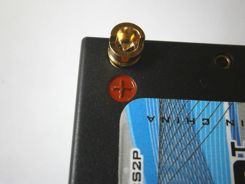

You could paint the positive end/side of the battery red. I see that a lot.

+1 on the paint. I do that with all my lipo batteries. Another tip has to do with the leads/wires from the ESC to the battery. I make the positive wire just long enough to reach it's socket. That way, it can't reach the negative side of the battery.

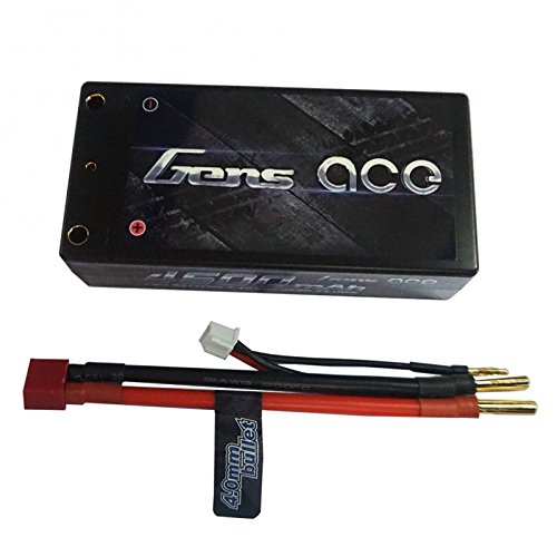

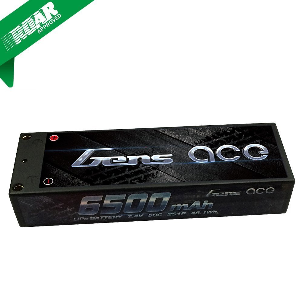

See if you can spot the difference in the two Gens Ace batteries I use...
Otherwise, the shortening the one wire would have worked

Wow that’s pretty annoying especially since they could have just flipped one of em over haha!

Some of the newer shorty, 5mm post lipo's have tubes that go all the way through the case. This let's you use both sides, putting the positive where you want. Something to keep in mind, and pay particular attention too.

That’s how one of mine is and I like that ideaNomadRacer wrote: ↑Wed Dec 13, 2017 7:10 pm Some of the newer shorty, 5mm post lipo's have tubes that go all the way through the case. This let's you use both sides, putting the positive where you want. Something to keep in mind, and pay particular attention too.
