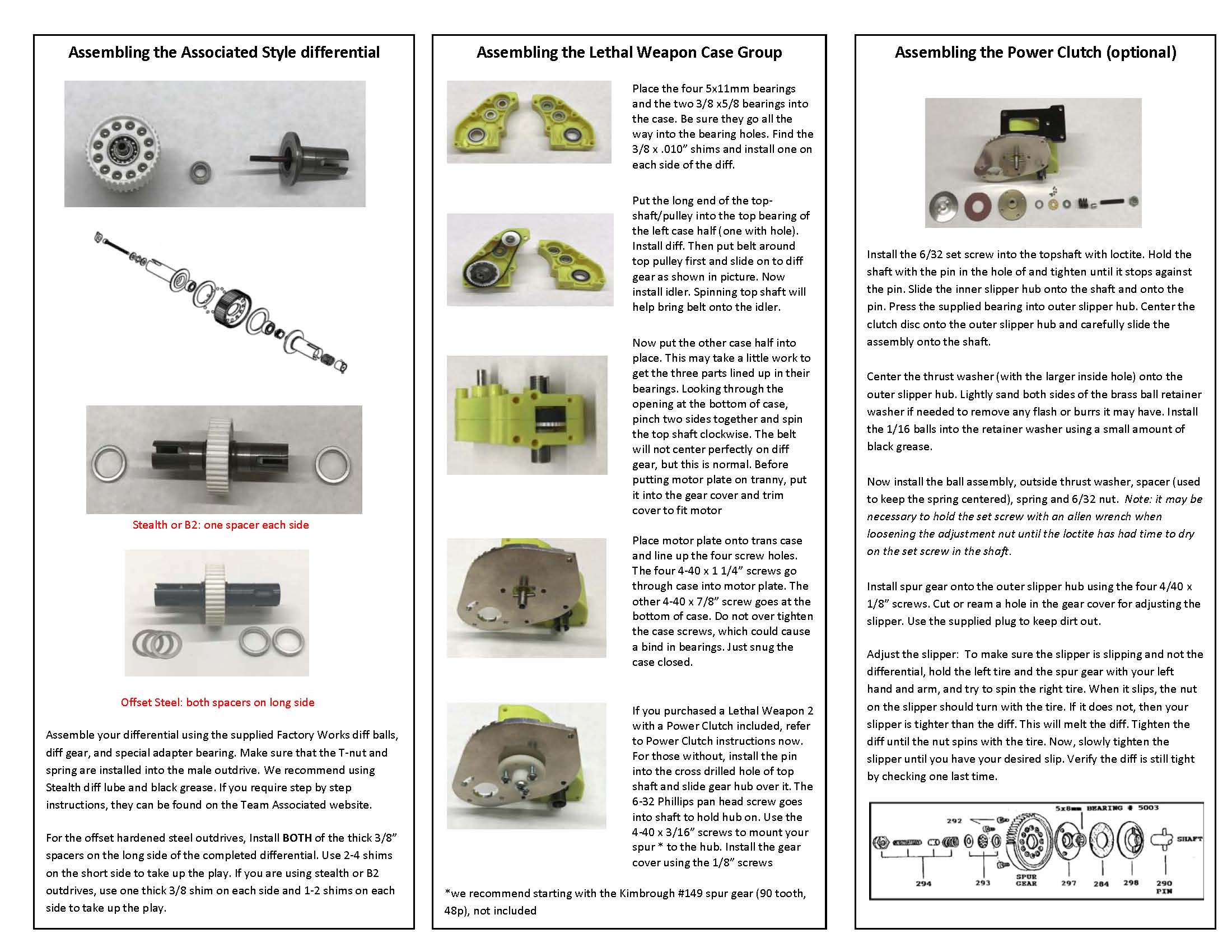

I want to use it for drifting so giving it a drift theme. Any tips or mod that you guys recommend for the rc10ds i am all ears since this is my first one. I also purchase this transmission mainly for the cool factor I never seen a belt drive transmission for the rc10, but i have no idea of which part i need to finish it so any help in that is appreciated.

You can get with GoMachV here on the forum for all the internals for the Lethal Weapon transmission you have. Great guy to deal with!

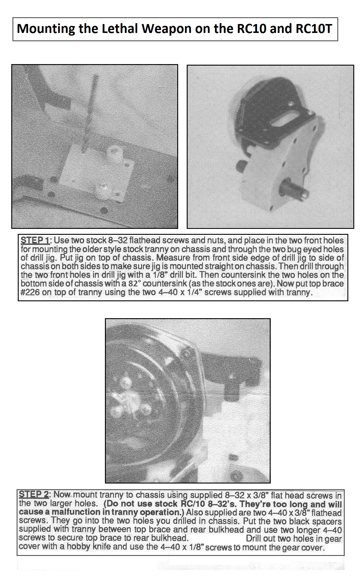

Sadly most of that trans is missing. You would need a gear set with shaft, a complete power clutch, and a B3 differential set, as well as bearings, spacers, motor plate, screw set, drill jig, and a trans brace

Thank you for info and pics GoMachV. Just order some parts for the ds and just a quick question but is there any cad drawing of the rc10 tub out there?
