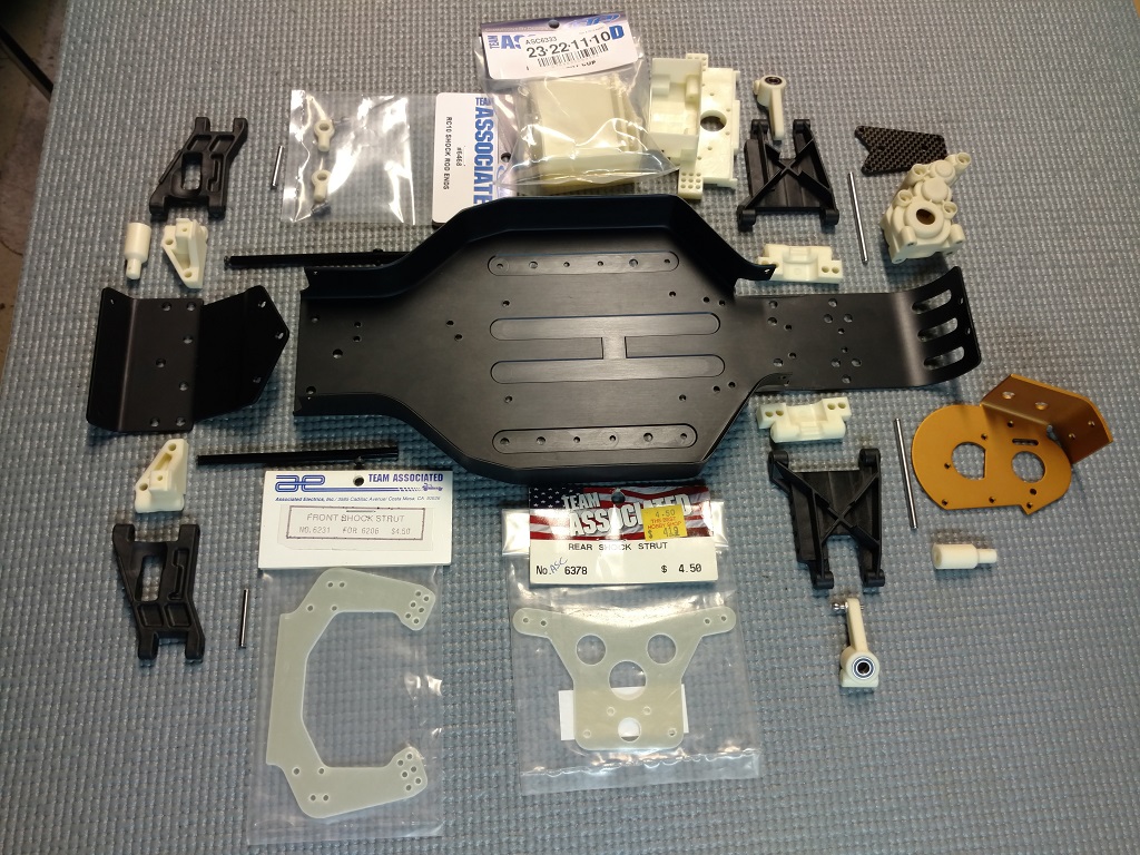

And here is my starting pile of parts. This is a slightly older pic. I do have a black motor plate now, and I got a set of the Lunsford turnbuckles already. A couple other bits and pieces are on the way. But the big ticket items will be shocks and trans parts (if they ever become available again). :roll:

What trans parts are in need of? I have a NIP #6565 trans case.

Basically all of the diff components (outdrives, rings, etc.), top shaft, slipper and so on. I have extras of both case versions.

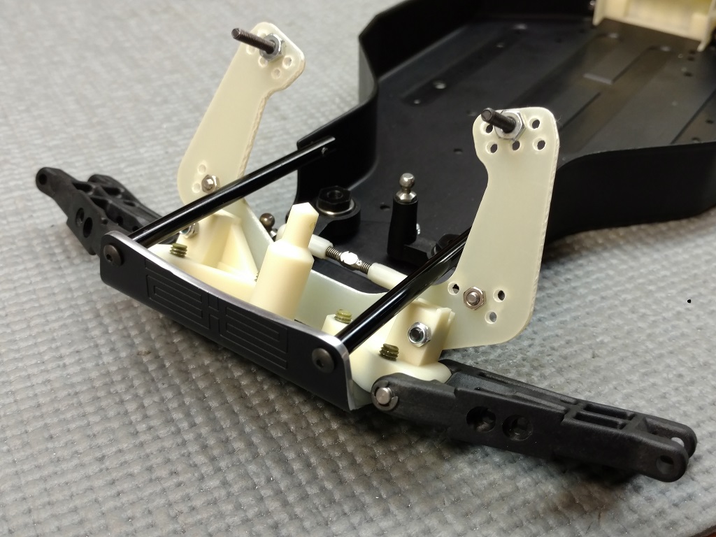

Got the nose tubes shortened for this, and got the tub mods done. I stole the motor plate from the '94 build so i could finish it up, so i gotta do another for that one. Now...... on to the nose plate.

Got the nose finished up.
Then I figured.... since I'm kinda held up on the '94 build, I robbed more parts off of it to move this one along. :lol:

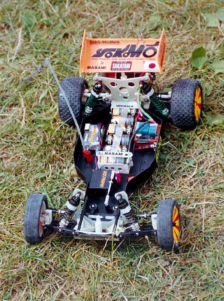

You can sort of see it in the above pic. But, you can really see it in this pic from the JMRCA win.

A little tidbit on the rear there.......
When I was building my '93 Kinwald rere, Brad Reelfs had asked if I was going to bend the rear of the chassis up. He explained that there was a section of the track where drivers kept tail tapping on landing and upsetting the cars. So he thinks it was Roger Curtis that went around and bent the rear section of the tubs up on everyone's cars behind the rear arm mounts to gain more clearance. Now on Kinwalds car, he left the chassis alone and just drilled a new hole higher up in the motor plate. Masami drilled a new hole lower in the tub and removed material.
Kinwald's....
I would say there's a good chance the rear chassis plate on the b2 was bent upwards at the back because of a jump at the '93 Worlds.
