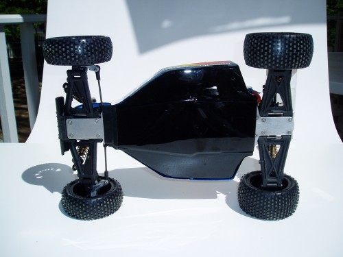

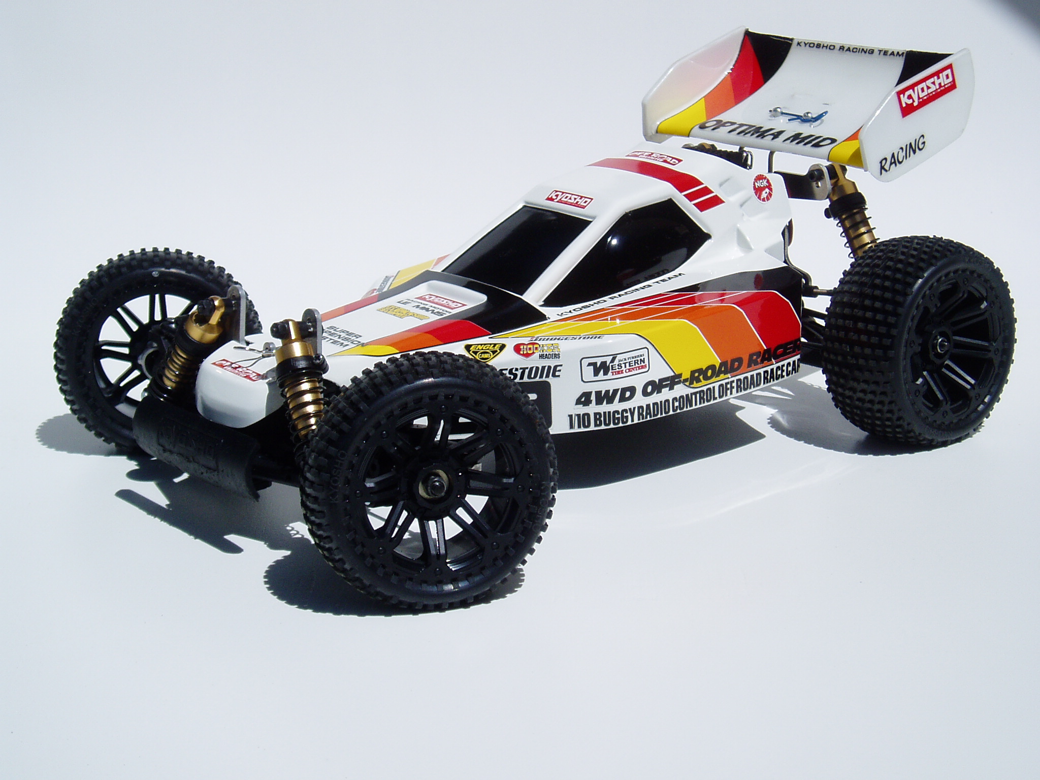

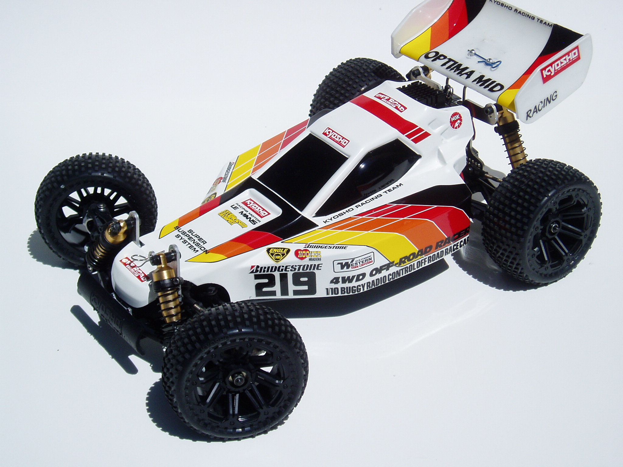

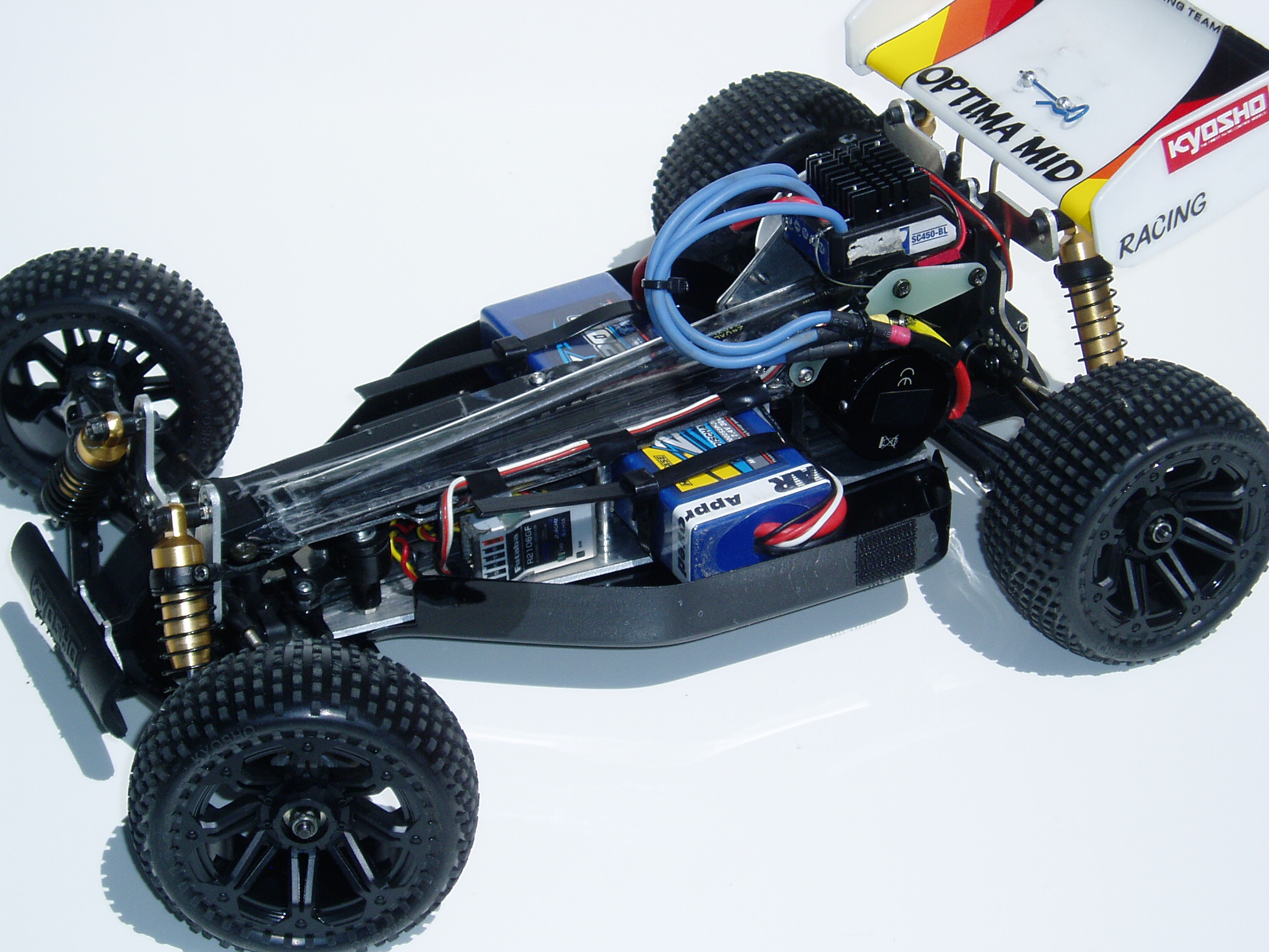

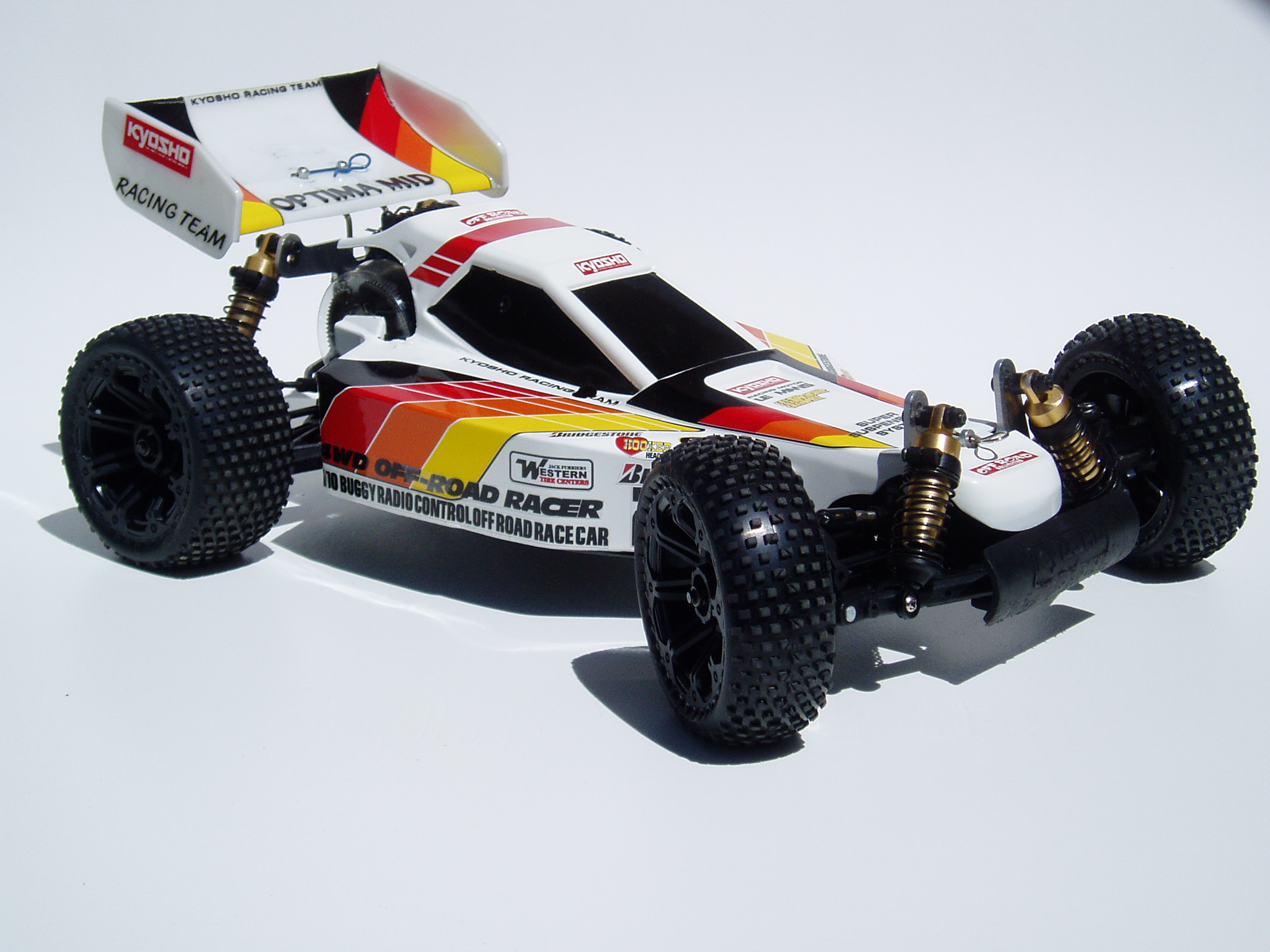

Just wrapped up this Optima Mid runner and thought I’d share some pics before getting it dirty at the track. I’ve spent the last few months collecting some OM parts cars and spares from ebay and I’ve nearly enough parts to build two SE’s (future shelfers) and this Mid runner (the runner used the most well-worn and ragged of all parts on hand). One of the SE’s are nearly completed, and I may post some pics of that car in the gallery when the body and decals arrive and the body is finished. Meanwhile, this one is ready to roll. The drive train includes an aftermarket steel idler gear (from ?) and an original diff gear, top drive gear and belt that were still in good shape (did belts ever actually wear, stretch or otherwise fail with these cars?). I replaced the original dog bones and axles with the Kyosho re-released versions (the new axles use pinned hexes rather than the tapered drive hexes) and the wheels and tires are also from Kyosho. The only Mid body I have was pretty badly scratched, beat-up was painted blue and the paint was heavily scratched as well. Initially, I’d planned to run it as-is but then decided to investigate the possibility of stripping the old paint to re-apply a little nicer vintage style paint job. Apparently, from what I've read, removing paint from lexan doesn’t always work well so I ultimately decided to just clean up the body, paint the outside and apply a box-art decal set from MCI. So, after thoroughly cleaning the lexan and trimming the ragged edges, a light coat of Pactra polycarbonate white paint was applied as a primer for the three coats of white gloss Krylon epoxy enamel. I’ve had good results in the past applying enamel over poly paint (enamel paint seems to adhere well to poly paint but not directly to lexan).

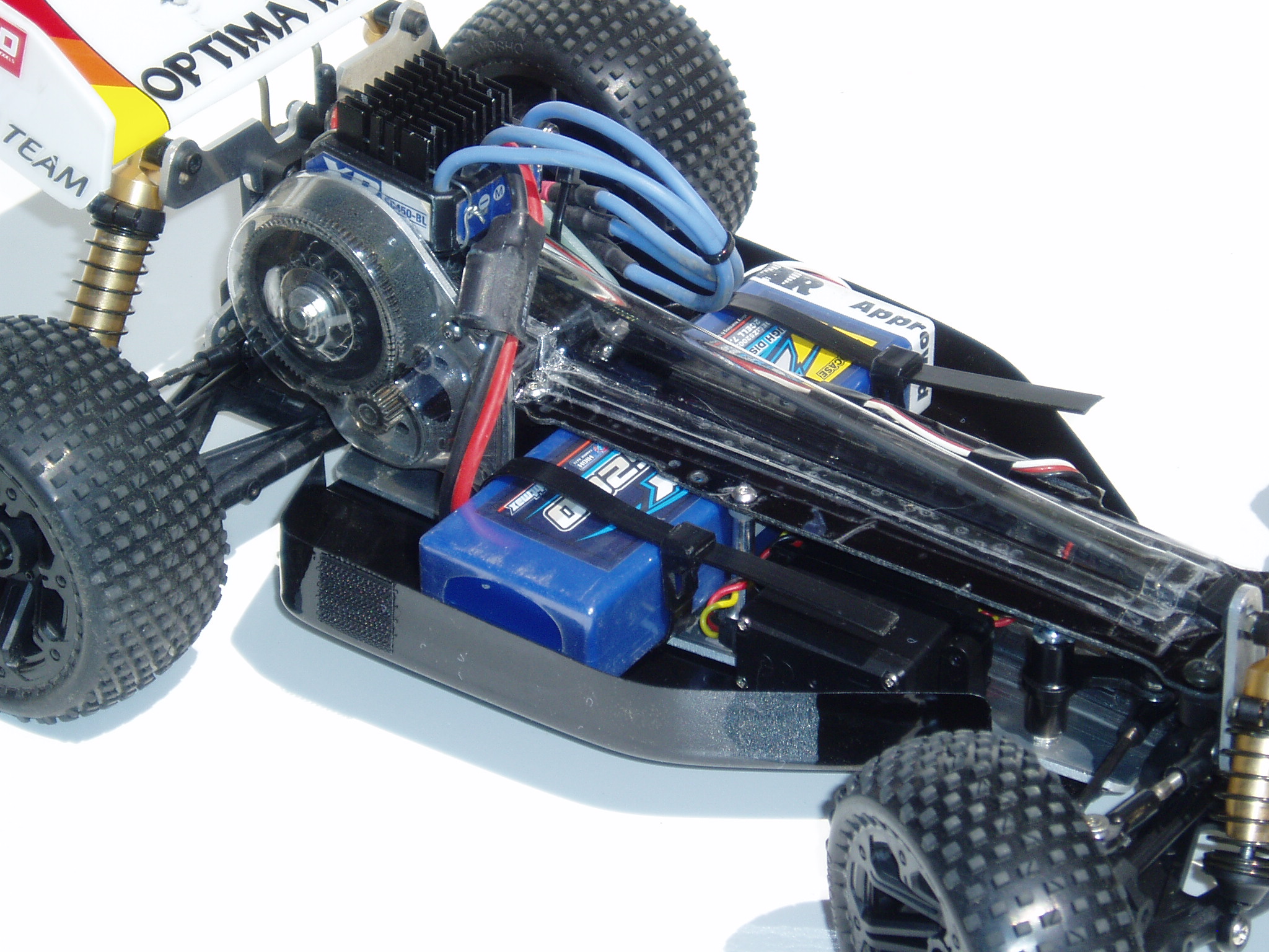

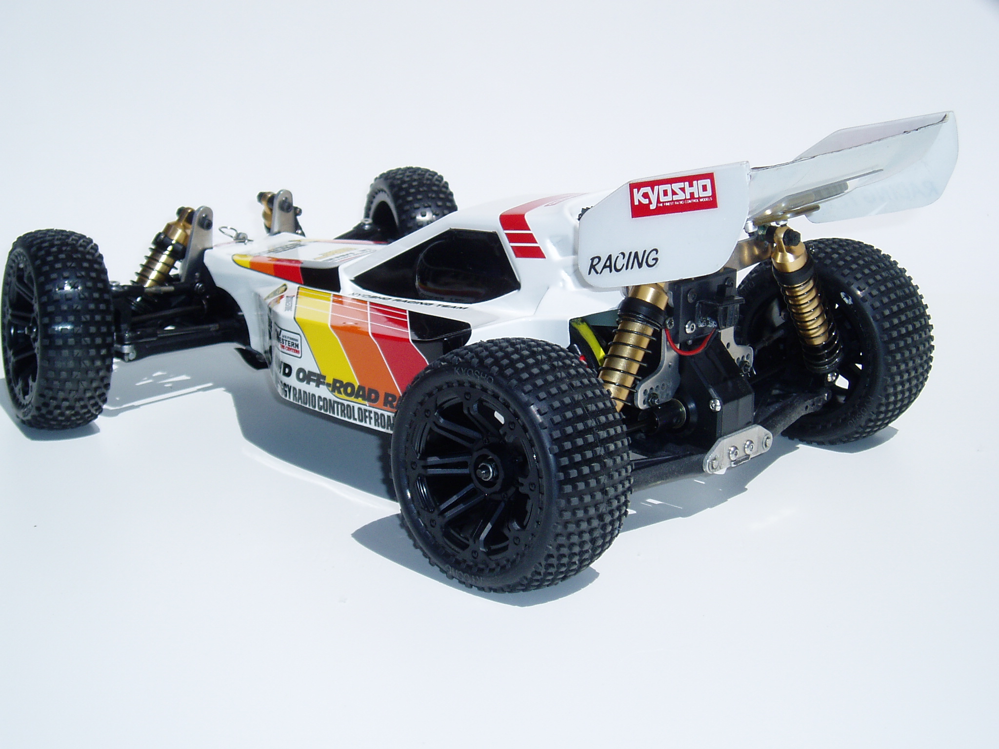

The rear suspension assembly is reversed, locating the shocks behind the arms, to ease access to the motor and spur gear. The wing mounts on this car had been broken-off the trans cases but I was able to mount the wing to the shock and camber plates using some good ole Yankee ingenuity; a piece of Kydex, some wing wire and scratch-made wing buttons. The Kydex plate seemed like a good place to mount the ESC’s switch.
The Belt and Gear covers and undertray are from Team Blue Groove. Most of the old Philips head screws were replaced with 3mm stainless hex machine screws that remained from some other projects. The chassis plate screw holes were countersunk to accept flat head screws so they wouldn’t interfere with the undertray.
The electronics are just some odds and ends scavenged from vehicles that I don’t run anymore. The motor is a Reedy 550-SL 3500kv, ESC is an Associated XP SC450-BL, servo is Hitec HS-645MG, and receiver is from Futaba. I’m a little worried about running that 550 motor with a light 45amp ESC but I will attach a fan to the ESC’s heat sink and hope for the best. I will run only 2s, the car is pretty light and gearing is very conservative so maybe it will be okay.

XLR8 wrote: Wed May 09, 2018 11:59 pm ... and this Mid runner (the runner used the most well-worn and ragged of all parts on hand). ... The only Mid body I have was pretty badly scratched, beat-up was painted blue and the paint was heavily scratched as well.
Still looks better than 95% of my builds. :lol: Nice looking buggy!
XLR8 wrote: Wed May 09, 2018 11:59 pm Anyway, I’m really looking forward to getting this car on the track. Should be good fun. :D
I'm sure it will be! Enjoy! :D

Exceptional build, my friend! Really dig those wheels. 8)

Thanks Matt and Nomad. The body turned out better than expected. In fact, I'm starting to consider the same exterior paint process for some other old beat up bodies I have but no longer run because they're just too ugly.

Very nice build, I also like your choice of wheels.

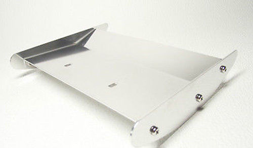

Yeah, Nomad, I think the wing I was thinking of were made by Thorp. It's made from just say 0.030" aluminum sheet stock. Anyway, they were banned at the tracks because the didn't want to issue leather gloves to turn marshals. I don't have turn marshals at my track so no worries there. I do have some 0-80 sst socket head cap screws but no nuts to go with them. I could undersize the hole and let the screw make its own threads. Aluminum is pretty soft so that may work. Anyway, thanks for the tip; no rivets in the wing.

This is the sort of lacerater I had in mind for the Javelin. Although, taking a fresh look at this again, there are lots of interesting designs out there. Maybe I'll change my mind and go with something else.
