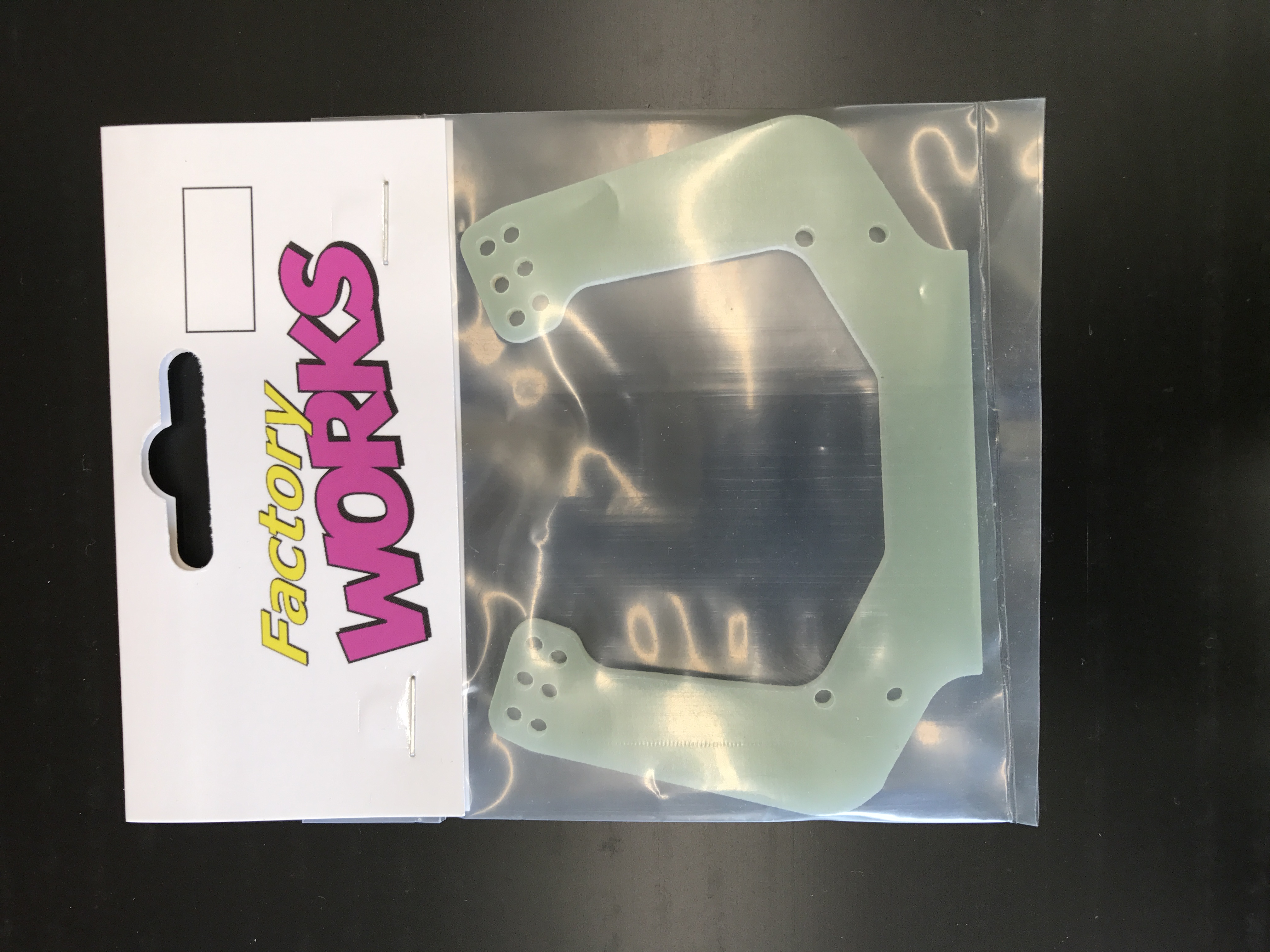

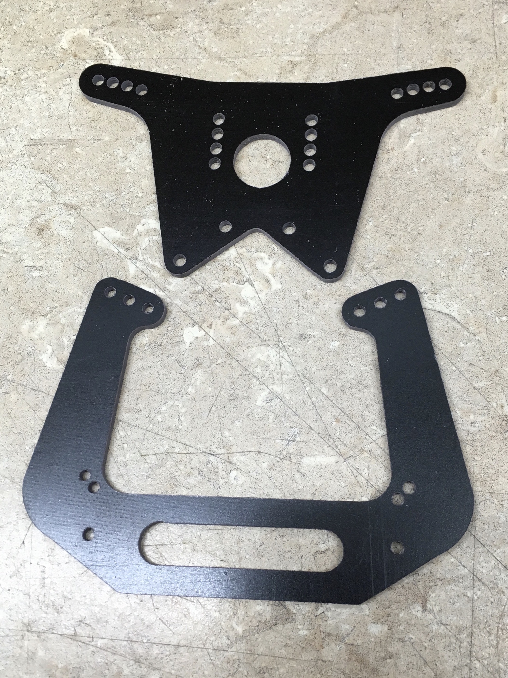

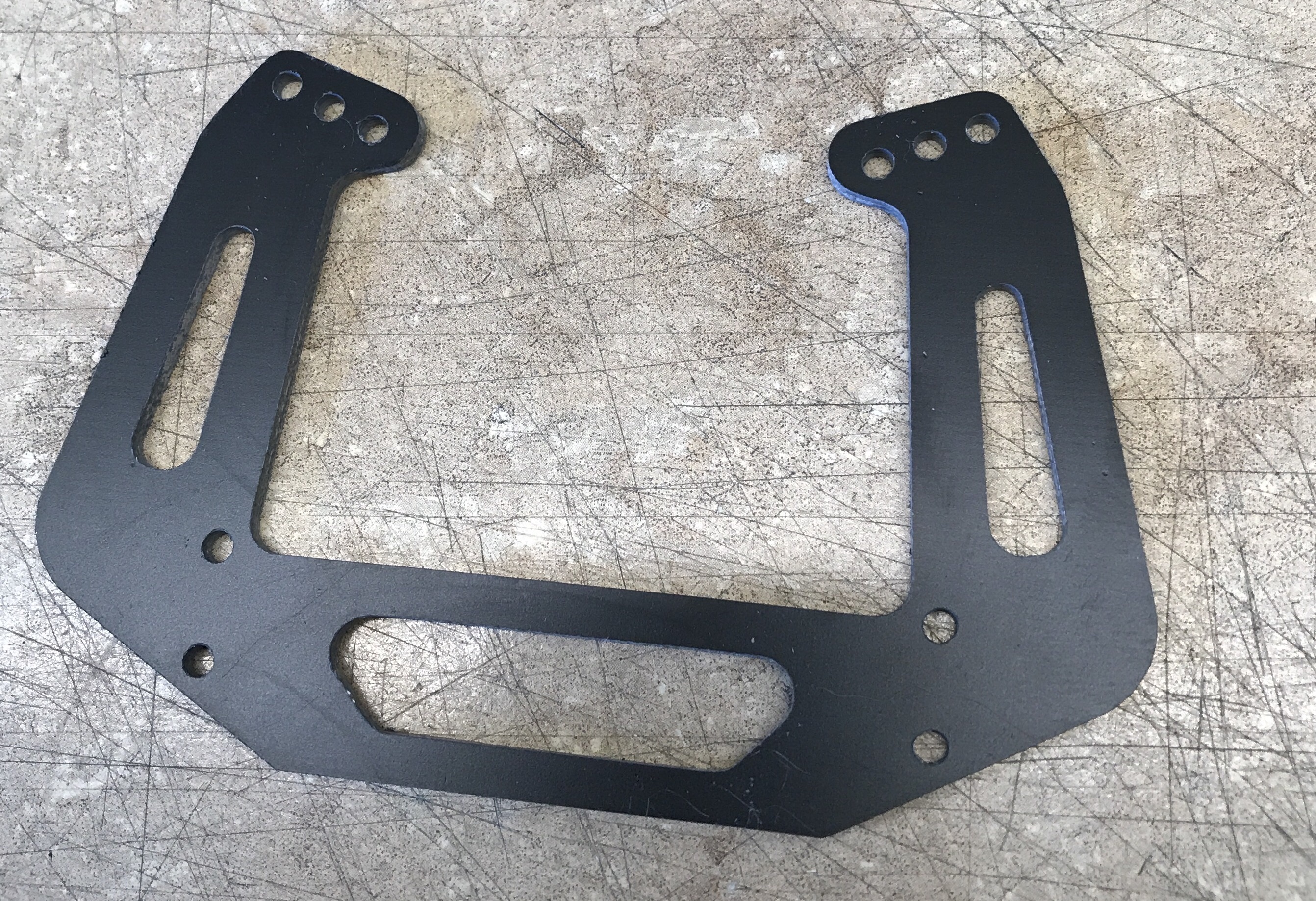

Big bore fronts are .89” same length as a b3/4 front shock. Big bore rears will fit a stock tower but are a tad shorter.
Without measuring I want to say it’s around 1/4” taller in the front and around 1/8” shorter in the rear
We (Factory Works) sell several styles of front and rear towers including big bore specific towers.

Website is outdated. We sell on eBay or direct (direct is cheaper for you- no eBay fees)
Fronts only would be $16.50 shipped outside eBay, and the front and rear sets would be $26.50 shipped. You can send me a pm here for details. We send a paypal invoice. I’m out until Wednesday on vacation so replies might take a bit longer than usual
