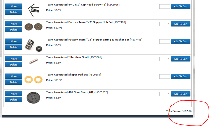

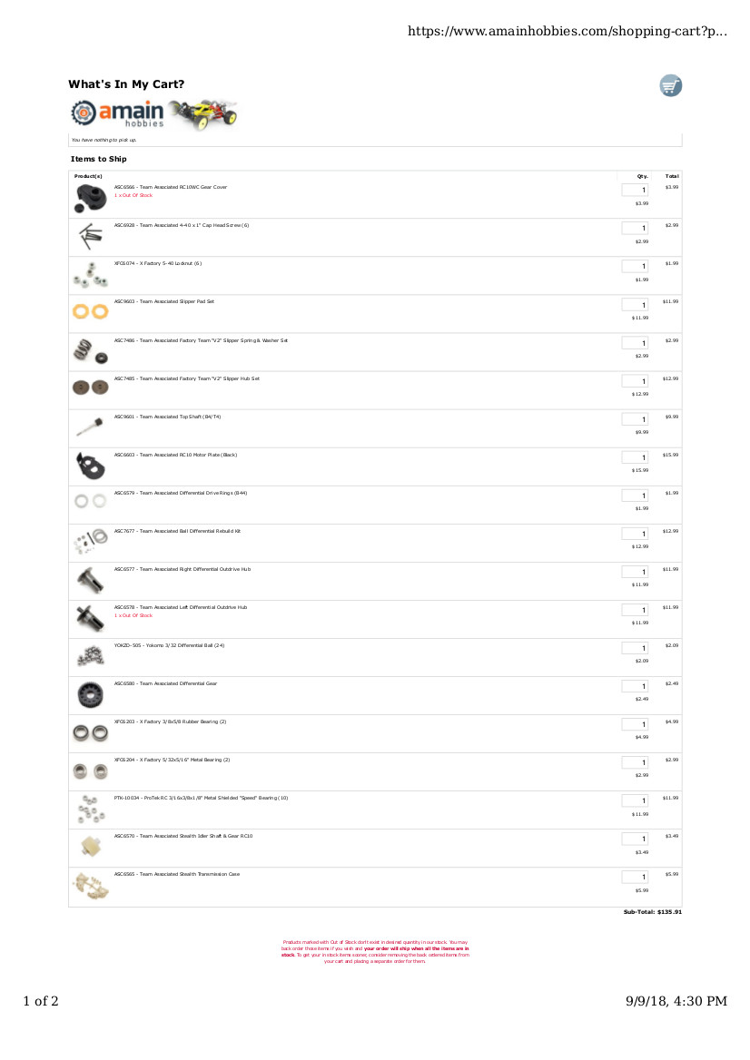

With new Stealth Transmission kits unavailable, I created a "wish list" online at A-Main hobbies of all the individual parts to build one.
Adding up the nickels and dimes, the grand total would be $167 USD. Only one part is missing (left out-drive).
Partial screen shot:

From the picture I can see you have used 6564 transmission. Don't the gear mesh is screwed up and has incorrect backlash.Chemical wrote: ↑Sat Sep 08, 2018 8:46 pm With new Stealth Transmission kits unavailable, I created a "wish list" online at A-Main hobbies of all the individual parts to build one.
Use 6565 transmission case and 6570 idler gear.
WOW $167!!! it can be done for less.
