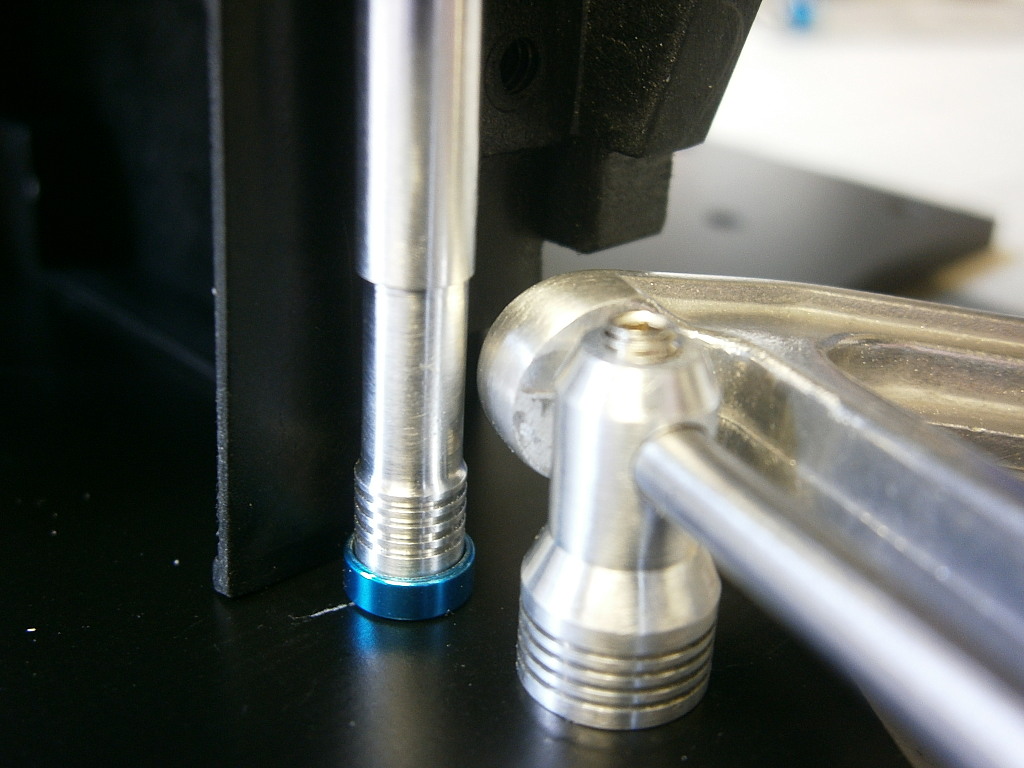

When I disassembled to figure out the battery placement I noticed that the trailing arm pivot was leaving a mark on the ESC stand offs. Not bad, but it was marring the surface. I pulled them off and made a 0.020" reduction of the diameter. Now I'm happy.

Re: Factory Works 180* Steering Bellcrank Build
A simple problem requires a simple solution. Very nice.
There's so many benefits to owning a lathe.
