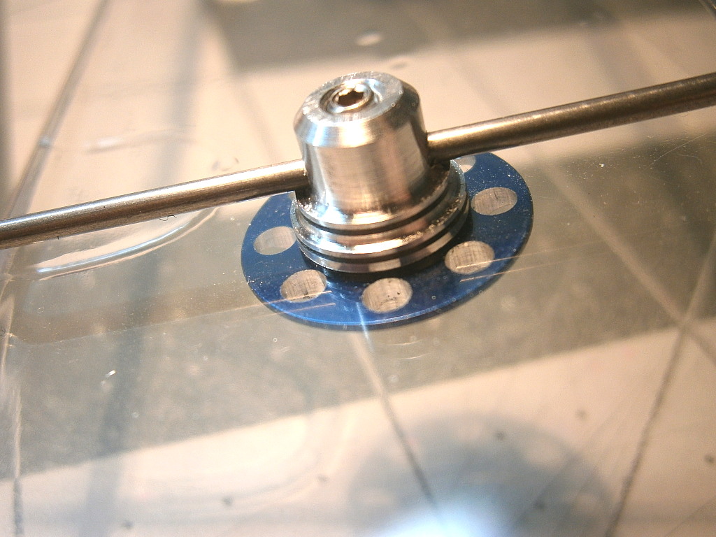

Earlier, I had made some wing hardware but was not real happy with them. They could have used a couple of more cuts,45 degrees here and there. So... I drilled some more rod (1/16" for the wire) in prep for a couple of more. Seeing as I'm waiting on some parts and a new Reedy Wolf Pack lipo shorty. I have something to get into.

I've got the wing mount hardware finished now, whether I use the wing or not, it's still done.
