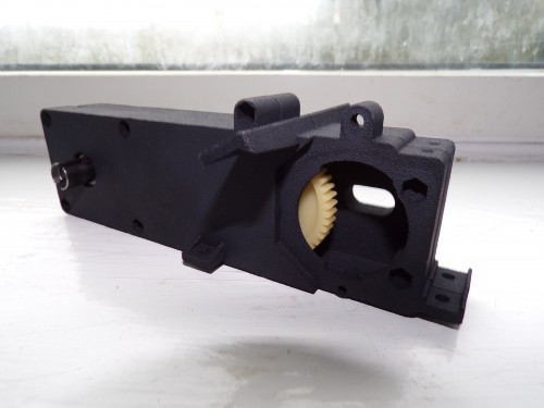

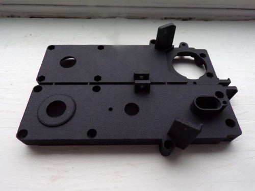

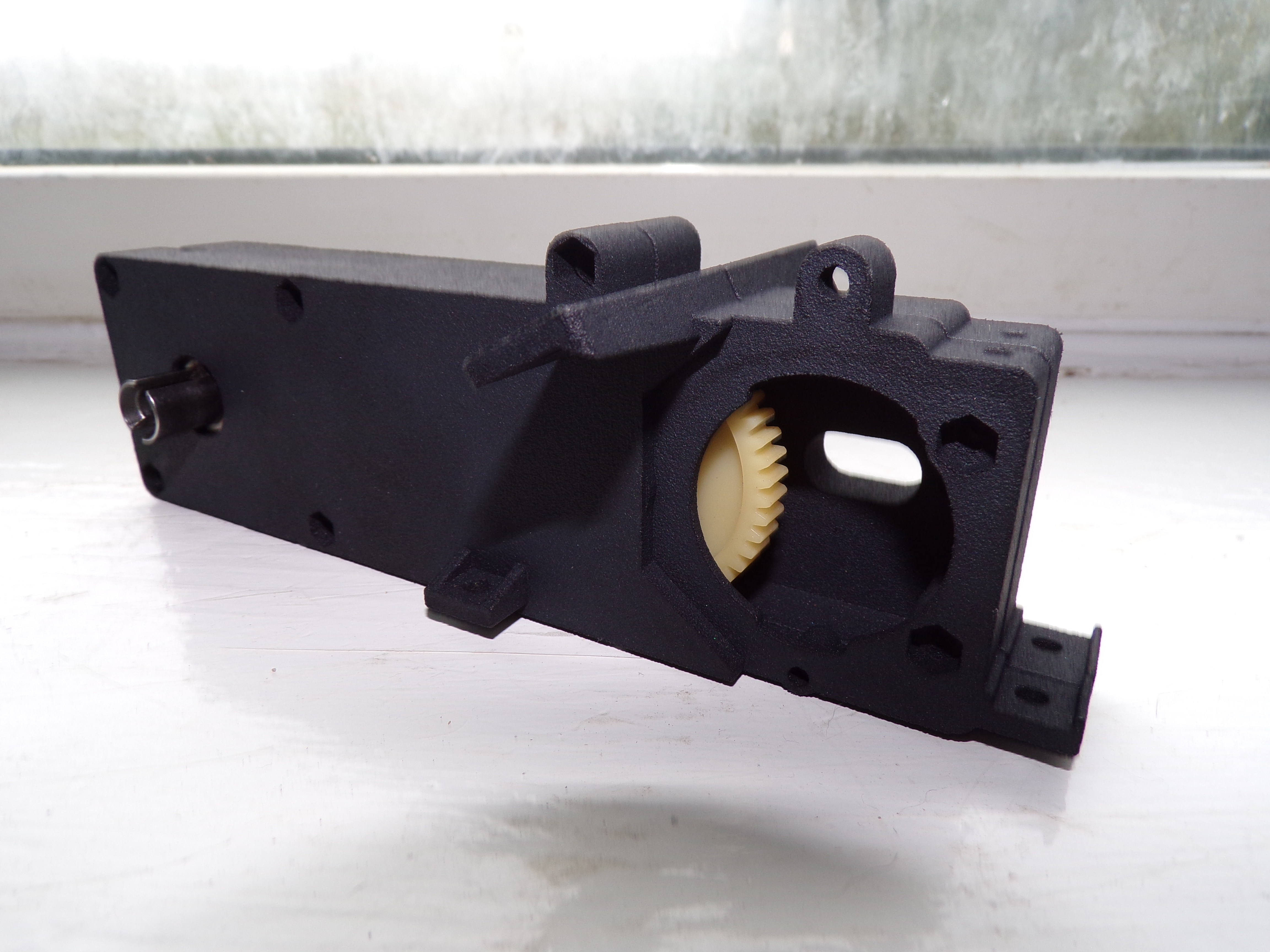

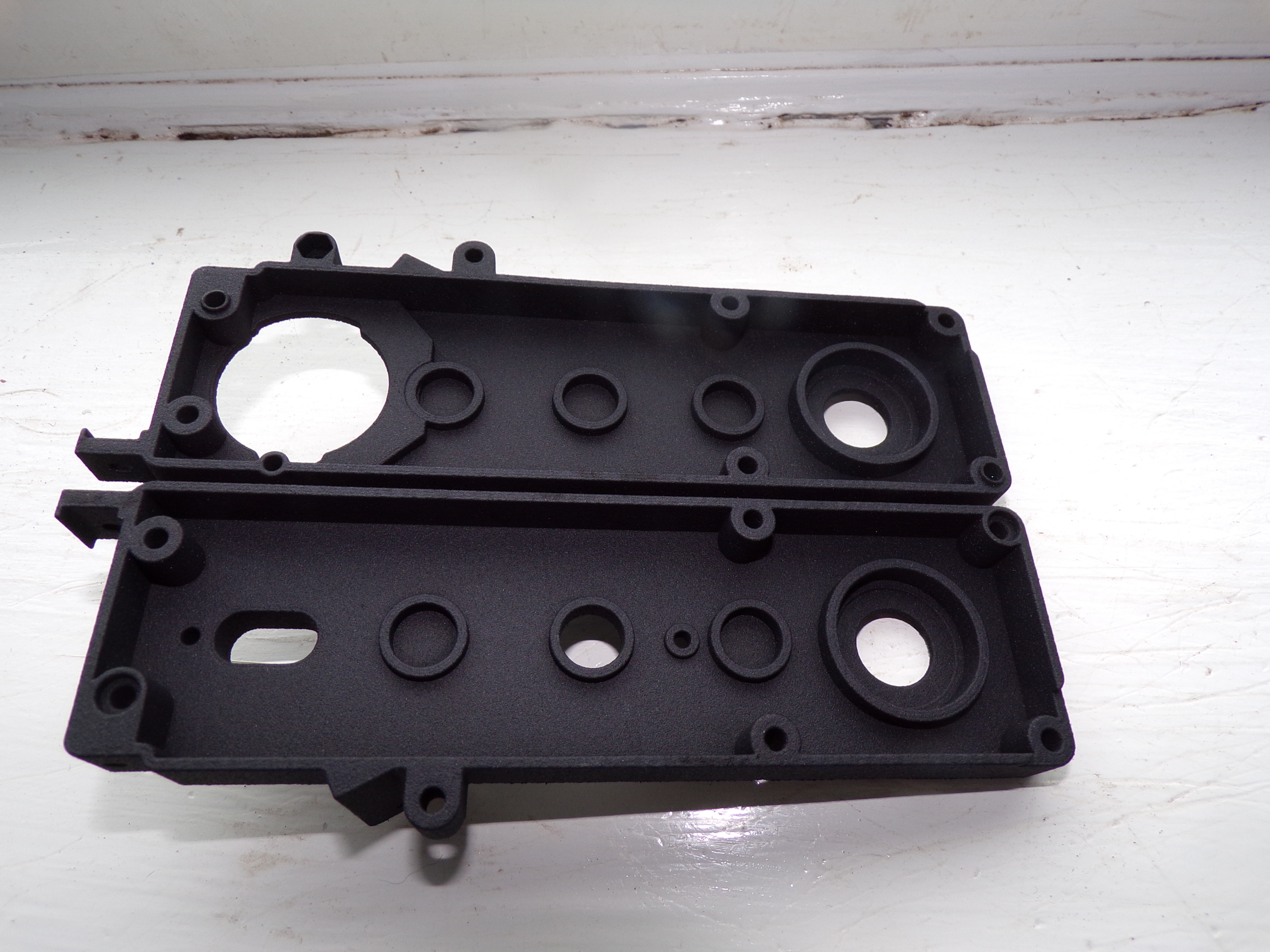

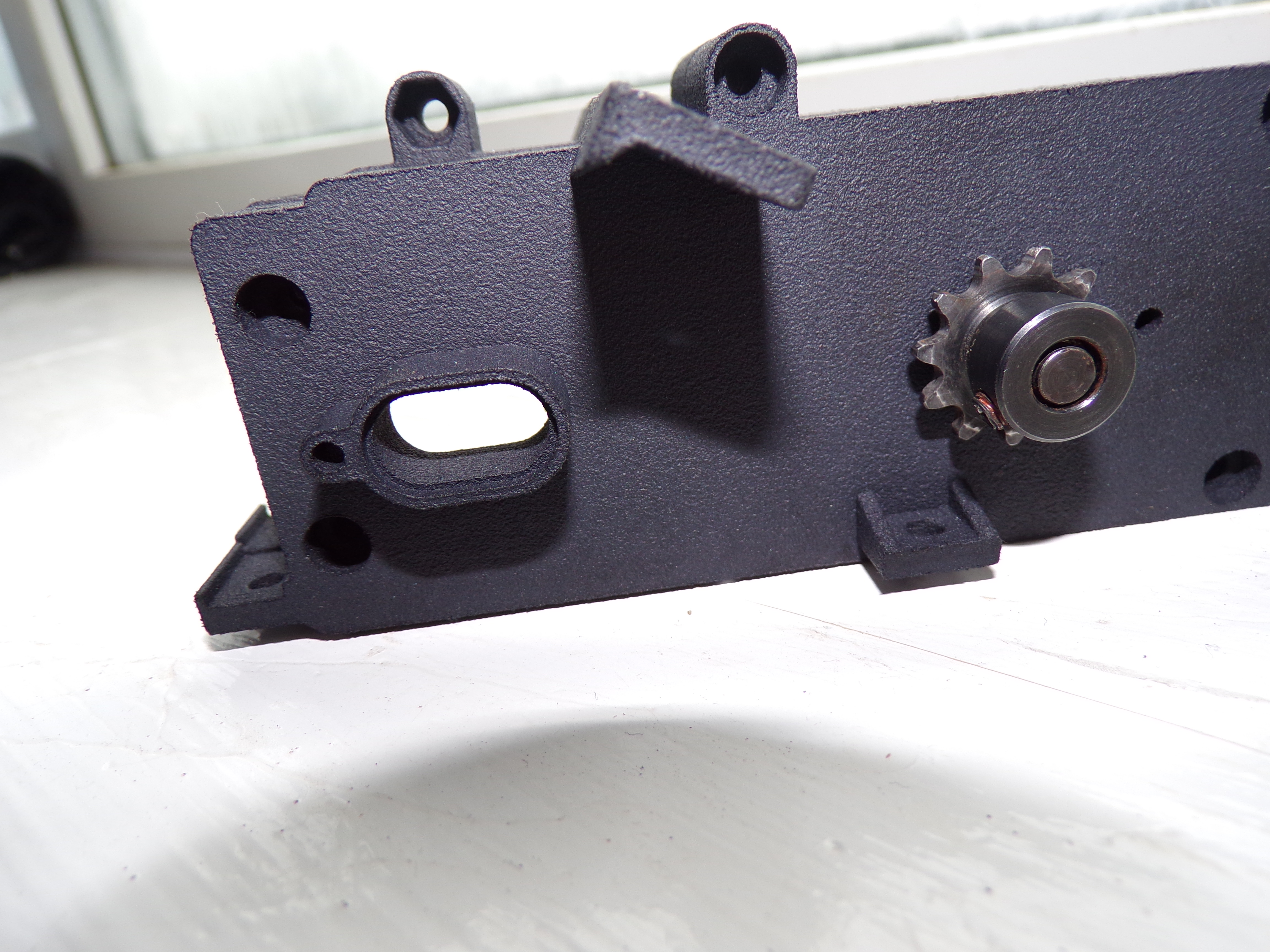

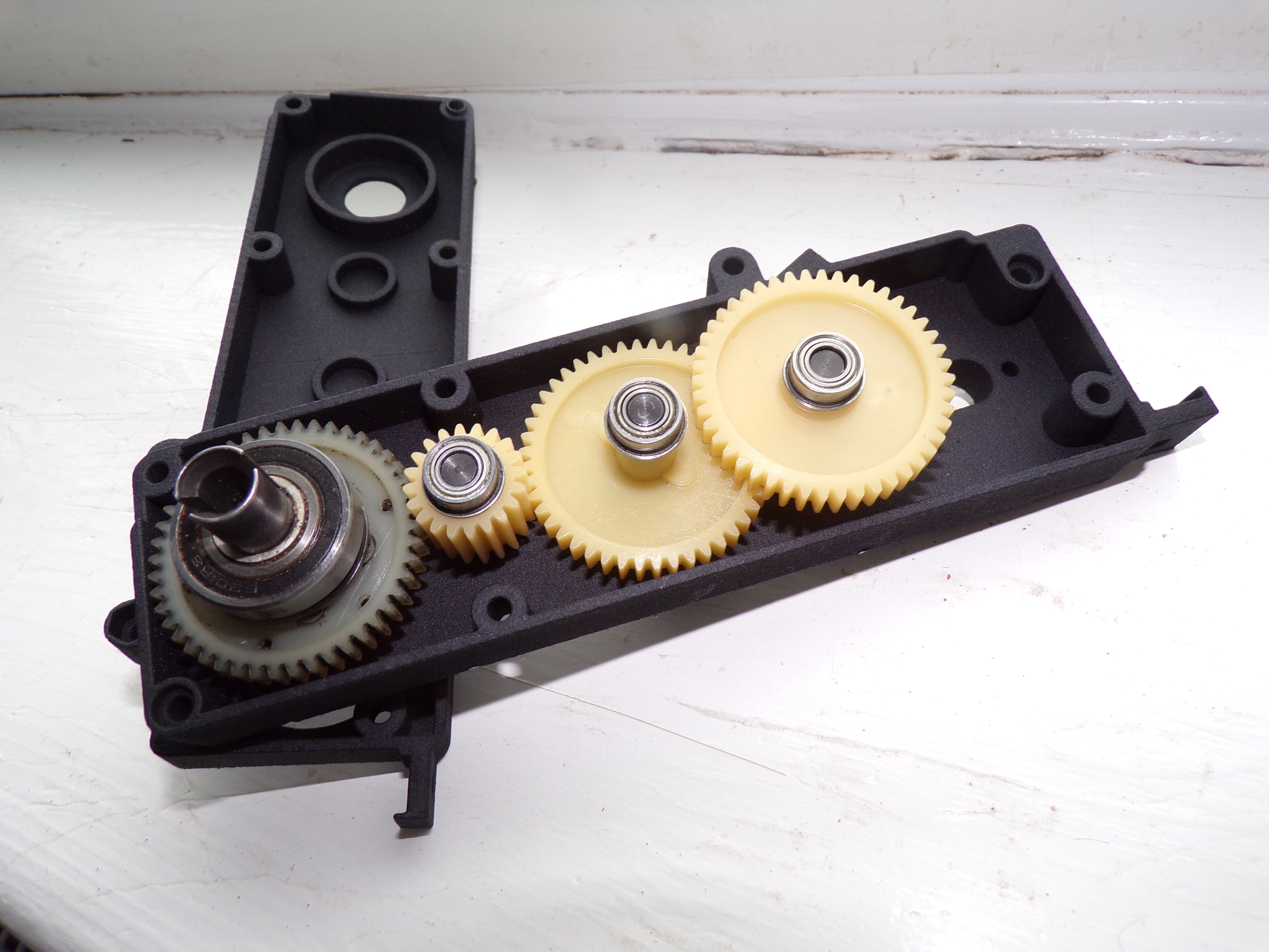

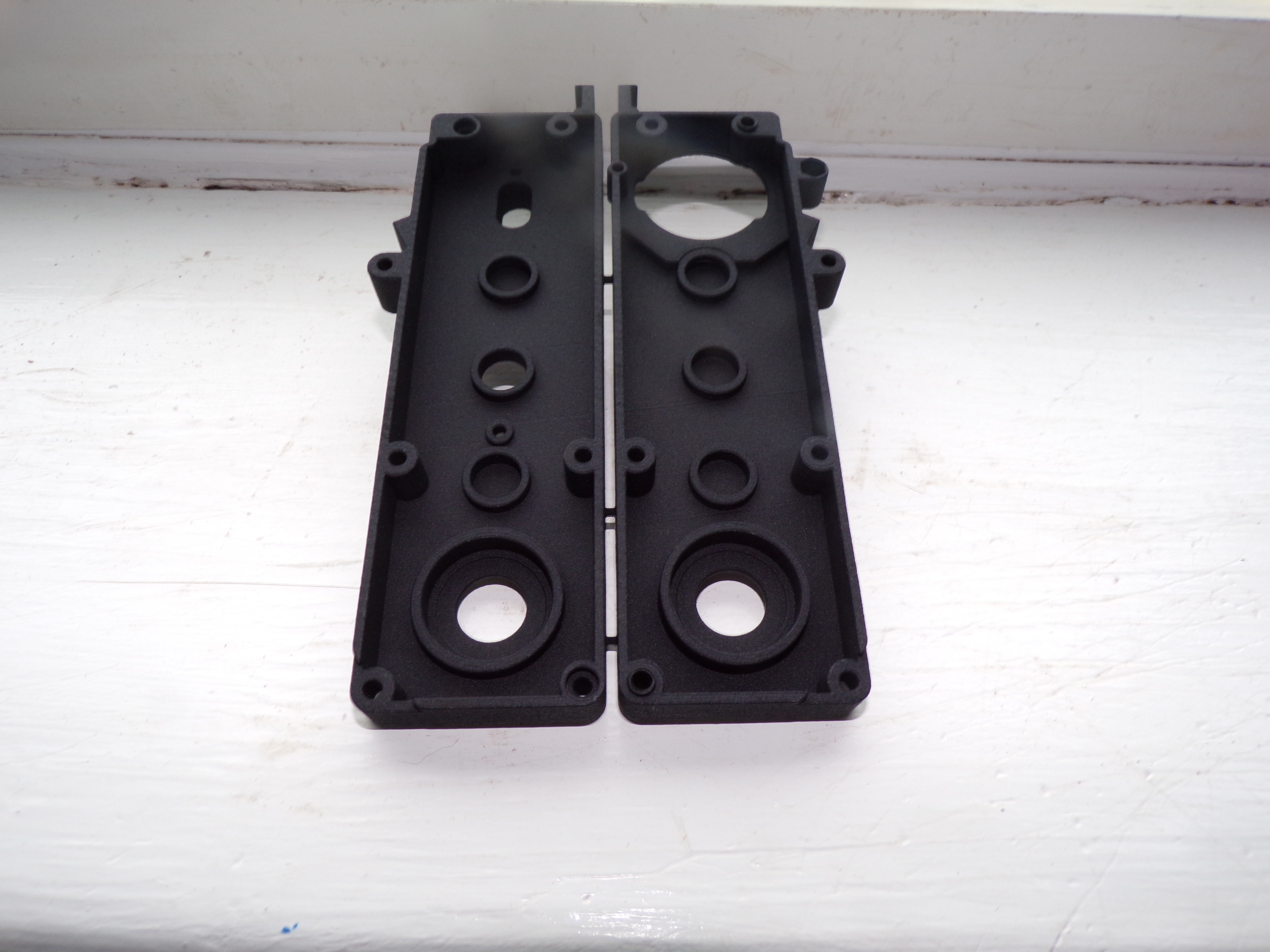

Very Very pleased with the Yokomo YZ-834b Dogfighter gearbox I just got back from Shapeways
It's spot on , even mates with its original other halves ! Going up on my Dadio Designs Shapeways shop today .

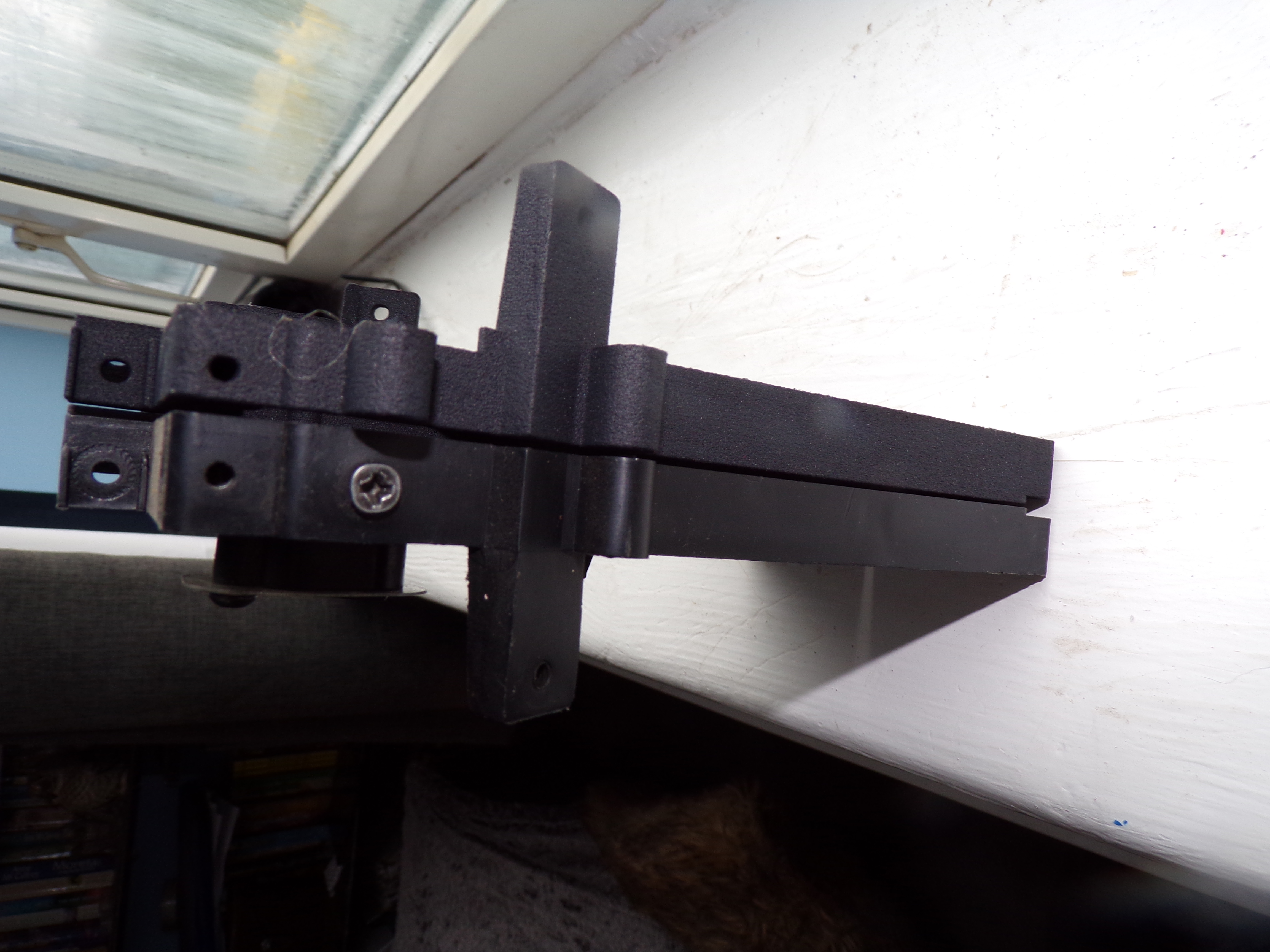

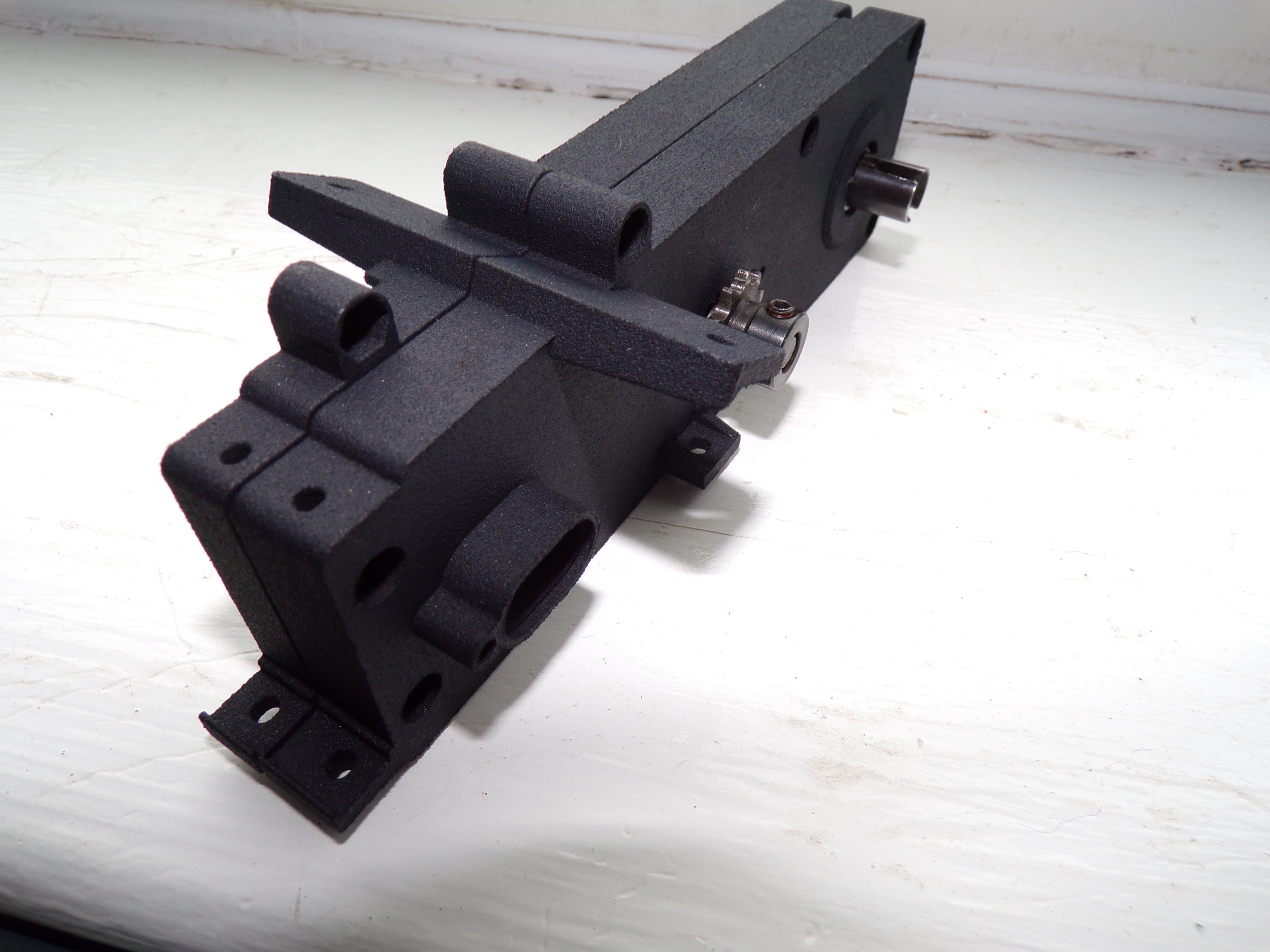

These next two show the original gearbox mated up to the printed version
The eagle eyed will notice the odd diff and Kyosho chain sprocket as I stripped out my runner gearbox as a comparison .

Beautiful Dadio, absolutely beautiful!
It's virtually indistinguishable from the original part.
Awesome work.

Just had the first test drive with the new yz-834b gearbox and it runs sweet as a nut
gear mesh sounds perfect , I'm a very happy boy , I think I need to start some sort of advertising but not a clue what to do ?
