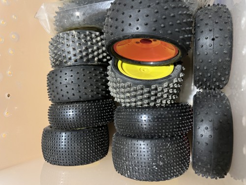

I have 20-30 year old tires, which have not been cleaned in as much time. The rubber is relatively stiff (maybe dry) but in great visual condition with all of the spikes and no cracking of the rubber. These tires will be mostly for display. I want to take off the rims and place foams inside but doing so might risk ripping or cracking the tires. Might have to leave it as is.
Do ya'll clean and brush in warm dishwashing soap water and then coat with silicon shock oil? I don't think ultrasonic cleaners will be effective on caked dirt. My purpose is to rehydrate the rubber so the spikes don't fall off easily.
