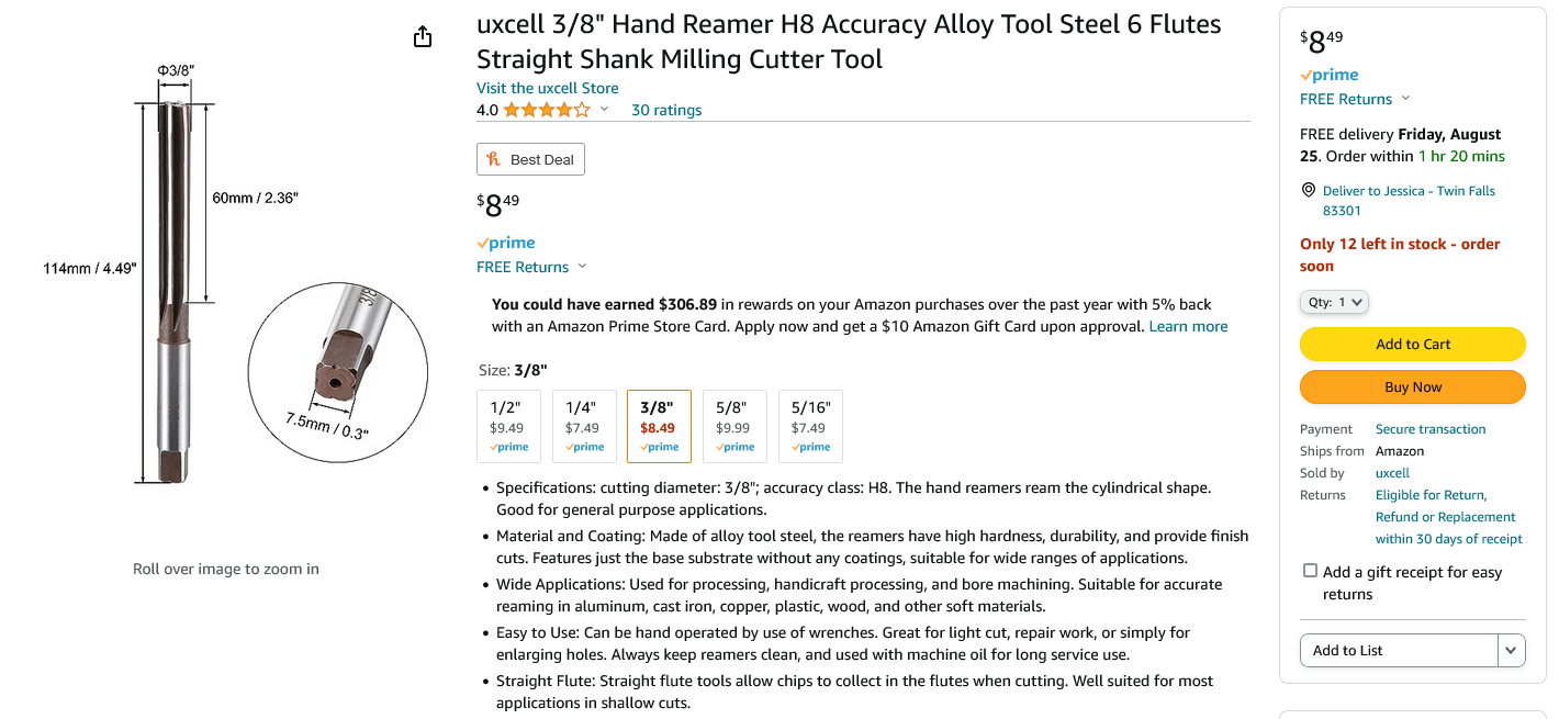

you could use a 3/8" and 5/8" precision reamer to deepen the pockets for the bearings slightly. I would install the top gear, test it. Then the idler tested with the top shaft. Then the idler with the diff. That way you target the correct pockets as some may not be tight at all- like the topshaft iirc is usually pretty sloppy.

In this rpm box the bearing don't feel pinched. The opening are a little loose. Though I may test that more. Though I will test it out.GoMachV wrote: ↑Tue Aug 22, 2023 12:39 am you could use a 3/8" and 5/8" precision reamer to deepen the pockets for the bearings slightly. I would install the top gear, test it. Then the idler tested with the top shaft. Then the idler with the diff. That way you target the correct pockets as some may not be tight at all- like the topshaft iirc is usually pretty sloppy.
