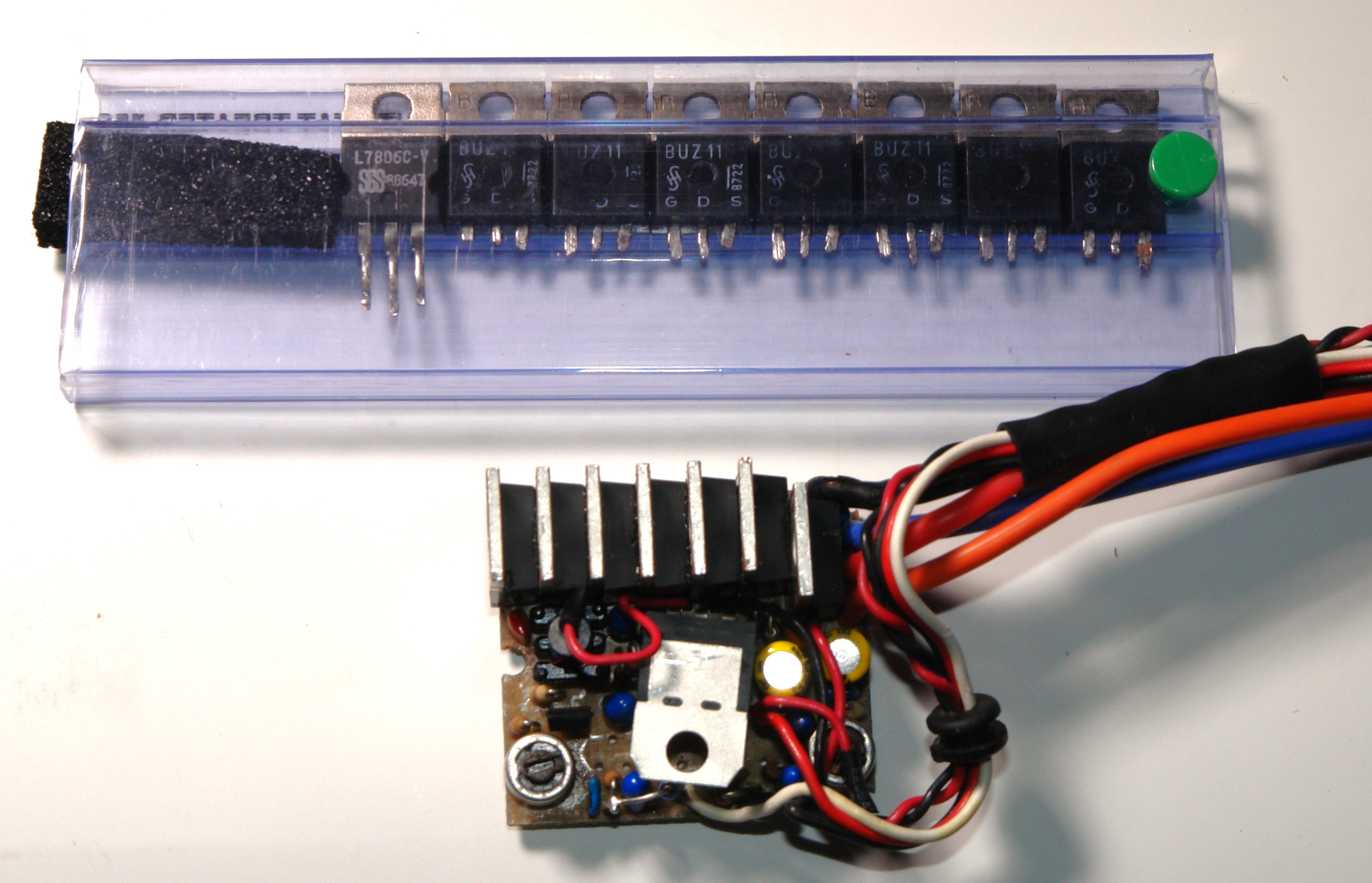

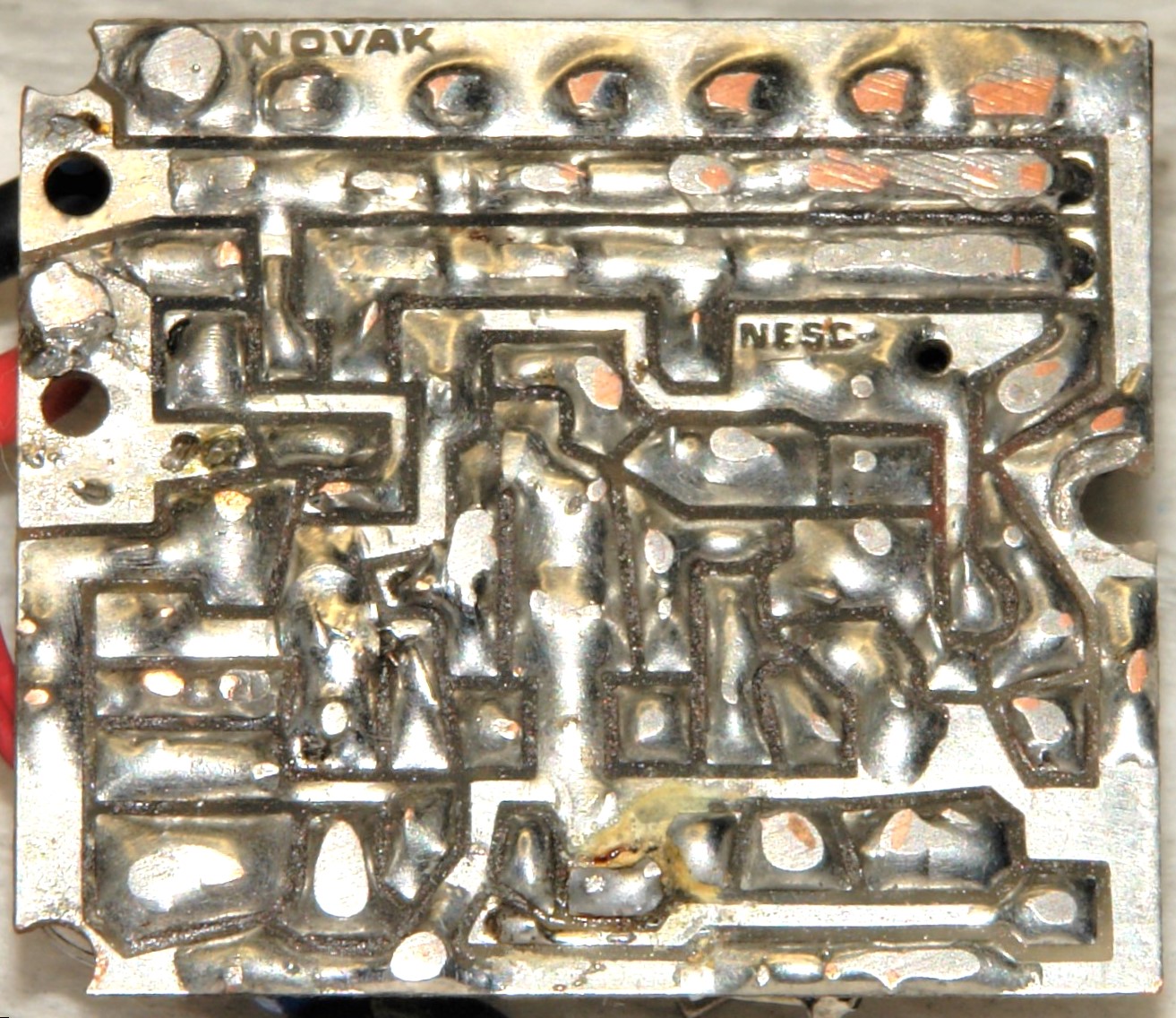

1. Replace the parts that heaviest current draw e.g. the 7 BUZ11 FETs and the 1 L7806C-V voltage regulator.
Before pic of back side of PC board
After replacing FETs
Well that did not work :( :? but not totally unexpected.

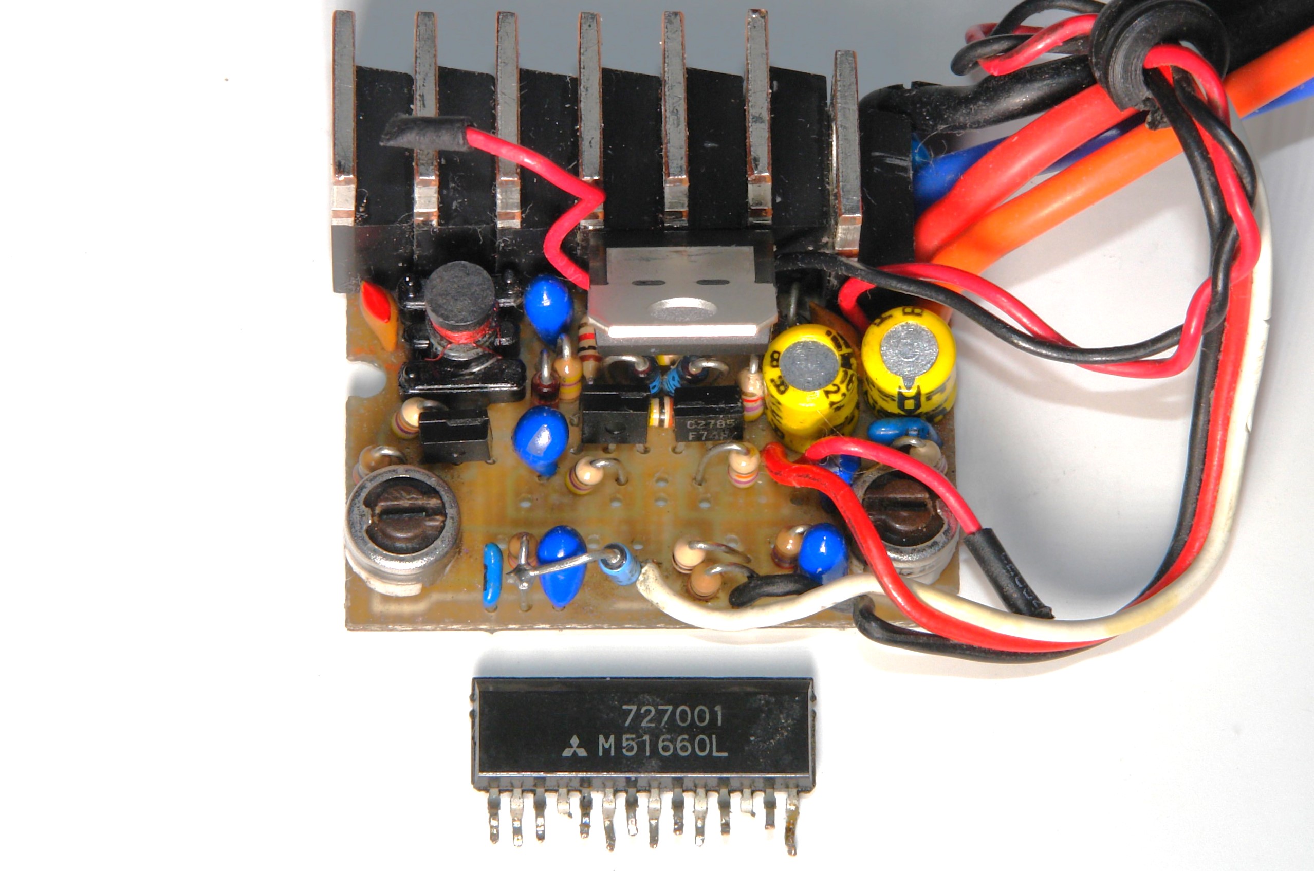

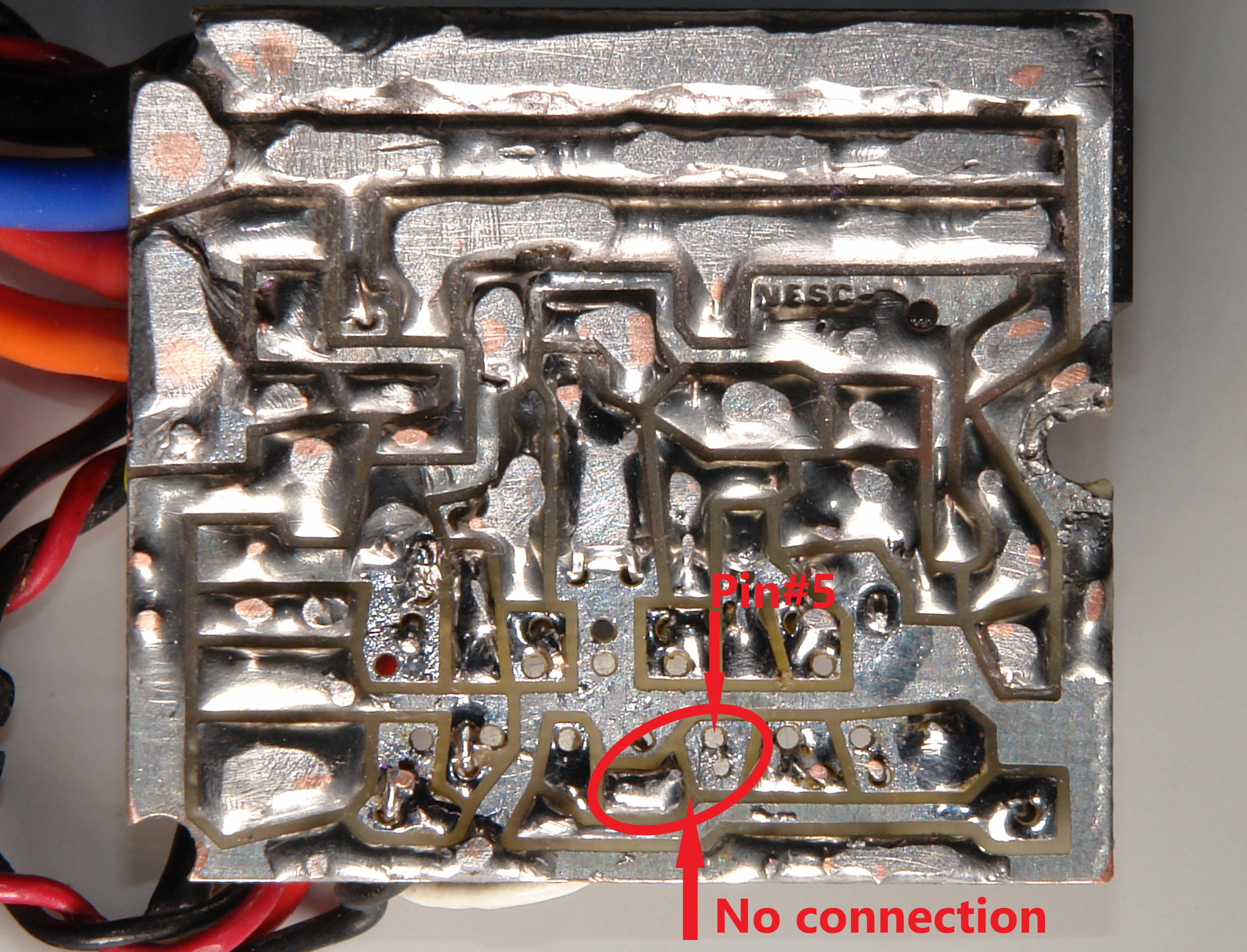

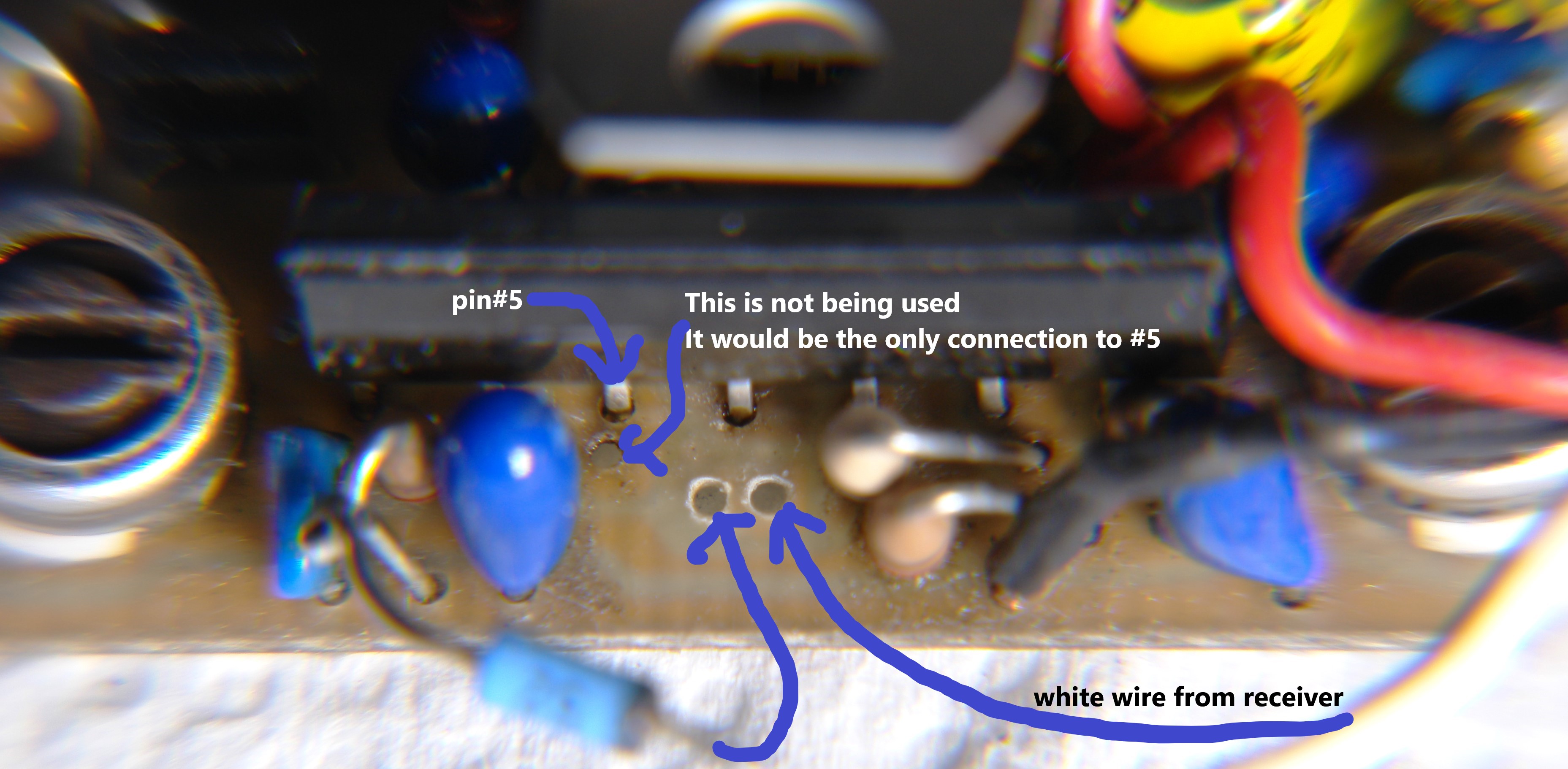

I took a couple more pics. One of the IC and a better pic of the board without the IC installed.
With the IC removed the and the voltage regulator moved up the second pic also shows 3 small transistors marked 2785. One faces the forward and the two on the left face the larger FETs.
According to what I find is that they are 2SC2785 transistors.
Chuck
radioactivity
Posts: 856
Location: Dripping Springs Tx
Has thanked: 384 times
Been thanked: 618 times
Re: Novak1 repair attempt
Post by radioactivity »

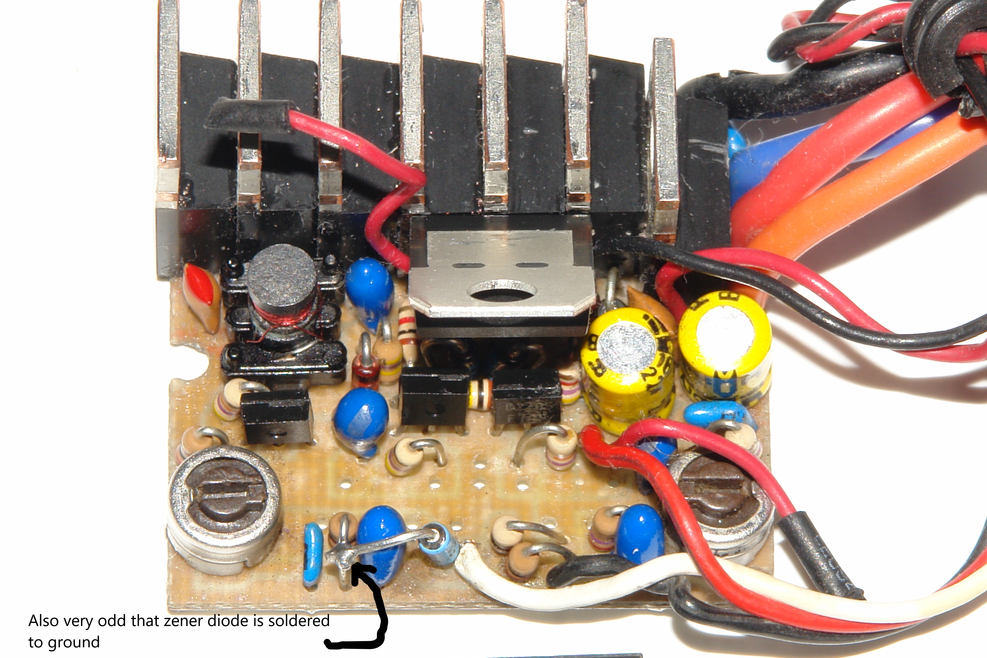

I have found some interesting quirks with this ESC.
If anyone has a Novak NESC1 or NESC1x and can take a picture, it might solve my problem.
After replacing the IC there was no difference :(
However I did find the pinouts on the IC
The #5 pin apparently shows the input. This should be from the receiver???
A close look at the board shows no wire or trace going to this pin???
Also the output wire from the receiver is connected to the cathode of the zener and then goes to ground on one leg of a resistor?????
I think someone else may have been trying their hand at repair.
Chuck

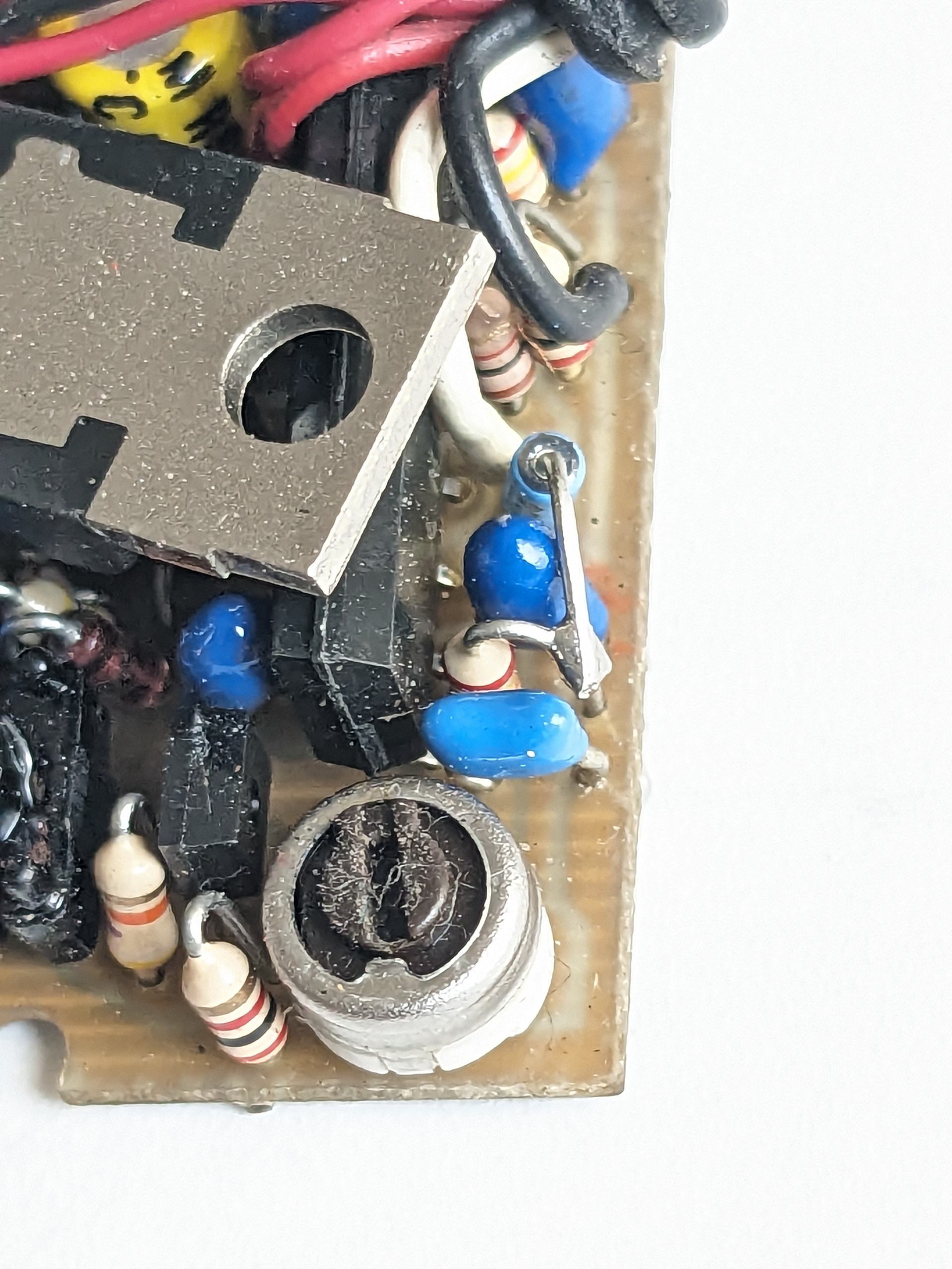

Posts: 3808
Has thanked: 2604 times
Been thanked: 2977 times

Thanks so much Frankentruck!!!!
Can you see the open hole that is near the #5 leg of the IC? Or is there some thing else there.
It is blocked by the blue "lollypop" looking blue capacitor.

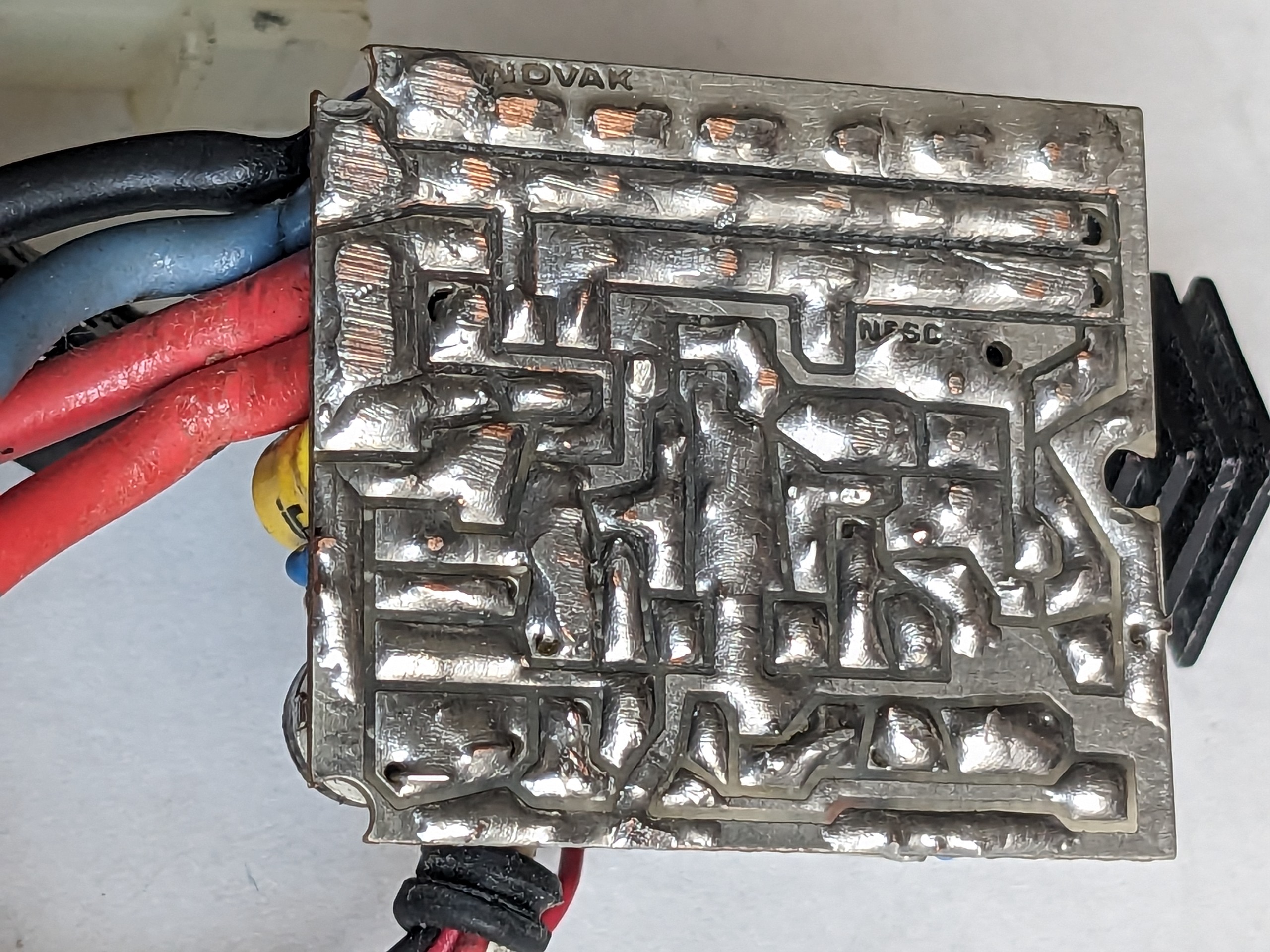

and if you can a pic of the other side of the board
Thanks again so much!
Chuck
Posts: 3808

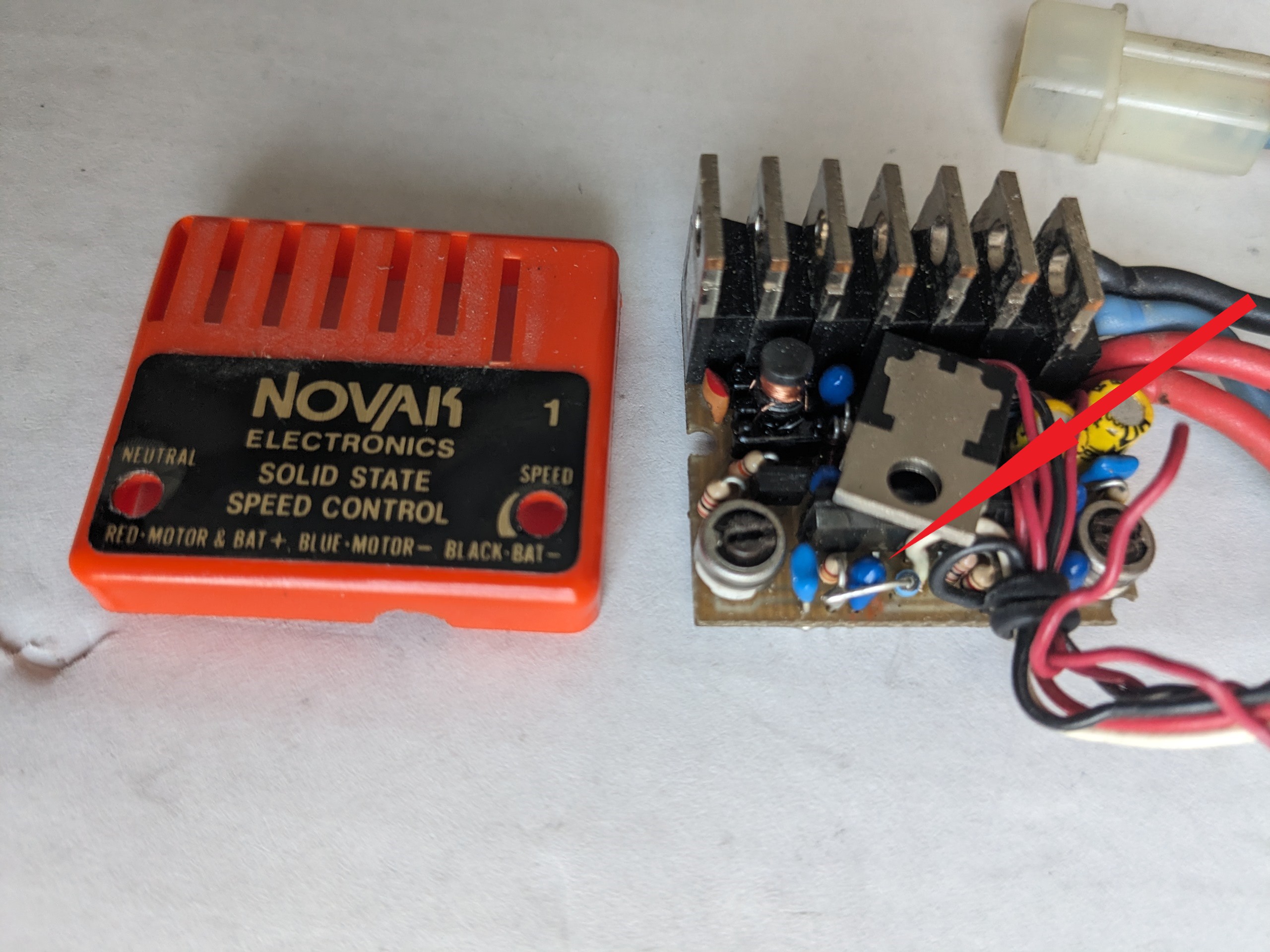

radioactivity
Posts: 856
Thanks again!
Interesting... The white signal wire is connected to the #5 on the IC.
But only by soldering across 2 separate copper pads. This is shown in your pic inside the red oval that I drew.
Pic taken showing no connection between white wire output signal from receiver to #5 input to IC on PC board.
