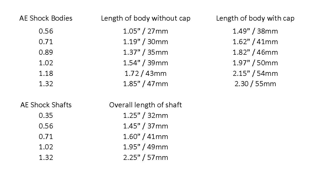

I did some measuring today and put together a simple cheat sheet. This is just for v1 shocks, top or bottom load. the numbers are close, rounded, but close enough for ID.
