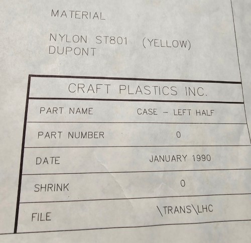

Daryls son sent me some of his drawings recently and I finally know the material they used on our A&L wheels and trans cases back in the day

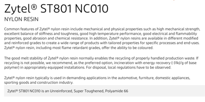

Re: What Type Of Nylon Is Used On AE Vehicles?
The Zytel ST801 gained the industry trade name “super tough” back in 80’s, totally makes sense somebody would choose that for this demanding application.
The NC010 in the name is their code for natural color (golden/off white).
Im sure modern materials have advanced, but back in the day Daryl said they would mold a few different materials and take the wheels out back to the dumpster and chuck them as hard as they could to see if they could get them to break. The material they ended up with was the one that survived the dumpster test haha.
