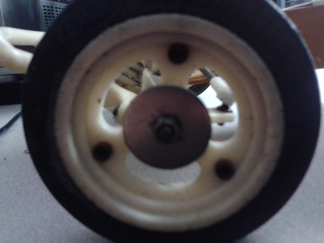

lol yea i was after horse power man . any way got it all patched up i am looking for a stealth transmission that can handle racing motors. any ideas ?
also will newer rims fit on this car ? i keep looking and every one says i need to get this conversion kit to the b4 or b3 . is it just that the axle is longer or thickness of the axle ? i can make metal parts so i am just curious.
another derp question can i buy tires for these rims still that are a bit more modern ?

you can pick up used stealth transmissions from ebay, or build your own from parts from associated, or buy a new trans kit. they will handle pretty much anything if built and maintained correctly. for that car, you need the 2.25:1 ratio trans, not the b2, b3 or b4 stealth trans.
as for wheels, tires, etc, the 3 pcs wheels you have are original, and you can get new replacements for the re-re gold pan classic, or convert to 2.2" wheels and use the dozens of different modern tires out there.
b3 and b4 have different offset, so they require different things to make fit correctly. the re-re worlds car uses b4 fronts with wider axles, and new b3 style rears that fit a 3/16" axle, so you can get a kit to convert to directly fit these wheels from associated.
alternatively, you can by jc racing wheels from the UK that fit 1/4" axles and 2.2" tires, although the fronts are narrower then the b4 wheels and the newer front tires.

im not sure i understand the tire thing so they make wheels that will fit my car stock and i can use modern tires on ? why cant i use the other transmissions ?

Yes they make wheels that fit modern tires. Probably 150 threads on that topic by now. The other transmissions are not easily mounted. The 2.25:1 is designed for the gold pan.

okay so after searching i found a wheel mod for me

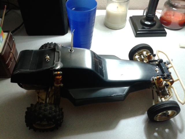

This means that i am on the home stretch and finally having fun with this beast from the past... i have created a monster

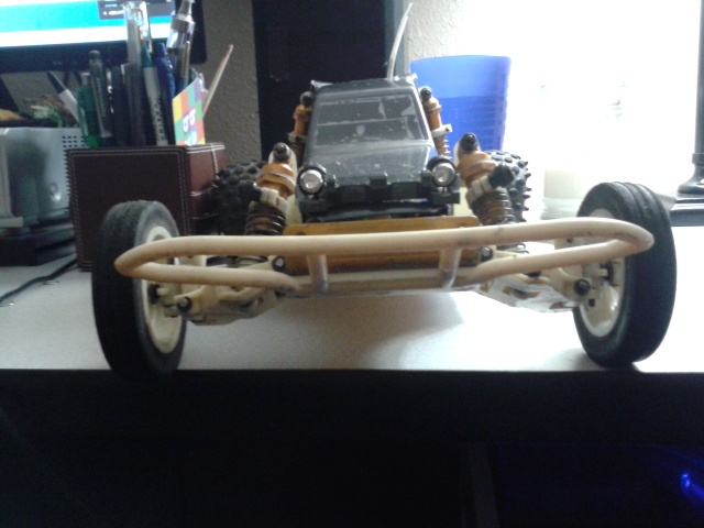

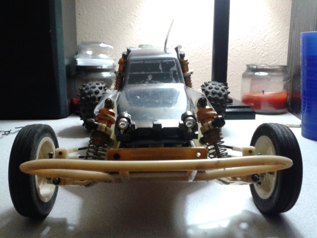

my old A stamped, short arm, rc10 is running here are some picks .
this is not drilled for the stealth tranny so the paint is not perfect it was cold outside and caused the body to shrink a bit from the flex paint

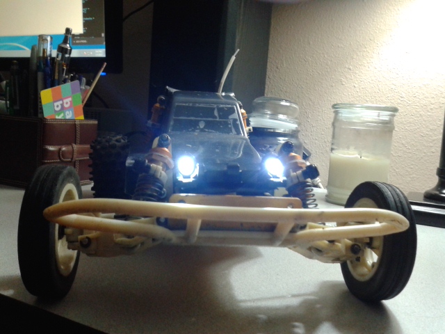

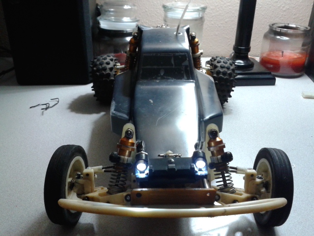

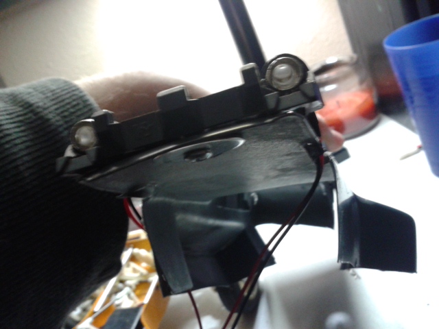

for the ppl who may be wondering about the lights and if they work
the plastic i used for the headlight mount is from an amd processor heat sink mount. i had to shave the holes a bit but it came out looking and fitting pretty good. only problem is i want my channel 3 to turn them off and on since channel 3 is just a button. i have them hooked up to channel 3 but it does nothing.

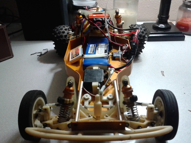

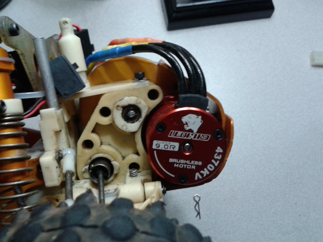

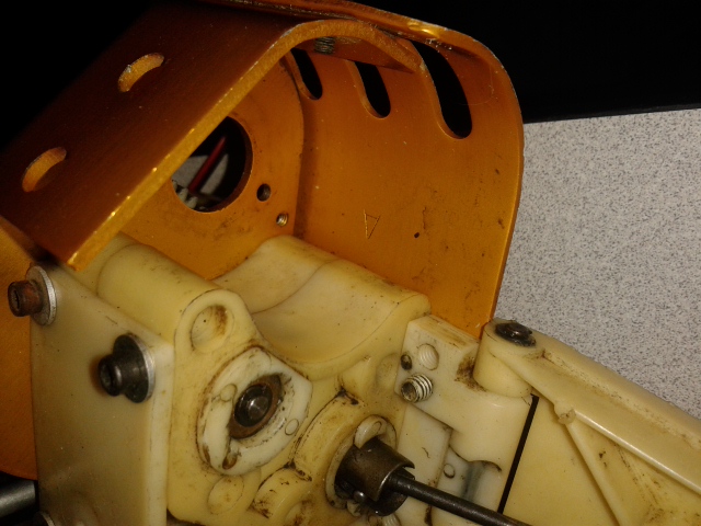

here is the guts
cheap and sweet motor . super fast! ill post some vids on youtube soon when the weather gets nice and i get a hard pack lipo speaking of which,

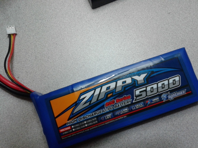

here are the two lipos i have for this guy . the small one powers my steering servo, lights, and fan the zippy drives the car. i have run this guy for 1 hour and dropped it to 7.1v no power loss.
here is the guts

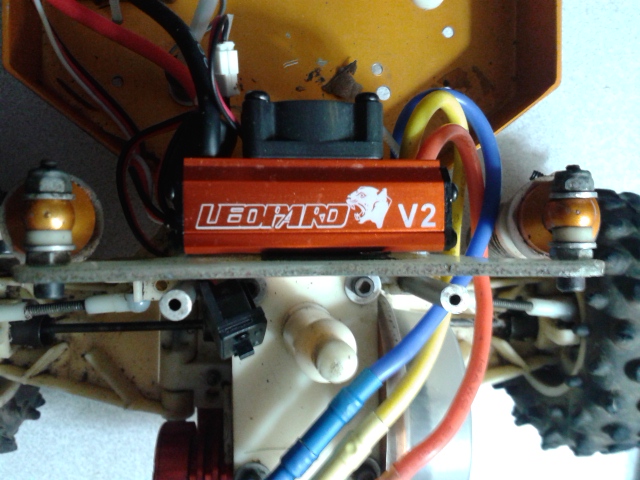

esc is good . it has a cheap tuner card but at least it gets reverse.

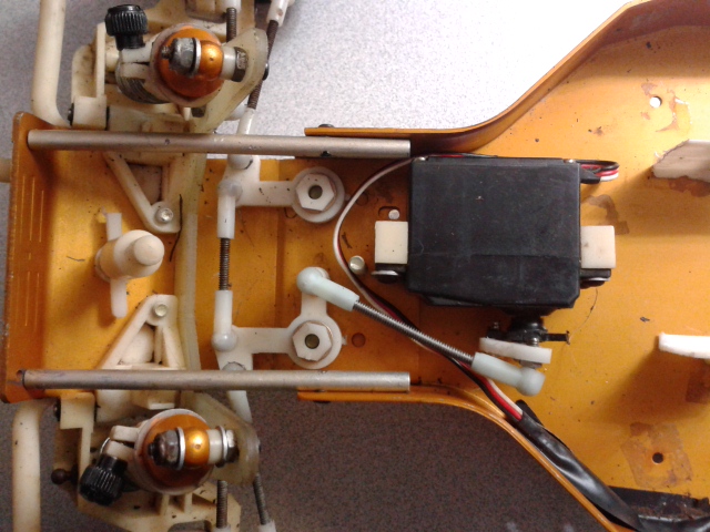

i beefed the steering. i didn't actually need worlds car steering but i did that any way. my problem was the servo arm . so i extended it with a piece from the original steering.. WAY BETTER !!!! . i added extended washers on the wheels instead of the small ones that were there. this should help with protecting the front wheels when traveling at 55mph down the street.

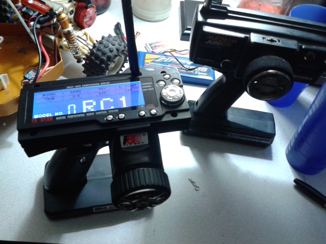

new radio much much better than the old.

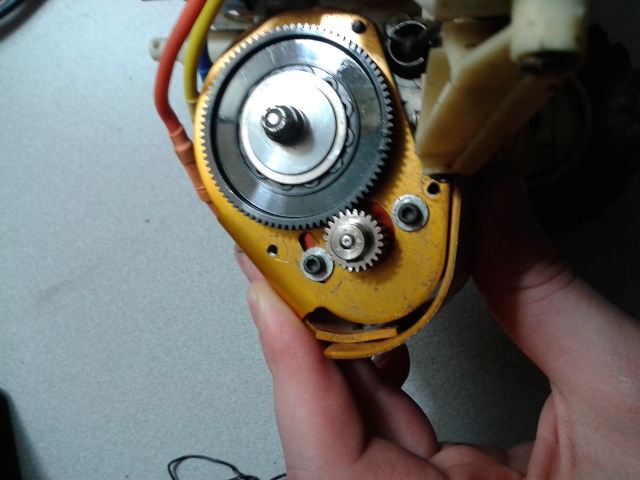

my problem child ! i managed to make the car drive for a while without changing anything after melting the slipper spur . i just licked the whole thing as 1 unit but alas that failed when i lost my 30 year old C clip holding the spur shaft to the tranny. so in salem oregon there is a place called r/c usa. it has an indoor track and is probably the largest hobby shop i have been to ( i have been to alot of them around oregon) any way this guy they call the guru some old time pro who has owned the joint for several years , comes up to me and i tell him about my problem with the spur and all that jazz. he did not carry an exact replacement but he looked in his old bins and in the back, couldn't find one " but " he said " we can change it from a 32 pitch to a 48 pitch and change your pinion " i said okay so he goes in the back grabs some parts and comes back with 3 bags . differential balls, a spur, and a new pinion . don't recall the amount of teeth on the pinion but the spur in an 88 tooth. i also got new C clips . he gave me some advice on how to set the differential as well as showed me some tips to get better traction. this guy was great nex i was expecting the price to be crazy for the parts some where in the 30$ range nope 13$ flat. fixed my car for dirt cheap and have had no problems since.

I have the same charger and similar Leopard Toro ESC. If you look at the manual for that ESC, you'll find additional configuration options that aren't accessed by the program card. You just need to learn the sequence of beeps to understand which option group & option item is the active one.stoggie388 wrote: esc is good . it has a cheap tuner card but at least it gets reverse.

How do you like that Zippy?I'm thinking about grabbing a few,
Oh and I had that same Venom battery back in 2001.I treated it good and it still ended up being the worst battery I ever had,and then it blew up,lit my lunchbox on fire,and probally would have burnt my house down cause I didn't know, but my dog was barking at it so I was able to put the fire out,ha..And I thought the crappy run time sucked....ha.

Oh man,you got the radio I'm looking at too
