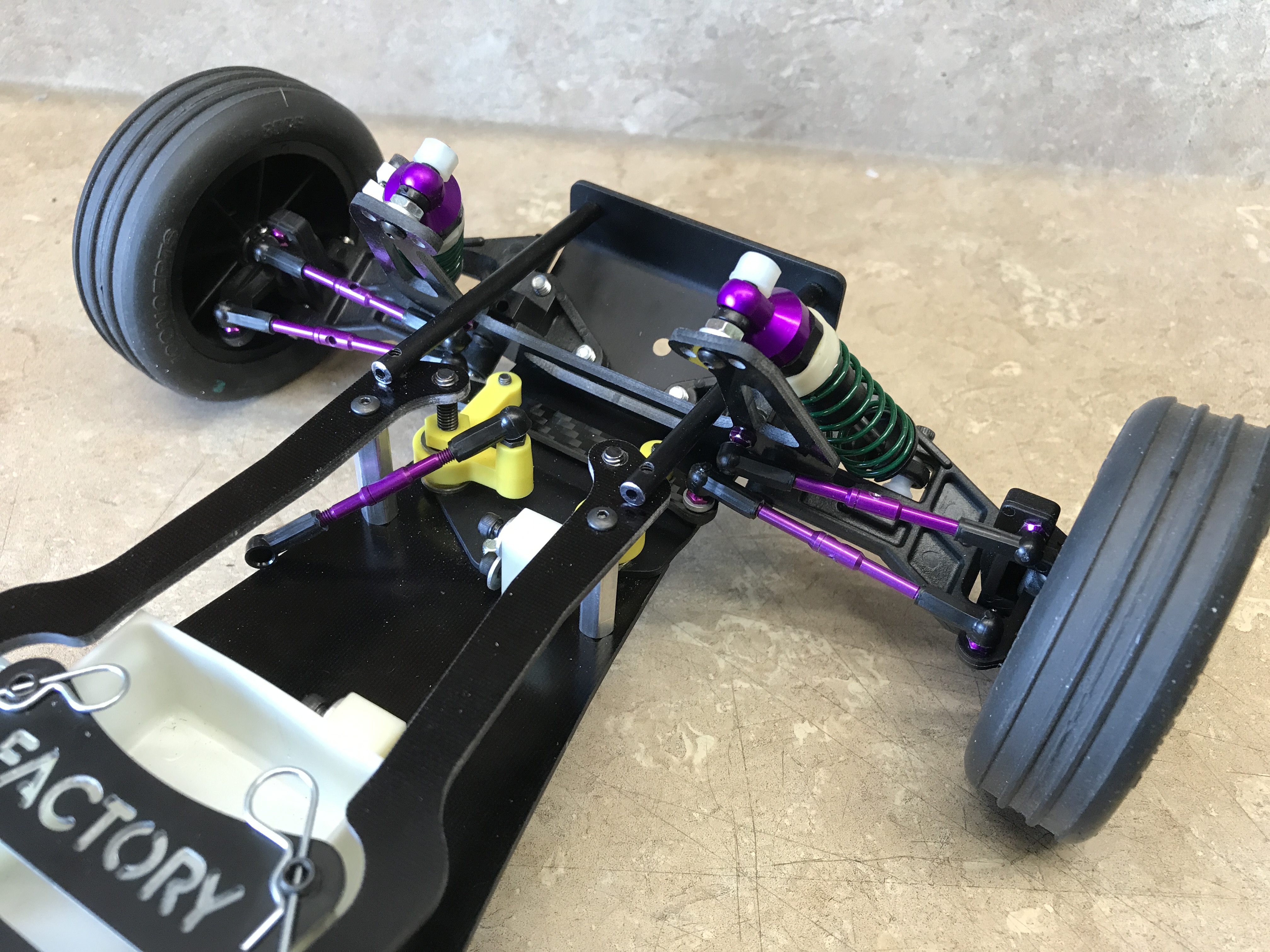

The servo mounting holes are drilled in the chassis now. I don't have the proper 82 degree countersink bit (yet) so using some button head screws from the bottom for now so I can move on.
Waiting for some black (ASC 6334) battery cups to arrive in order to get the shorty lipo battery in place. As per GoMachV's advice, mount it as far forward as possible.
All the rear axle parts are on hand now. I tried to score a pair of the re-release black dogbones but was only able to source one. After much searching, I found some new old stock ones. I have a back order at a couple of places.
I've decided to go old school with a brushed motor and a lipo capable ESC. More on that later on.

If you haven't already sourced them, you'll need 3/16 x 3/8 flanged bearings for those axles to work.
I forgot to reply with the countersink bit I use. This is the one I prefer. Thought it was from McMaster but that was the previous one
https://www.ebay.com/itm/222092837465

Re: Factory Works/A&L C2 build...
Thank you for the tip, much appreciated.
I will get into seeing how things go together later on today. I'm hoping I've bought all the right parts. I have a habit of not doing that lately.

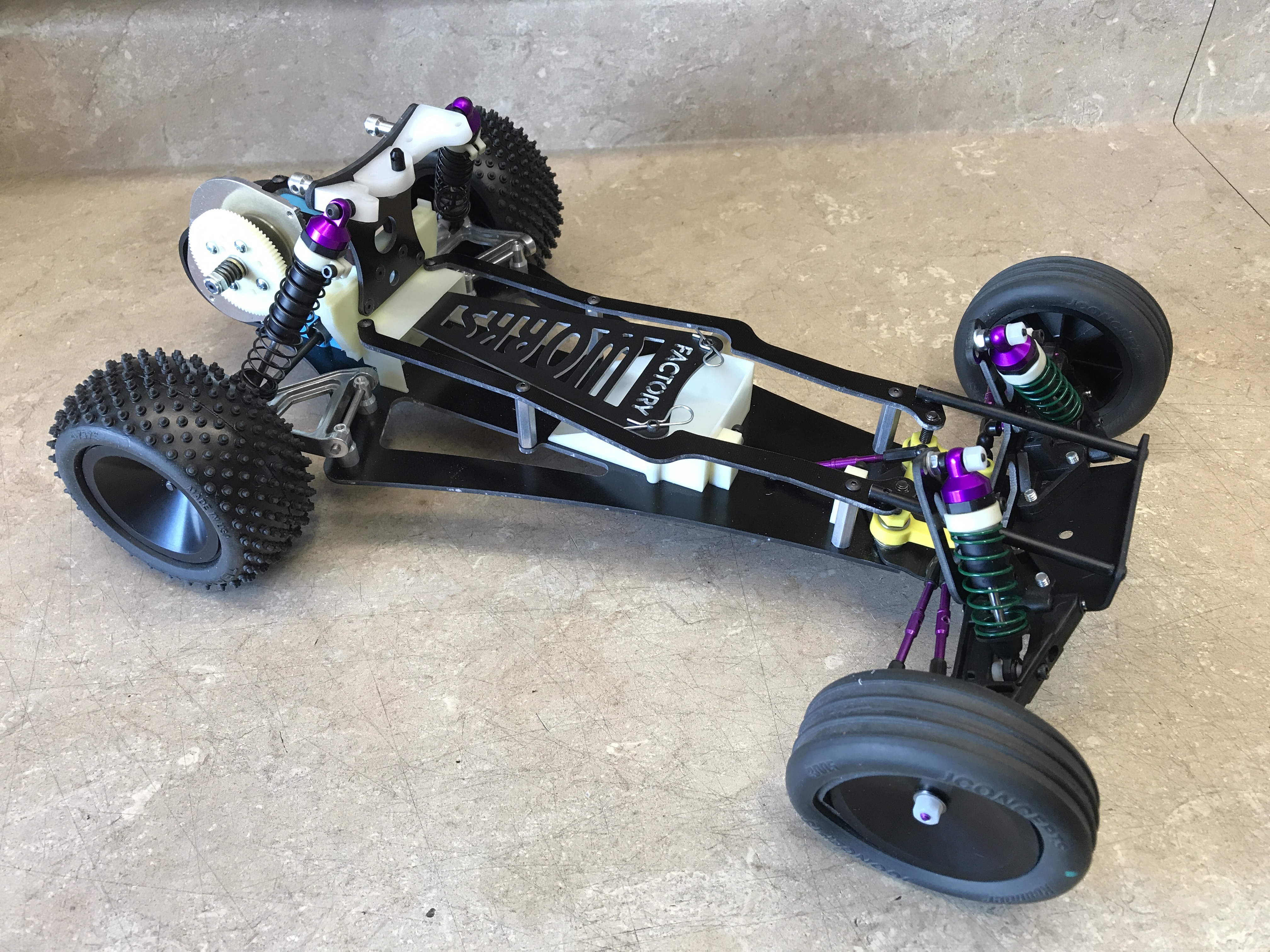

Oh man, things are just working out with these axles...
I have the axle in the trailing arm with no shims, 1/8" down stop in the shock. I can't put the spacer that came in the dogbone springs & spacer kit without the dogbone binding in the transmission out drive . there's also no room for the spring. In the picture you can see, I only have 1/16" to play with. Do I have the wrong parts to make this work?
you shouldn't need the springs or spacers. I would put the bones in with nothing and see if there is any binding with the bone floating. Then if so, add a shock o-ring on one side to keep the bone in the right position.
Wow. you guys have saved me! I was thinking I'd have to spend more of my meager hobby funds on re-release Worlds CVD axles. I'll bust out some red shock o-rings and try again to get it right.
Ok, tried the red o-ring and the dogbone was binding. I put two .010" shims on the axle and there's no binding at full travel. I'll go with that!
