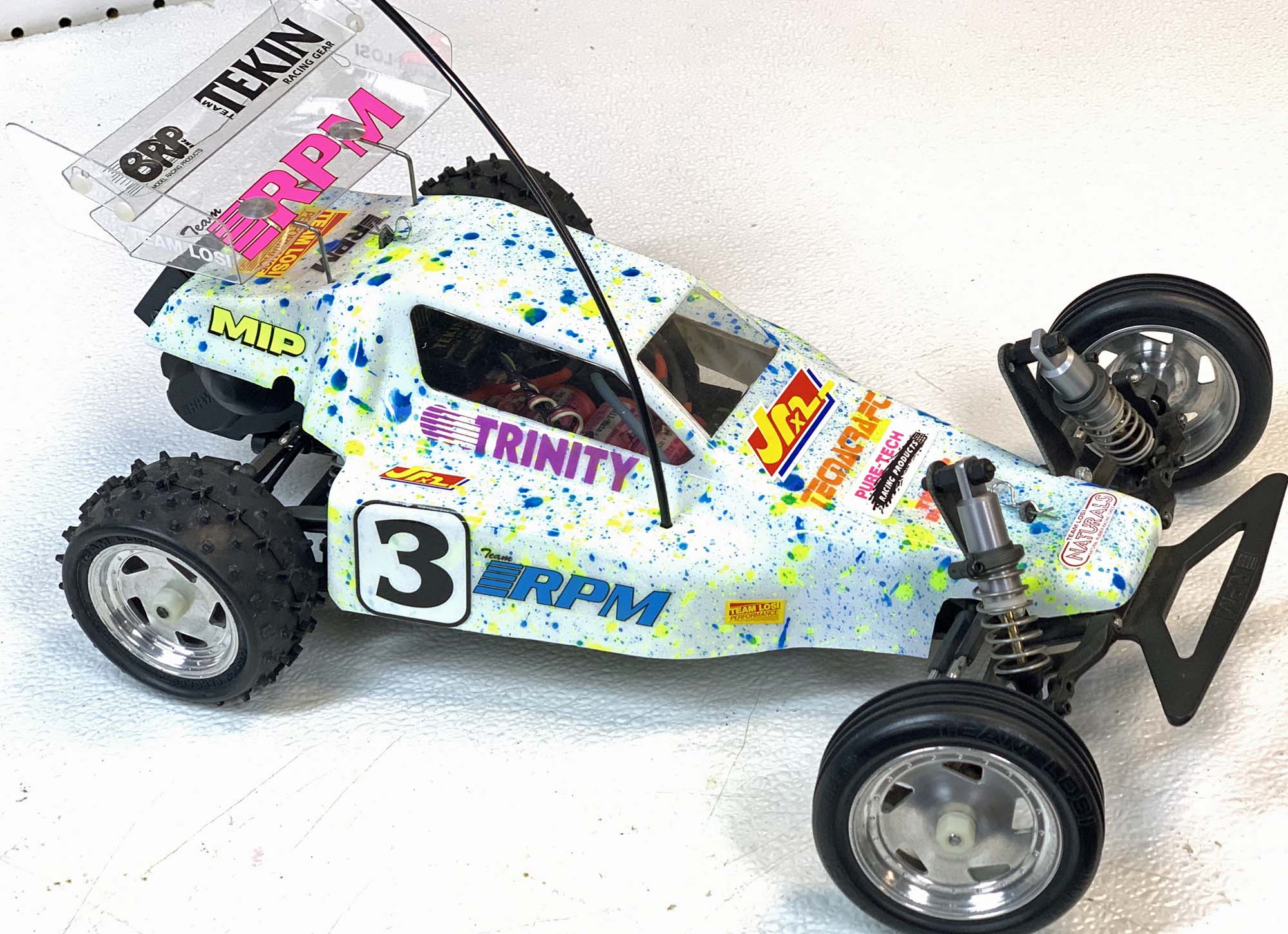

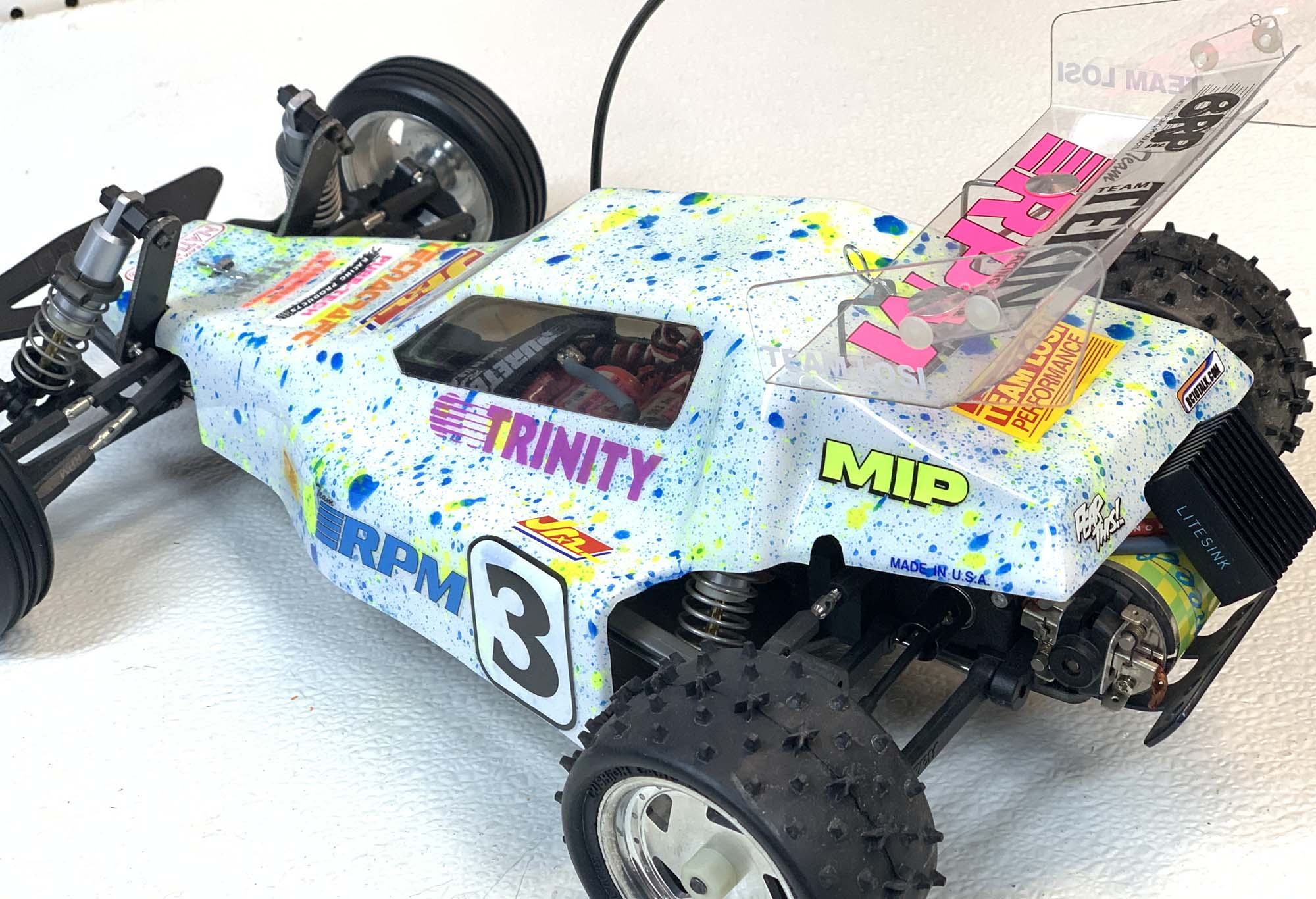

Finally Got around to painting and stickering the body and chassis. Fluorescent spatter backed in white, lots of old school stickers. I think it is finally done, only took a dozen or so years.

Fantastic! I've always loved this buggy.

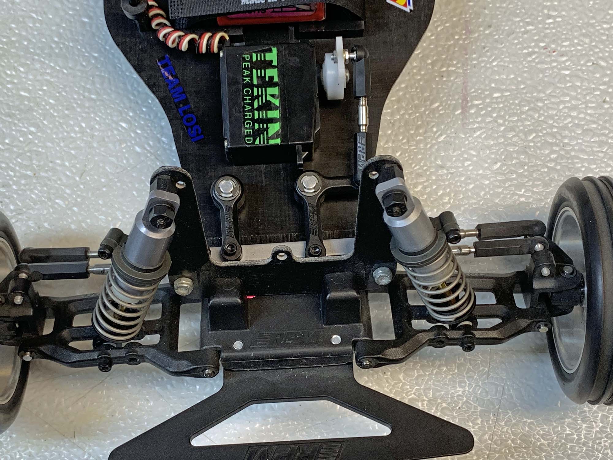

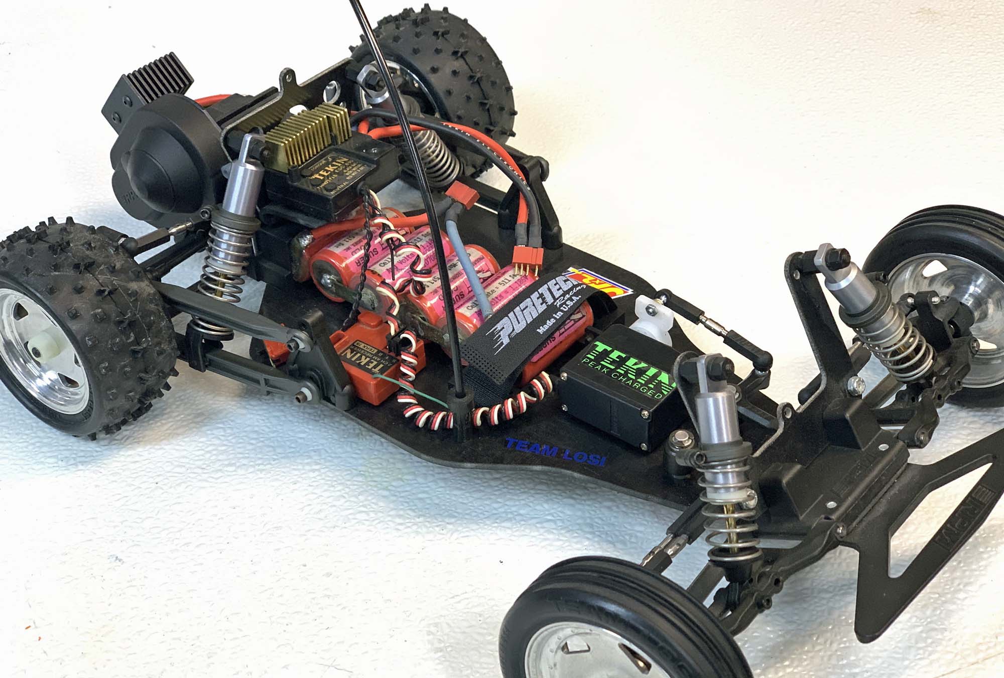

Wow! I read back through your whole thread and discovered some RPM parts that I never knew existed! What shock cartridges are these? Great looking build!

Lovin' those wheels!

The shock carts are by SRS, they are machined delrin and use the rebuild kits from the old school bottom load rc10 gold shocks. I actually load them with a combo of modern ae spacers, and traxxas rebuild kits which include the retaining clip and washer as these are easier to come by than the vintage rc10 packages.

Love the body , whole car looks very cool !
