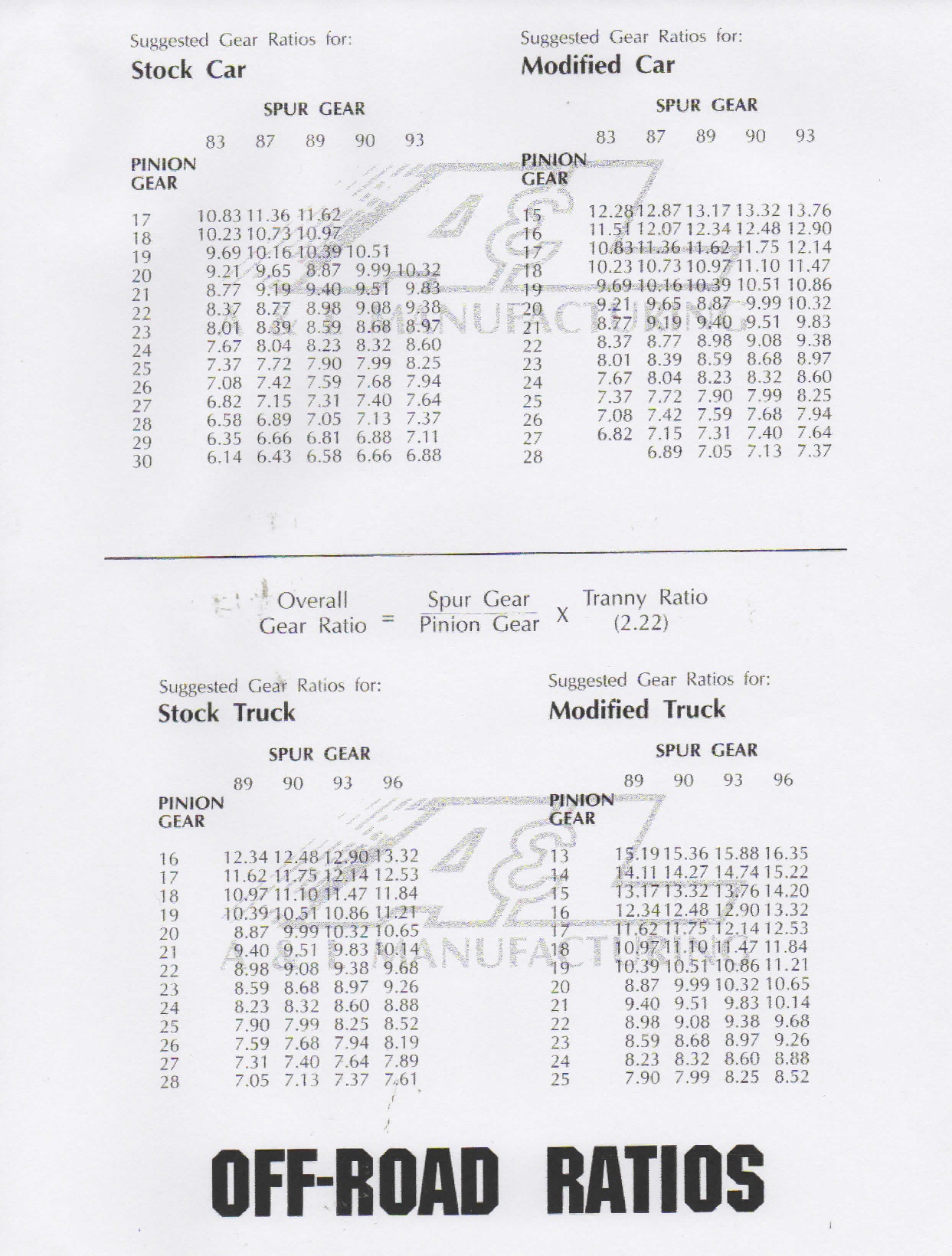

If you haven't seen this, it may help with ratio choices. The spur on the LW is usually larger than what you would run on a stealth to help with the distance between the gears

I'd pick up a larger 48p spur (maybe a pinion or two) and run the 20T pinion. Shouldn't be too hard to find an 87T spur. I don't the tranny so I can't talk to it limiting motor pinion fit to the spur. That pinion/spur would work find in a brushless system too. I run a much smaller pinion in my brushless SC10 than is recommended... which is fine for me cause it's still pretty damn fast.
